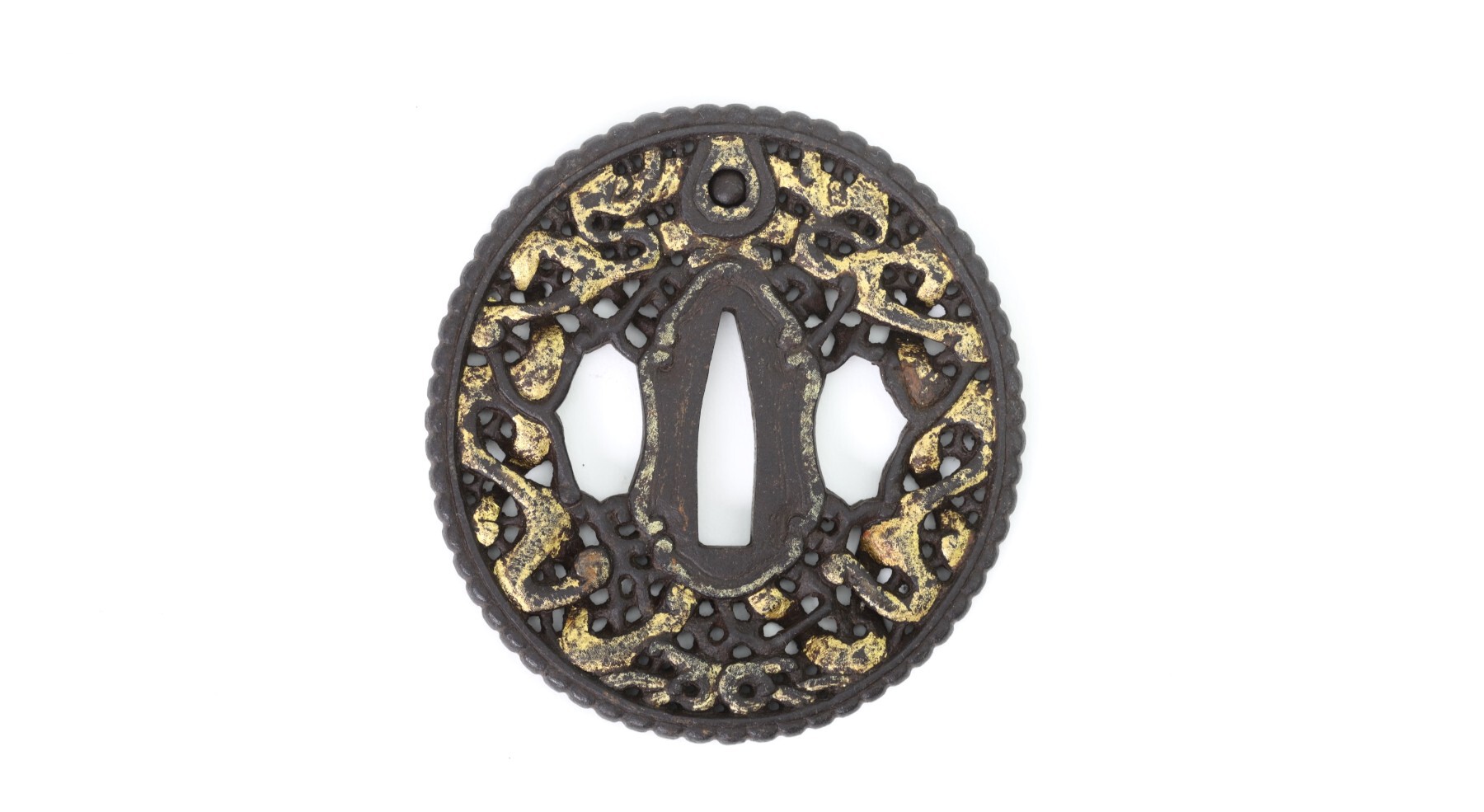

Ok. Let's treat just one Chinese-made group I think I have identified:
"...there was a third type derived from, or mixed with, Chinese influences. During the whole period of Portuguese and Dutch intercourse with Japan, the Chinese carried on a more or less uninterrupted trade with Kiushu ports, and, side by side with the purely Chinese· influence thus exerted, mixtures of European and Chinese styles, probably originating in Canton, are commonly found. Sword-guards of this class are generally termed Canton tsuba or Kagonami tsuba, presumably because this style originated in the city of Hanis, or was imported thence by the Celestial traders."
-C.R. Boxer; European influence on Japanese fittings
Canton was one of the main Asian cities of both production and trade. Anything could be made there if there was a market for it, and in Japan, a market for foreign-inspired tsuba existed. There is a group of such tsuba that combine a number of features that bring it home to Canton, from where most Chinese trade ships headed to Japan left.
Undercutting: Undercut ironwork was produced in Beijing, Derge, and probably some other production centers. Canton was probably the most famous for its work in undercutting in various materials. The pinnacle of this art were the devil's work balls made of ivory. Many of the Canton tsuba feature balls or other elements that are completely cut loose from their surroundings.
"Lazy" openwork through a multitude of drilled holes. Tsuba from the Canton group often are perforated with a large number of round holes. On the better work, each hole is filed out so that it is not obviously drilled anymore, but when mass production caught on in probably the 18th century, workers started to cut corners. This "lazy openwork" is very non-Japanese and is seen in all mediums in Southern China, including ivory, wood, and brass sword mounts for the local market.
Lastly, surrounding the tang opening are often cloud or lingzhi forms that you also see on Cantonese sword mounts for the local market. Among Chinese swords, its a feature only seen among a group of them that often have Cantonese provenance so it really was a staple of that area.
Here is an example of such work, combining these features. Even the application of the gold, over a two-directional crosshatched background, is typically Chinese. On Japanese work, generally three directions were used.
The attribution of this tsuba from Japanese mass-produced item to Chinese mass-produced item for the Japanese market has no notable impact on the perceived value. Chinese collectors are not interested in goods made for export to Japan.

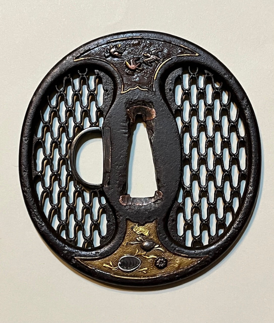

Iron with lacquer, gold, silver, brass and copper zogan. One hitsu ana surrounded in silver.
What thoughts does this tsuba trigger?
Three birds and three sea creatures on obverse, two birds and two sea creatures on reverse.
(Two friends said they felt influence from Kyushu, possibly Nagasaki... from shape of the netted sidepods?)
  • Love 2
