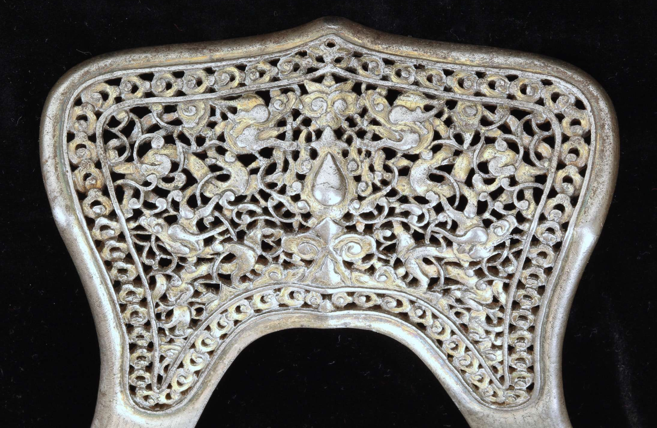

Here's a late Ming period (1500s-1600s), decorative horse saddle side plate:
more info on it here: https://mandarinmansion.com/item/tibetan-style-pierced-saddle-plate

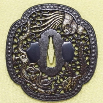

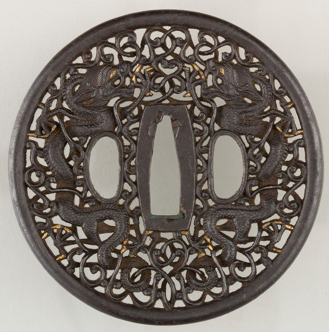

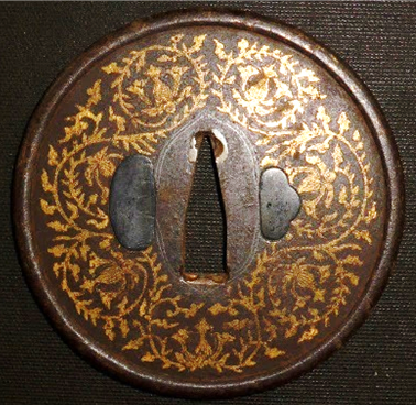

Bruno, that's a nice example of a Kiyou Toujin tsuba (is it yours?)
Dale, definitely from the same school. They did a lot of "phoenix" and dragon combinations

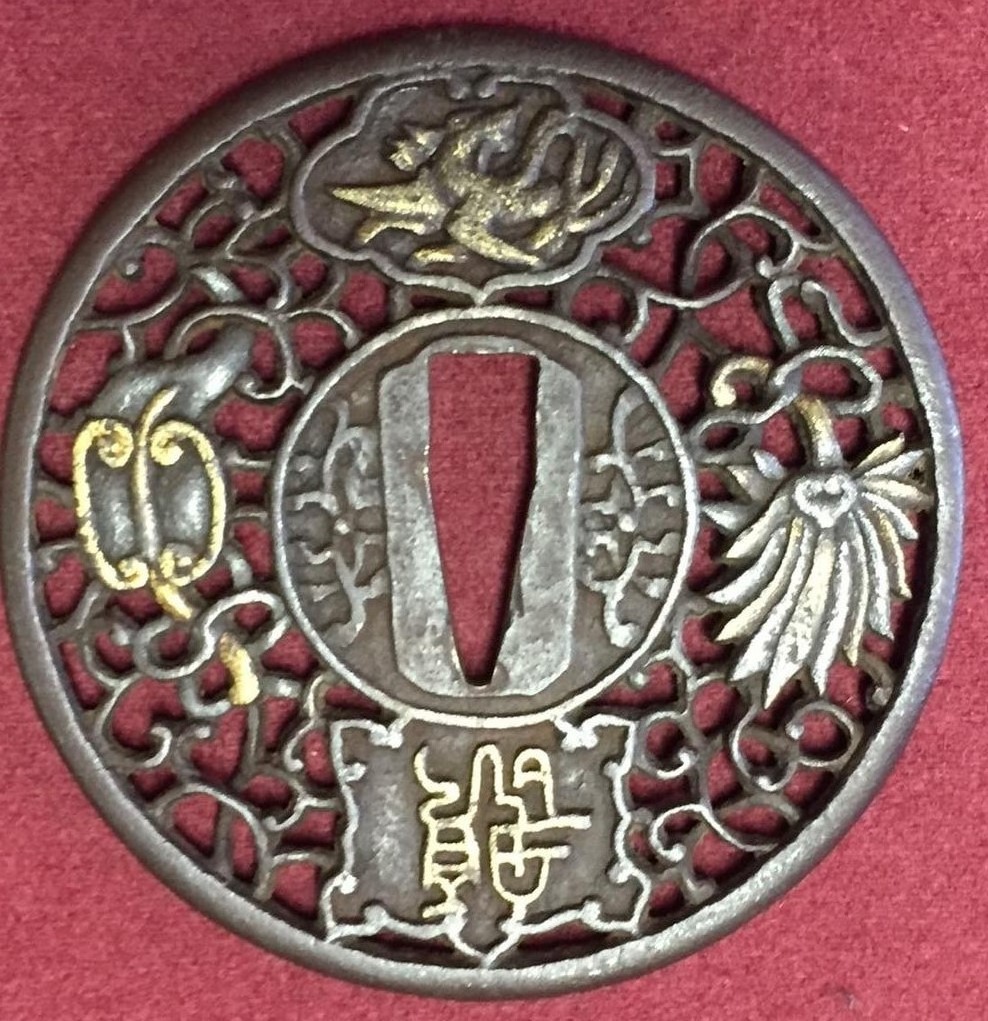

Another nice one Bruno,
Looks more like an Edo period piece because of the tsuba's shape, the heavy thickness, and the pretty good condition of the nunome.
However, the tsuba has been around long enough to have been mounted at least twice (there's a "double sekigane" at the top of the nakago-ana).
It's definitely made for the Japanese market and likely made in Japan (I would assume somewhere in the Hizen area):
The hitsu-ana appear to be original to the tsuba, or at least they were present before the application of the nunome.
The nunome design also properly contours the hitsu-ana, rather than being cut through by a "later modified nakago-ana".
I can't tell what the arcing design motifs are in the four corners on the ura side...
Any idea what they might be Bruno?

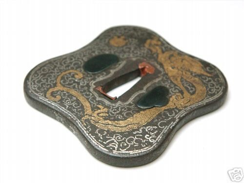

Does anyone have any other examples of this style of Nanban tsuba?
I can say with certainty that these were made in Japan for the Japanese market, but I have no idea by whom or where specifically.
Both appear to be unaltered (other than maybe the width of the nakago-ana, and the addition of sekigane on the second one)
They must be from the same "school" and probably even the same smith, but that's all I have found so far of this type...
I'm wondering if there even was a whole "school" of smiths producing this style, or if the smith was an "independent" Edo period smith.

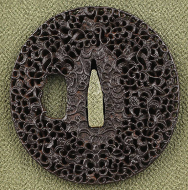

Thanks for posting that Dale,
Mandarinmansion is a fantastic resource for Nanban related content and information.:thumbsup:
I have never seen another set of Kozuka and Kogai like those before.
Both are carved from a single piece of steel too, which seems to be genuinely "unique" (or at least extremely rare) for the kozuka, which typically "always" have a separate kogatana blade inserted into the kozuka handle.
1 hour ago, Spartancrest said:
Now where were these made?
The tsuba on the left:
Japanese features: Japanese style twin dragon motif; an ovoid Japanese seppa-dai; and purposeful hitsu-ana outlined by the dragon claw and cloud; also mokko shapes are not very common among the nanban tsuba and is generally a more common shape among Japanese tsuba.
Chinese features: has only 2 directional cross hatching for the nunome; the piercings are mostly just drilled through holes with very little shaping and no undercutting to make a more 3D web.
The combination of these seemingly contradictory features suggest a Chinese smith living and working in Japan, like in the "Chinatown" area of Nagasaki, producing tsuba for the Japanese market.
I noticed the website's caption under the image also stated "Nagasaki" as the probably location :)
The tsuba on the right:
100% Chinese: 2 way cross-hatching, Chinese style dragons; stylized Chinese Song-shan mountain motif below the seppa-dai; Chinese seppa-dai; no hitsu-ana; tsuba is bordered around the outside by a circle of lotus petals; the squared-round shape of the tsuba; the piercings are a bit rough and not meticulously undercut.
Kogai & Kozuka set:
It has more in keeping with the dragon style and production cues of the tsuba on the left, so Nagasaki area makes the most sense for these as well.

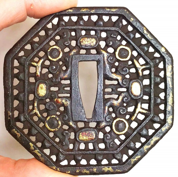

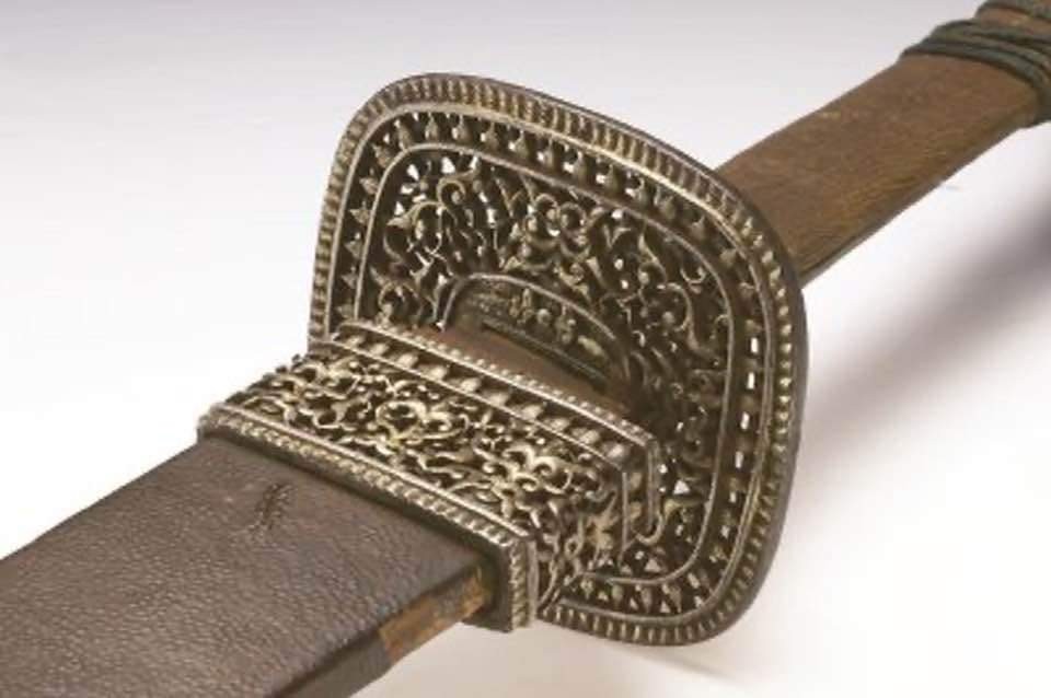

Spotted a few great examples of unaltered nanban:
These ones were all described as Chinese Hushou (tsuba), dated from the Qing Dynasty 1650-1700:
275476715_chinesenanbanunalteredQingperiod1650-1700.thumb.jpg.9e4d62e81f545c56af086c6619335906.jpg404360118_chinesenanbanunalteredQingperiod1650-17002.jpg.5b82b6ab9e0565f6c5776378212084a1.jpg
1103830011_chinesenanbanunalteredQingHushou.thumb.jpg.19a000c8e5e6d619b12481c61780172d.jpg383732726_chinesenanbanunaltered.thumb.jpg.d09d7fb79e846a6ad5d1970ab0eeb3dd.jpg
Not sure of the date on these ones, but they are also made outside Japan, somewhere on the continent (not just China)
Note the first one has purposeful, original hitsu-ana, so it was likely made for export to Japan:
1017929-2b.thumb.jpg.fa7825a4d35ee2aa68764c6e4b761200.jpg1241418082_Nanbanadefd36.thumb.jpg.99d6c14630c447086b9deb1cf18b1b45.jpg1006749-2-medium.thumb.jpg.656be69e99ce4c202b1d9fb39f1a7240.jpg
These ones are definitely Japanese, also with purposeful hitsu-ana (mid to late Edo, post-1750 :
973380500_main-image(4).thumb.jpg.a433554467a07b8e323737d4ff0943e5.jpg1535810035_s-l1600(20).thumb.jpg.5c0f3eadde70ee8cf43ac7c4b259ee1d.jpg

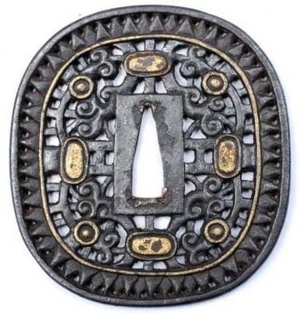

Hi Kiril,
The Chinese attributions for the first four images were done by dedicated collectors of Chinese weapons and fittings, who also commented (with some noticeable "judgement", that these were wrongly described as Japanese nanban tsuba, as it was their opinion that these were clearly Chinese made).
I would agree with you that the first three eventually ended up in Japan because of the modified nakago-ana that come to a "V" point.
However the fourth one looks completely unmodified, made in China for a Chinese blade that was slung from the hip with the cutting edge down, and never modified to fit a katana:
I would also point out two disctinctly Chinese (or more broadly "Sino-Tibetan" features:
1- The outer rim design with two parallel boarder rings, containing a ring of lotus petals. So far, I have only seen modifications of this outer rim decoration on known Japanese tsuba, and they never have the lotus petals specifically, always something "more Japanese" in its styling.
2- The tapered rectangular box seppa-dai.
Furthermore, the lack of hitsu-ana on these four tsuba, produced at a time when hitsu-ana of some type were on nearly every Japanese tsuba, also points to the notion that these tsuba were never intended to go to Japan (even though three of them got there eventually).
I'm going to quote McElhinney from "Asian Export sword guards and Nanban tsuba" on Facebook, because I agree wholeheartedly with the sentiment:
"If a guard looks Chinese in every way, and it cannot be proved to be Japanese, then we must assume that it is Chinese."
The middle set of three images certainly could have been made in Japan, but I can can't yet say for certain (either way).
My suggestion of a continental origin stems from the distinctly non-Japanese style dragons on two of the tsuba, which are more South-East Asian.
And, the one with the large circle around the seppa-dai, is a feature that is more commonly found in southern Chinese, Vietnamese, or possibly Korean guards, although the inner tapered rectangular seppa-dai (within the circle) is more Chinese or possibly Vietnamese.

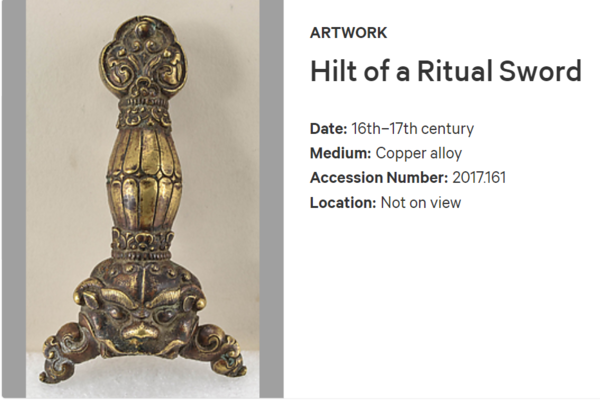

By the way, I did a bit of digging myself and found these Tibetan comparisons at the Met Museum...
Here's a decorative horse saddle plate from Tibet that is in the Met Museum, and it has the same dragons that are on some of the tsuba I posted as being continental (although I should have stated "most likely" or "probably" because I can't be 100% certain... I let my own brain turn it into a statement rather than a likelihood):
1017929-2b.jpg.c511f162d48dc198babfc1ac1d64041f.thumb.jpg.574d9c9f118dbc7f0bf597e643d47973.jpg1006749-2-medium.jpg.1446603aff13114883a41a64cd1823f9.thumb.jpg.90644e3103817245a1cf3a36a38c512e.jpg
And, the mask that is on the guard on the left looks a lot like these earlier 15th-17th Century Tibetan mask-shaped sword guards in Met Museum:
So everything about these is saying Tibetan (every aspect of the motifs, the seppa-dai shapes, the sukashi is drilled or simply carved with no undercutting, the nunome on the 2nd one is done with Chinese-style cross-hatching), so it makes it far more likely that these were one of the following:

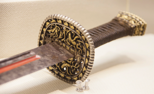

Also, here's an example of one of those rounded-square nanban tsuba mounted on a sword in the Ningbo Museum in China.
Dated to the Kangxi era (1661-1722).
Main difference: the seppa-dai on this one looks more like a flattened round, rather than the tapered rectangle.
448324789_chinesenanbanunalteredKangxiera-Ningbomuseum.thumb.jpg.d8aae530caff3d019203e37a34c315ae.jpg

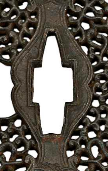

On 8/22/2022 at 2:35 AM, Rivkin said:
Here is a great example of a guard where the hole's shape is just part of imitation rather than functionality. Kara mono and Namban mono were powerful fashions in Japan.
I agree that the square hole types are still very questionable as to both their origin and their usage.
I think the various permutations of the nakago-ana shapes of this particular style of nanban guard was already illustrated in the "square hole namban" thread, but can be summed up as one of the following:
1- no square present (just a typical triangular nakago-ana... although they usually seem to curve and bow outward at the sides of the triangle)
image.png.66705c58441bb840bf22fbd2b2c25088.png image.png.decc359f32e39a8da153afcf1a95269d.png
2- a square that appears to be cut-in, going across the middle of the triangle
image.png.6ed9181ba2dd7597ad9ce7fce97fb782.png image.thumb.png.281bca90caddacab5b2d2bfbd4d690ae.png
3- both an original square and triangle that have an outlining border around them
image.png.f2d58c12d5db2a04eb76bc9dba1db126.png image.png.c7164689db9622c473b69676ee8f3d11.png
However, I don't think you can use these as an example to state that the rectangular nakago-ana on the Chinese-style guards that I posted earlier, are simply for show or a "fashionable" form of "imitation".
These square holes may or may not have been useless in their function, and one could possibly argue they were put there to evoke the "idea of European-ness". However these square holes did not need to be modified in order to the fit a Japanese blade shape to the guards they were on... they are simply "extra" features.
However the rectangular nakago-ana shapes in the Chinese-style guards required modification in order to be fitted to a Japanese blade (both elongation and widening of one end) that sometimes required nearly cutting almost to the outer edges of the seppa-dai.
So again, it just doesn't make sense for a Japanese smith to make a Chinese style nakago-ana that would not fit a Japanese blade to begin with.
Comparing these square ones on the "mask" style guards to the rounded-square shaped Chinese-style guards is simply a non-starter... they are so different that is like comparing "apples and rocks" so to speak.

The Hermitage in St. Petersburg has a sizeable collection of Chinese sabers with iron openwork mounts, mostly dating from the 17th century. The Palace Museum of Shenyang has the saber that belonged to Hong Taiji (1592-1642), and another large two-hander is in the Metropolitan Museum.
They all exhibit the exact style of guard that sometimes turns up in Japan. From the overall style, to workmanship, to the method of applying the gold (which slightly differed from Japanese overlay), they are identical. And yes, sometimes one gets lucky and finds one on Yahoo Japan. The Japanese obviously had quite a taste for them; why else produce so many local varieties inspired by them.
Studying these is quite difficult because Japanese artists were very good copiers. The field still requires a lot of pioneering and I may well be wrong on many attributions. But I have a reasoning behind each and every attribution I have made on my site. I encourage you to pick one out and try my methods. I'll follow up with why I think it is so.

Here is the saber of Hong Taiji (1592-1643) in the Shenyang Palace Museum:
