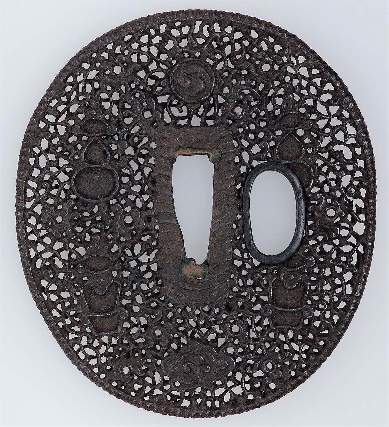

btw your third one with the very fine "tendrils" that arc over each other like branches in a bird's nest, reminds me of this style of nanban work, which is not very common at all. (This one is from the MFA museum in Boston)
(ttps://collections.mfa.org/objects/15216/tsuba-with-design-of-chrysanthemums-and-daisies?ctx=dde6abbf-785c-46bf-8962-3eaefa1b711c&idx=1)
Interestingly, this one is signed by a Chinese maker (very rare to see that), but unlike the one you posted, this one was made with the intent for sale in Japan because of the shape of the seppa-dai and the purposeful hitsu-ana.
It is also dated by the smith himself, to the late 1600s-early 1700s:

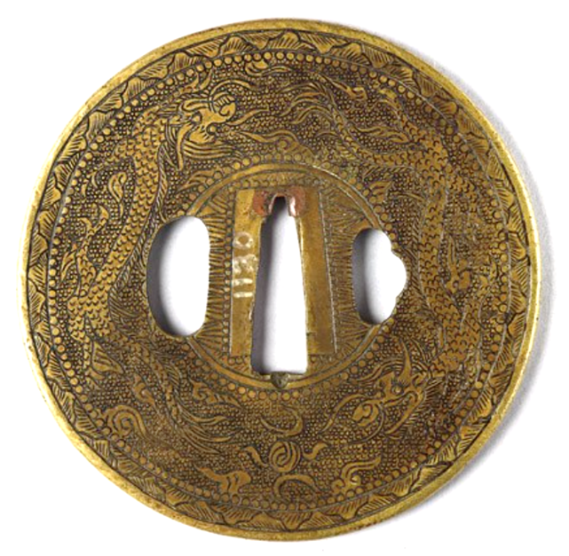

Here's one of my Japanese-made Nanban, with very finely, vertically chiseled tendrils (rather than rounded).
It's also made of non-magnetic soft-metal that has a slight greenish-khaki-grey colour.
It's the only tsuba I have that is even remotely close to this color. I suspect it's some form of shibuishi maybe?

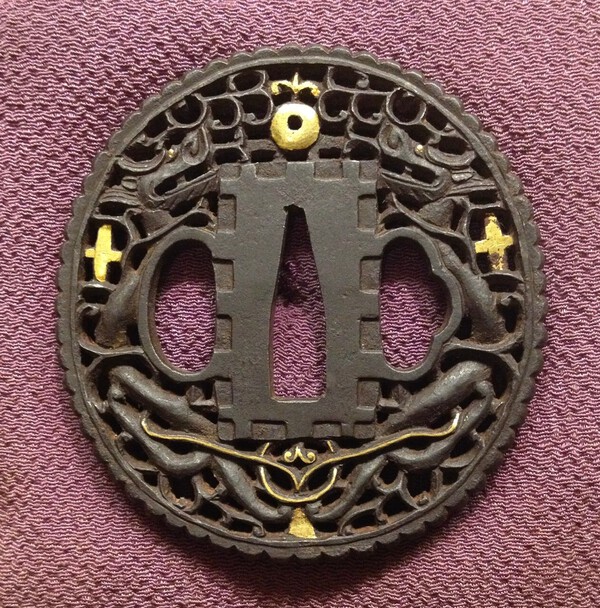

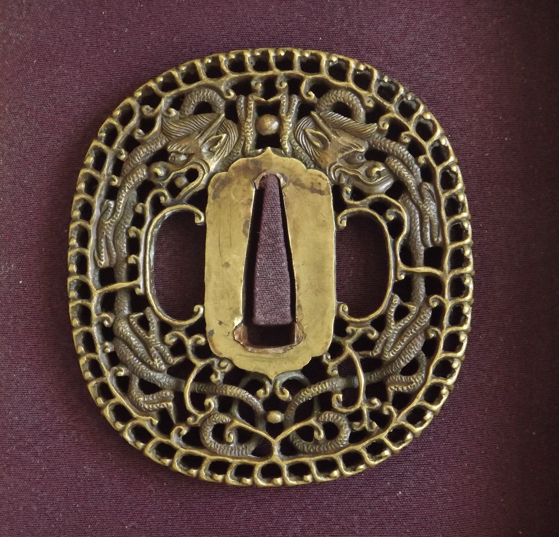

I came across two great examples of Chinese vs Japanese versions of that same double dragon themed tsuba I posted above.
The images were also detailed enough to catch a glimpse of the 2-directional Chinese nunome vs 3-directional Japanese nunome.
The 2-way pattern is definitely Chinese.
However, I don't know if the Chinese smiths ever adopted the three-way pattern outside of the Chinese smiths who ended up living and working in Japan. So I can't say with certainty that the presence of the three way pattern is an absolutely certain sign that the tsuba was made in Japan, although it'll still be a very "safe" assumption.
As with most tsuba, there gets to be this grey area of crossover in style and technique amongst different smiths in the same and/or different areas, and even in different time periods.
Often those "mysteries" are part of the fun... but sometimes they can be a frustrating nightmare, and you just have to accept that you might never be able to find a clear answer ;)
The result is that you'll always find examples that become a "toss-up" in terms of classifying and you just have to throw yours hands up :dunno:

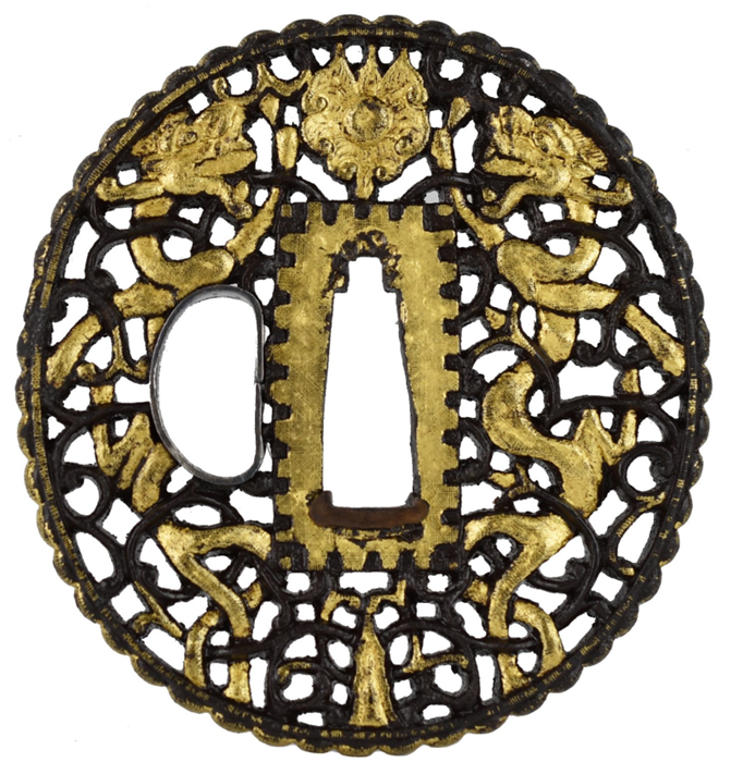

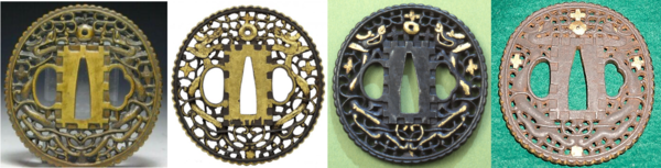

Chinese (again, note the cutout hitsu-ana and the added hitsu-ana ring):

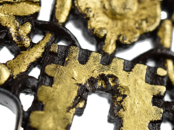

Japanese (original hitsu-ana):
Glen, the last tsuba you have just shown above has what you probably noticed, in that the two dragons face a Christian orb surmounted by a cross rather than a "jewel". With gilded crosses at just above three o'clock and also just above 9 o'clock. This seems to occur with tsuba having castellated nakago-ana area. Piers  pointed this out in a discussion early last year. Another point for Japanese manufacture ?
I think I got that right ?
Roger 2

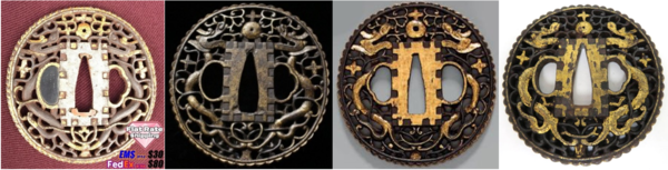

Roger, I think you and Piers are 100% correct.
Every one of the this style of of double dragon with the castellated seppa-dai (with the wider, more square rather than slotted indents) has the cross instead of the typical pearl.
I actually had to look up "castellated", so thanks for the new word :thumbsup:
here's just a few of the Japanese ones of this type:
The longer, more slotted indents only show up on the Chinese ones, which don't have the crosses, and have a lot more variation in their dragon head shapes.
It's probably the first post on Namban work where I actually agree with what is being stated. If I understand it correctly.
Yes, there are Chinese tsuba of the style, they tend to be distinctive, iron ones can be somewhat simplistic, soft metal can be quite nice. The shape, the rim has certain tendencies which should not be ignored.
99.9% of what comes out of Japan are Japanese Namban tsuba.
I think among Hizen tsuba there is a portion of Chinese ones.
There are also 16th-17th century continental tsuba made to look Japanese.
How would you attribute this one?
  • Confused 1

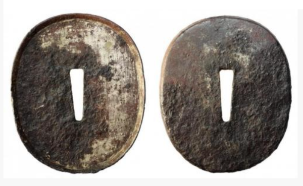

Kiril,
I have never seen anything quite like the one you posted, so i'm not too sure what to make of it.
It also looks like something that was dug up from an ancient burial mound somewhere...
Guess number 1:
It originated in Continental Asia because of the rectangular nakago-ana and slightly egg shaped profile, and it was never intended for use in Japan.

In terms of where in Asia:
I'm leaning more specifically towards a Vietnam because of the wide rectangular, tapered nagako-ana, but with a fairly large rounded seppa-dai area surrounding it.

Interestingly enough, the solid one was attributed as being a "DUTCH EXPORT GUARD made in GALLE SRI LANKA" (for the VOC), by James McElhinney
20DCBB6A-BCD5-4B1F-87FD-0E1727264BC3.thumb.jpeg.ff5399cac9d96ab92023ba99f368d952.jpegimage.thumb.png.962f67bbf8947203a3c827f70f9e190f.png
Piers, your number 2 guard looks like a Japanese made tsuba that is paying tribute/homage to the earlier Chinese guards that had gemstones inlayed into them.
I haven't seen another like it :thumbsup:

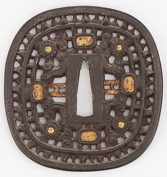

And your fourth one is nice example of that Japanese version of the castellated / crenellated seppa-dai tsuba.
I like how sharp the contrast is from the focused use of the gold nunome.

Here are two Edo period Korean guards which seem to have taken on a more typical Chinese "nanban style" influence.
(note that for the 2nd one: the thick gold overlay on the mimi and the expanded kogai-hitsu-ana were done later in Japan):
A side note observation: it's interesting that these two have a mimi with a "concavely dished" scallop pattern... which is very rare in nanban tsuba. The scallop-edged nanban mimi is usually made up of convex rounds.
image.png.0dcfa016bf677c377a6d406b724f7295.pngimage.png.a0340424f019bc4051e7f021c93c3a16.png

That one is from a body of dugouts of quite a few Japanese-styled tsubas, late 16th to 17th century, which are found everywhere between North Korea, about 500km further north and to the east they are found as far away as Kurils and Sakhalin.
For some reason while katana styled swords never gained particular traction there, hirazukuri wakizashi did, and were carried in huge quantities some as late as the 19th century. The nakago is continental (narrow, uniform width) but the fittings always tend to be Japanese styled. Quite a few have really narrow ana which are obviously useless on a waki which never had kozuka in the first place.
I suspect they might be of continental origin. They are not too common, but among the collectors of such stuff they are quite popular. Also they often do not match very well the blades with which they are dug out, so must have been made some distance away.
I don't put much stock into Sri-Lanka-VOC stuff, all these tsubas today are bought from Japan... Show us a Sri-Lankan dig.
I think this one is Chinese, reworked in Japan.
Regarding the photographs in the very beginning... Here is an early 17th century dugout find from the same region. Again, hirazukuri waki is the likely client.
