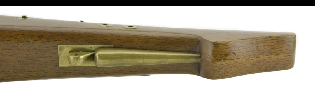

Is this yours Sabastian? Very good quality. Probably early to mid 1800s.
藤兵衛Tōbei is a famous 国友Kunitomo line of smiths.
(I am just starting to research in more detail your individual smith, and the stock maker. If anything comes up, watch this space!)
This smith has come up here perhaps twice before. Difficult to read name which I have to go back and work out again each time!!!
充Mitsu… (can also be read…)
江州国友藤兵衛充俶
Gō-Shū Kunitomo Tōbei Jūshuku (?)
He is listed as a child of the famous Kunitomo Ikkansai, which will give you an idea of his working life (around Bunka).
The stockmaker’s individual name is erased, but there is a 四居角左衛門 常政 listed as working in the Tempo years.
The bore looks to be around 1.8 cm, (?) which would make it a 10-Monmé 士筒Shizutsu or samurai gun, larger than the average footsoldier’s battlefield weapon. Just a guess at muzzle caliber from the photo.
The bore Caliber is approximately .73 at muzzle. Gun weighs 15 lbs. Barrel length 27 ½” do you think the mei may be 四居角左衛門?Shikyo? Kaku-Za-Emon?
Yes, that is the stockmaker’s family name. The name on the barrel is the gunsmith’s name. You say .73, so that must be … er… uh… 1.85 cm, so yes, 10 Monmé!!! A goodly size/weight of gun, not for the faint-hearted.
It was a cooperative manufacturing process between the barrel maker (the central figure) and the lock maker and butt/stock maker.
