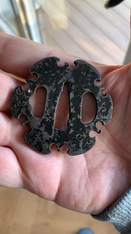

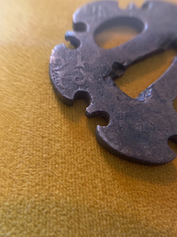

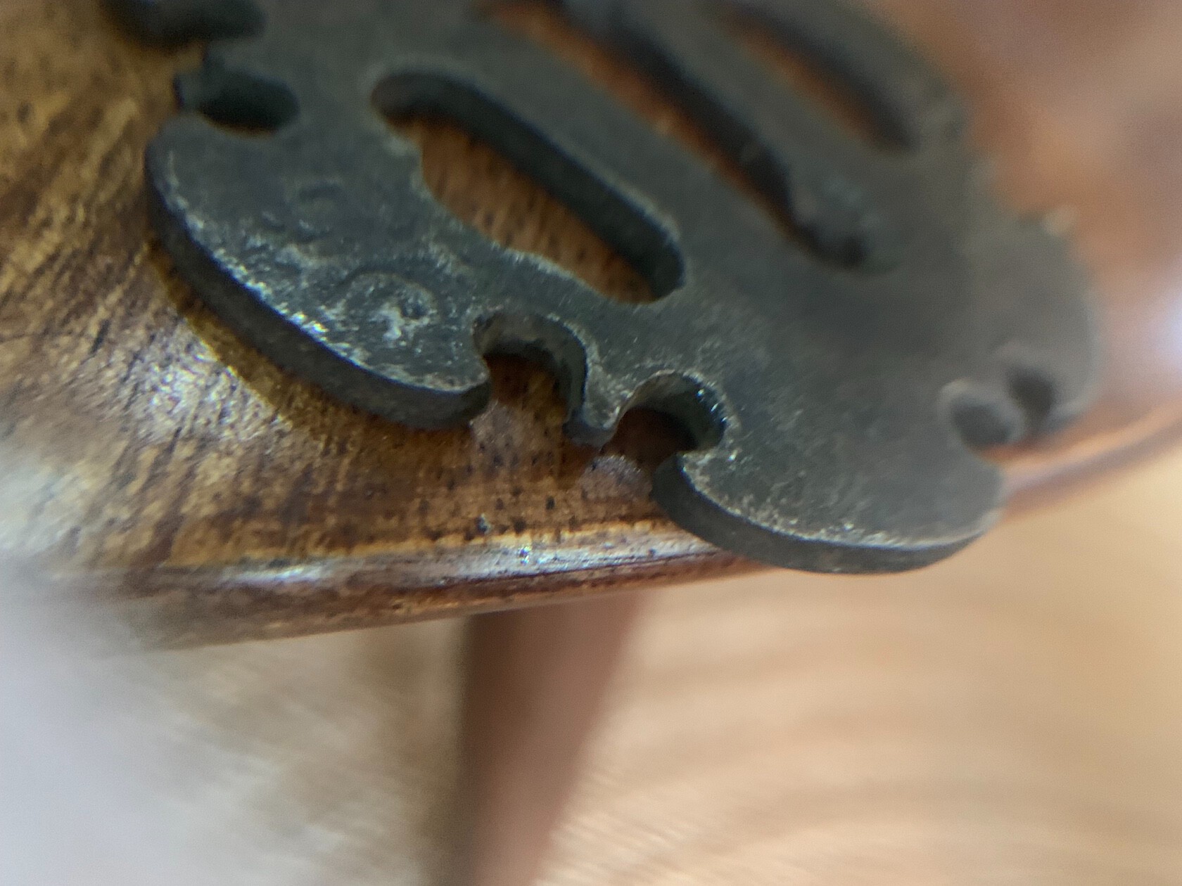

Unusual tanto tsuba
Okan

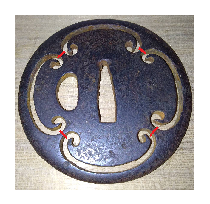

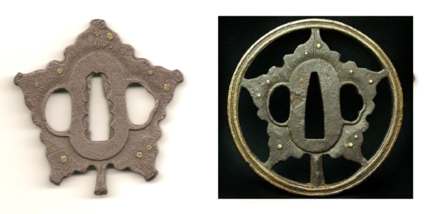

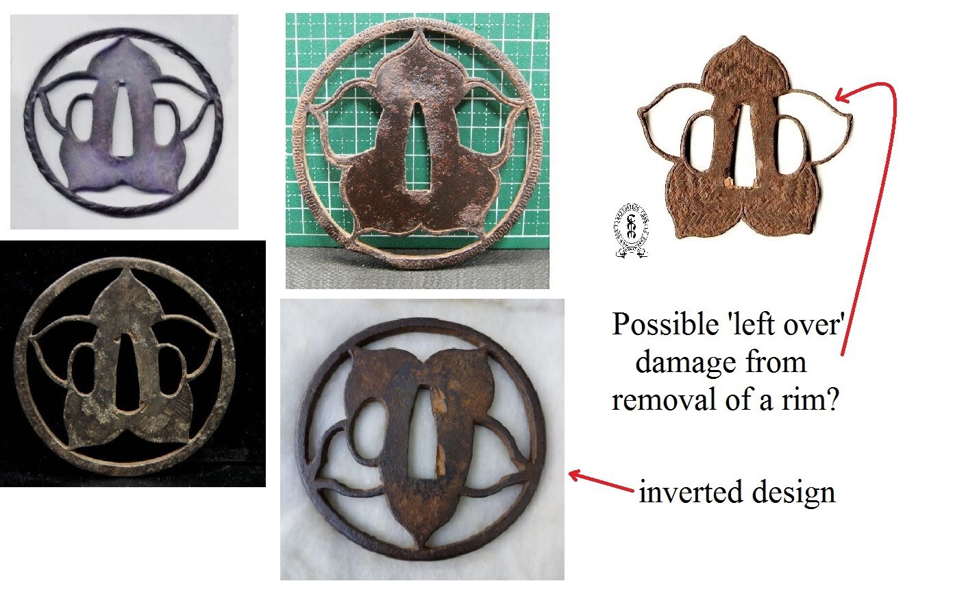

Sorry to disagree with most of the 'analysis' - it appears to be a cut down of a larger guard, likely with rim damage that was removed. There are several examples where this has been done. The cut down was done much further back in time than the 'recent' drill damage. The patchy patina is also pretty common from an over clean in the past.

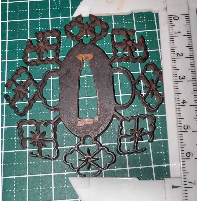

Okan, I think it is termed 'O-suriage' at least that is what a 'shortened blade' is called. They are more common than you may think - they must be because I have three at least myself, including this 'pair' - the central area of both tsuba are identical in size and the smaller one shows clear chisel marks at each separation. Not a true Daisho.

Sometimes you have to be very careful there is a fine line between re-shaped and trashed guards.
Like this one - https://www.jauce.com/auction/r1051664170 it says Tachi tsuba but in reality it was probably an O-seppa that has been broken and 'evened up'. [and not that well either!]
Or this obvious cast sukashi that is just the remains of the seppa-dai
This one is to be found in the Toledo Museum of Art from the Edward Drummond Libbey collection - obviously cut down from a very common form. [No colour image available] number 1912.720
it is amazing how the removal of two lines can change the look.    image.png.4b3dc40cf396d7bc0c9dda938c1c008e.png

new image

Okan, I forgot to ask if there is any 'niku'  [raised borders] on your guard? It looks like it in some areas but the images are not definitive. There is a lot of wear. I don't think it is a Mon design.
There are a few similarities to these Kamakura-bori guards but I couldn't say yours was from this period or style. [six inome around the seppa-dai]
https://varshavskycollection.com/collection/tsu-0345-2018/ and  https://tsuba.jyuluck-do.com/KamakuraTsuba.html
might be as close as I can find - both Kamakura 'style'. I think the guard would have been much better than it looks now.

I’ll take some better pics when i go back home. I came to Istanbul for vacation :) also, i can’t see the john voight pic! It just says image.png :)

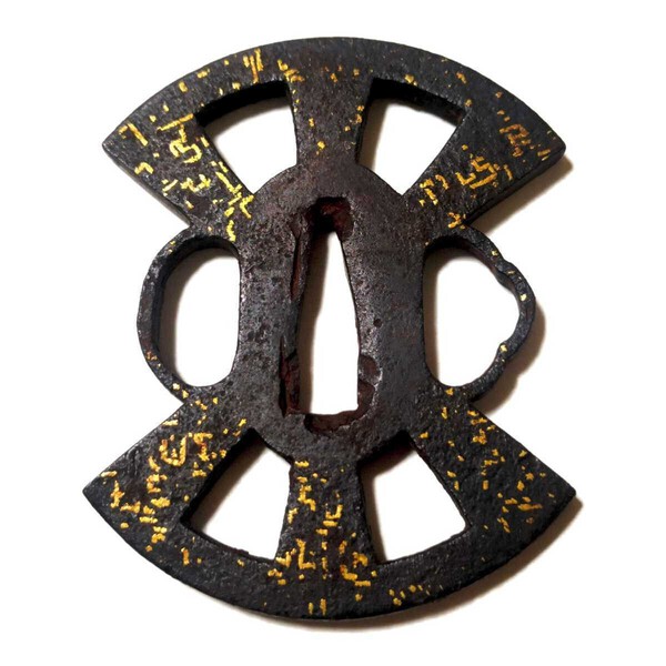

This guard is shaped very close to the original guard posted but it has not been cut down as far as I can tell - the inome outlines are as first made.
https://www.ebay.com.au/itm/403618712930   73mm in Diameter
The other images are possible cut downs but not much direct evidence so a big question mark remains.
Phoenix guard - ironic, second life as a sculpture. The 'full' guard from the Copenhagen museum is pretty close but not an exact match.

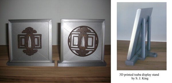

These are two more of my examples. For anyone interested in the tsuba display stands [which I highly recommend] you might like to give [Steves87] a PM. he can give you information on them as he prints them in a number of colours and styles.

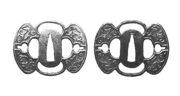

Sebastien, that is a great match up - saved me hours of searching :laughing:
What a shame the mimi is gone on that other one - looks like they went to a lot of work to remove it but not enough to keep the mon shapes intact.
Must be a great clothing catcher now!

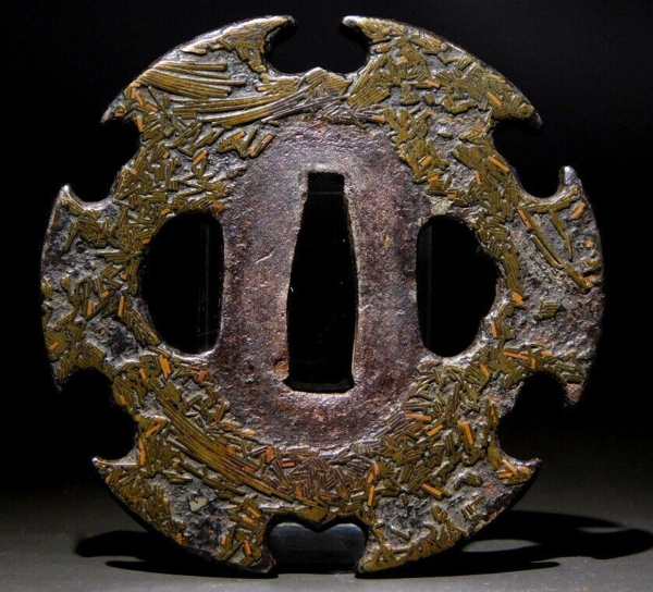

Okan, Uchikaeshi mimi  on that one. Looks Miochin/Myochin ?

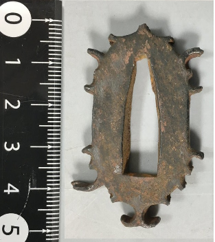

Looks like a lot of wear over a long long period. Some niku by the looks of it on the edges and some spots where it is worn away. Too difficult to tell where it was originally made - a piece worthy of further research.
You might like this altered example to add to the list.
