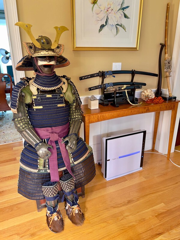

After many months of study, assisted in large part by members of this forum, I completed the acquisition of this yoroi set.  Many thanks to the wonderful John Masutatsu for advice refining the armor arrangement for display.
Suggestions and comments are welcome.  I'll post papers of the mento and kabuto below.

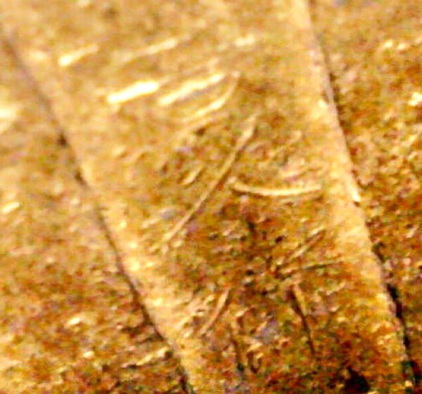

Since the kabuto lining is intact, I used an endoscope to take photos of the inside of the center segment of the hachi. I didn’t think much of the photos when I first reviewed them, thinking all I saw was scratches but no mei. But today I took a closer look and it seems like one of the photos, when rotated 180 degrees and enlarged, has “scratches” that match the mei on the kabuto appraisal (Yoshihisa)! See the attached. I feel like some kind of nerd Indiana Jones! 😂
What are the characters below Yoshihisa?  Thank you, Uwe, for inspiring me to take a closer look at the endoscope photos. And thank you, Jon M., for guiding me on where to look for a mei.

6 minutes ago, Bugyotsuji said:
Yes, upside down, but in the distance it does look like 吉久 and 作 (made by), but I do not see 正.
Is that character (which Google tells me means “positive” simply part of the appraiser’s level of confidence, but wouldn’t be part of the mei? I assumed the mei would read “made by Yoshihisa” but the appraiser added the “positive” character as a customary reflection of confidence. Then again, I have no Japanese language knowledge whatsoever so I could be way off here :)

7 hours ago, drl said:
I’m not sure why it is so much lighter than the underside of the surrounding plates—I suspect the metal used on the front center plate decoration (which looks almost like heat-blued gun metal) created a different oxidation potential for this area of iron, which caused it to patina differently over the centuries.
The interior of the Hachi appears to be lacquered black, the plates around the mei have been covered in gold leaf, this is a relatively common practice. Usually it is just a single plate, It would be worth checking the area for any other kanji.

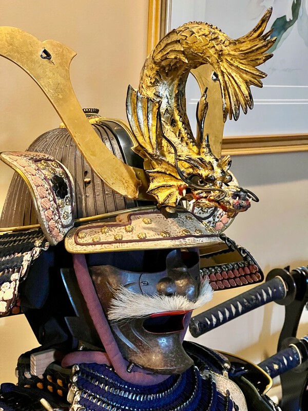

I agree with Piers, the shachi looks really good. Although I have no proof, I came to the conclusion that the circular gilded rings / disc maedate that are so common and turn up on so many armours (but without the kuwagata as on yours) were the default maedate, added by the maker or the armour dealer, simply to fill the gap so to speak. The ultimate wearer chosing a more distictive maedate of their own. If this idea is true, your addition of a shachi is exactly what a samurai would have done when he first acquired the armour. The fact that so many armours still have these simple maedate is probably related to the tendancy to remove all traces of kamon, including breaking off the fukigayeshi, that happened when armours were sold to curio dealers in the Meiji era. Removing a distinctive maedate would reduce the possibility of identifying the seller of an armour when so many had to sell their treasures to buy food during the Meiji period.
