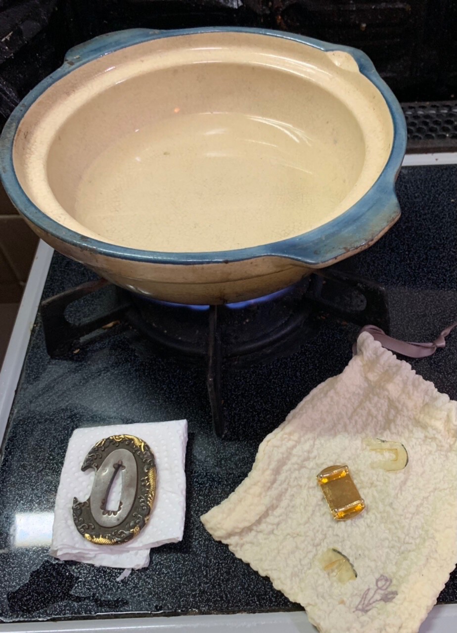

A friend gave me a bolo (loop) tie that he had made with a) a kenjō tsuba for a Tantō, b) a cheap metal fitment, and c) super glue. Although I appreciated his kindness, the thing filled me with inner horror. Finally today I contacted an artisan at Osafuné and asked for his advice.
“Place in a soft bag and boil in pure fresh water” he said.
It took about 20 minutes for the magic to work, but holding it in the boiling water with one set of chopsticks, and prodding and pushing with a further single chopstick caused the thing to shift and give way at last. The epoxy glue layer had become like a sheet of gelatin.

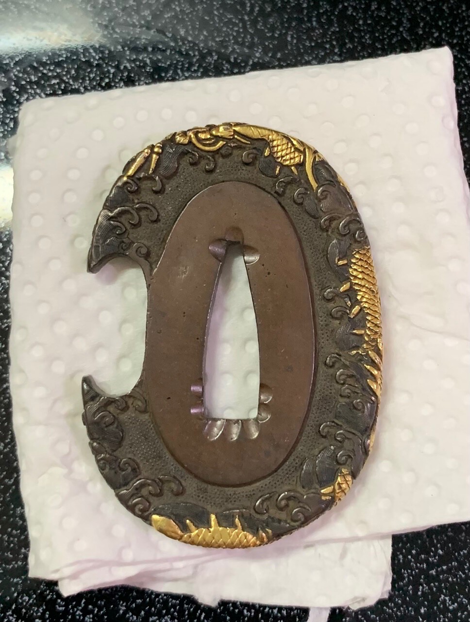

As you can see from the photo, the Tsuba itself is in fairly good condition after its two or three year ordeal.

From what I can see I think I would label your tsuba as Nagoya mono; the colour of the alloy, the nanako and the tagane marks around the nakago ana would support this.
I imagine that the soaking in hot water would have removed some of the accumulated dirt and the fact that it softened the adhesive is a trick worth remembering.
