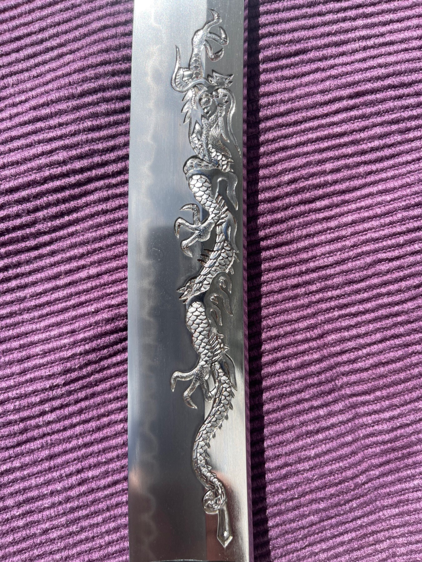

IJASWORDS Posted May 21, 2022 Report Share Posted May 21, 2022 The lovely sword with horimono posted by Colin H, triggered a thread that I have been meaning to kick off for a while. It is my personal opinion that a WW2 Gunto with a horimono is (again in my opinion) one of the "Holy Grails" of military sword collecting. I will start with a few of mine, all by the same swordsmith KANETOKI who then changed his name to KANEMICHI. These are all WW2 period blades, that show horimono, Bonji and Kanji. I would hope that others could contribute to this thread, as I think it would add to our knowledge of the art. 9 2 Quote Link to comment Share on other sites More sharing options...

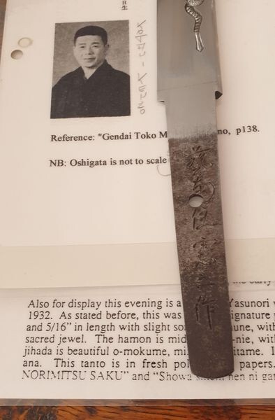

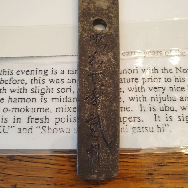

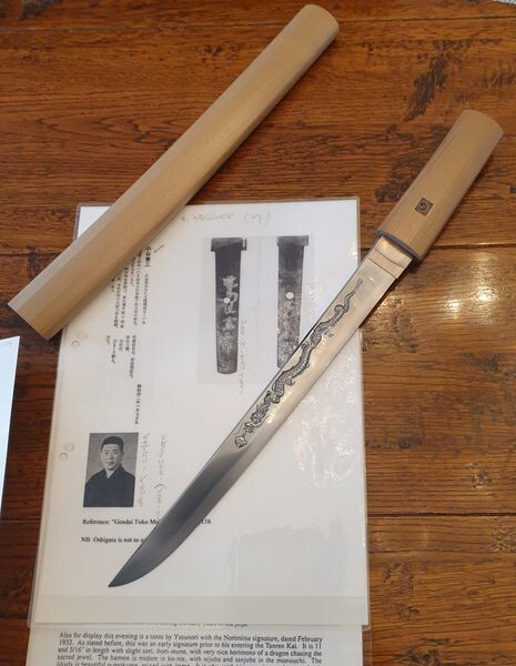

Volker62 Posted May 21, 2022 Report Share Posted May 21, 2022 papered rare long Tanto by Kotani Yasunori, signed " Geinan ju Kenzo Saku" Showa sichi nen Ni gatsu this crisp detailed Horimono's style of dragon the overall style of the Dragon shows a delightful Umetada flavor with its twisted tail chasing the pearl 9 2 Quote Link to comment Share on other sites More sharing options...

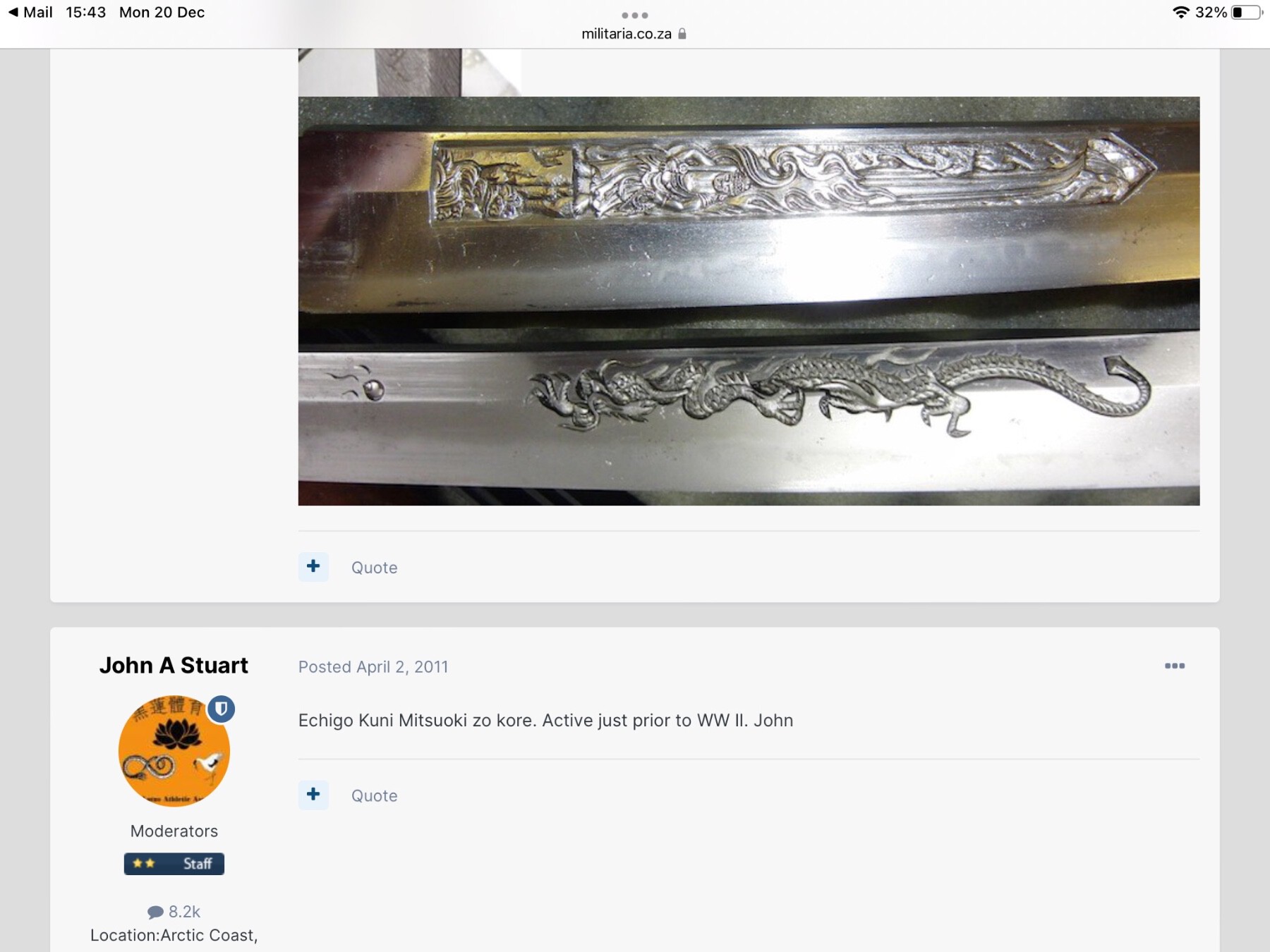

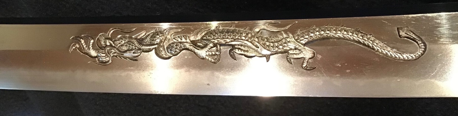

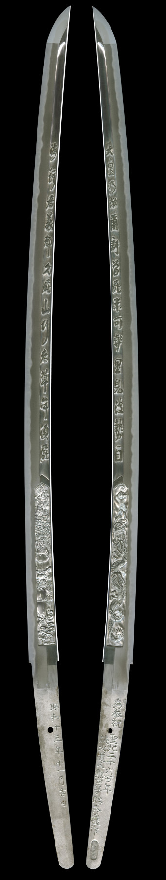

Matsunoki Posted May 21, 2022 Report Share Posted May 21, 2022 Added mine again for posterity!!! 6 2 Quote Link to comment Share on other sites More sharing options...

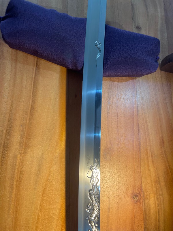

Michael 67 Posted May 30, 2022 Report Share Posted May 30, 2022 Seikōsai Ichimonji kore o tsukuru (晴光斎一文字造之) - Yasuki-hagane sanmai-kitae (安来鋼三枚鍛) 6 3 Quote Link to comment Share on other sites More sharing options...

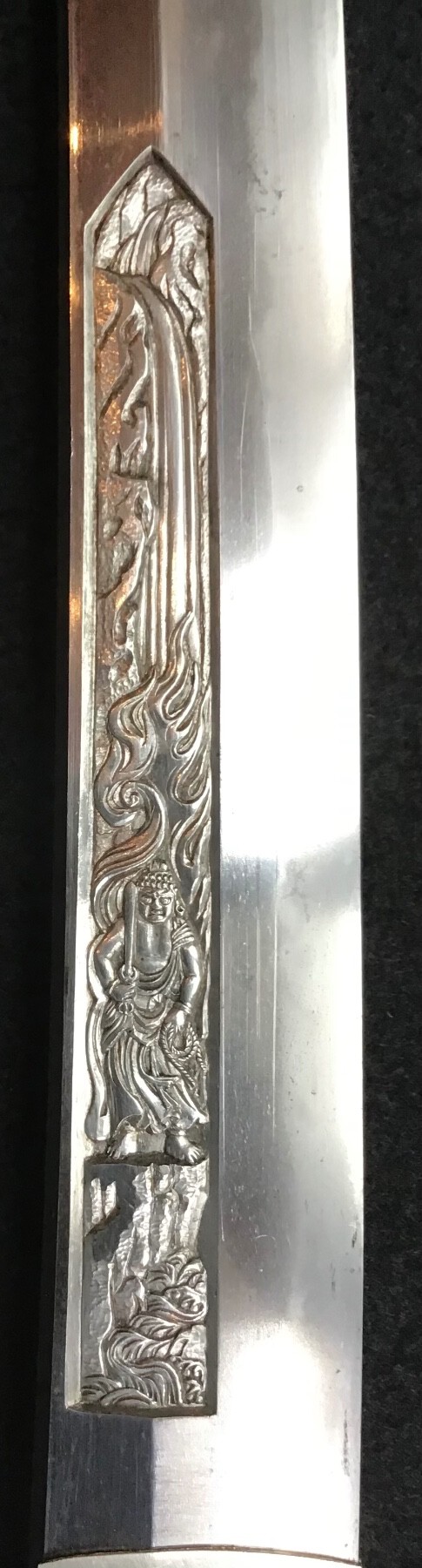

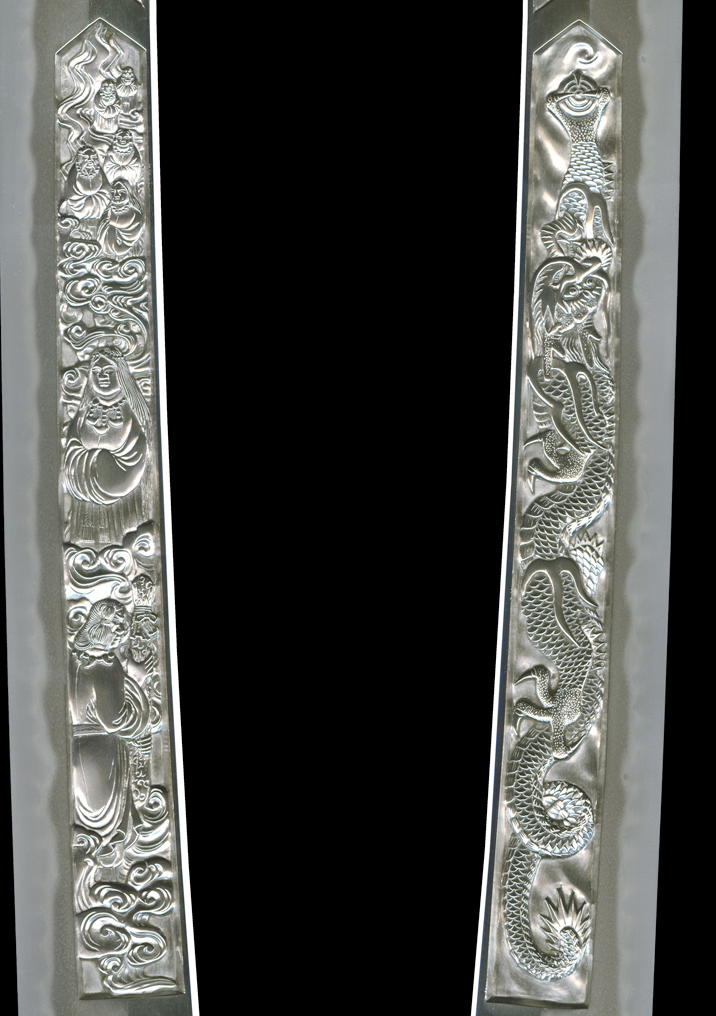

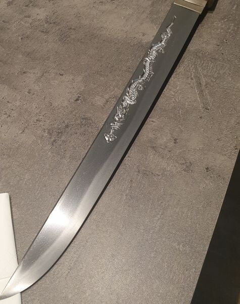

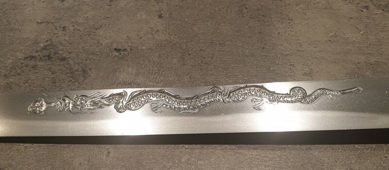

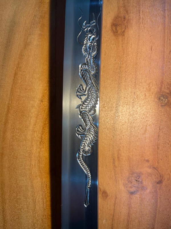

Michael 67 Posted June 1, 2022 Report Share Posted June 1, 2022 Kurihara Akihide, Horimono by Akitada 6 6 2 Quote Link to comment Share on other sites More sharing options...
Volker62 Posted June 1, 2022 Report Share Posted June 1, 2022 wow what a nice sword! what a nice crafted and signed Horimono, congrats! Quote Link to comment Share on other sites More sharing options...
Michael 67 Posted June 1, 2022 Report Share Posted June 1, 2022 Thanks Volker, it's my favorite sword. Quote Link to comment Share on other sites More sharing options...

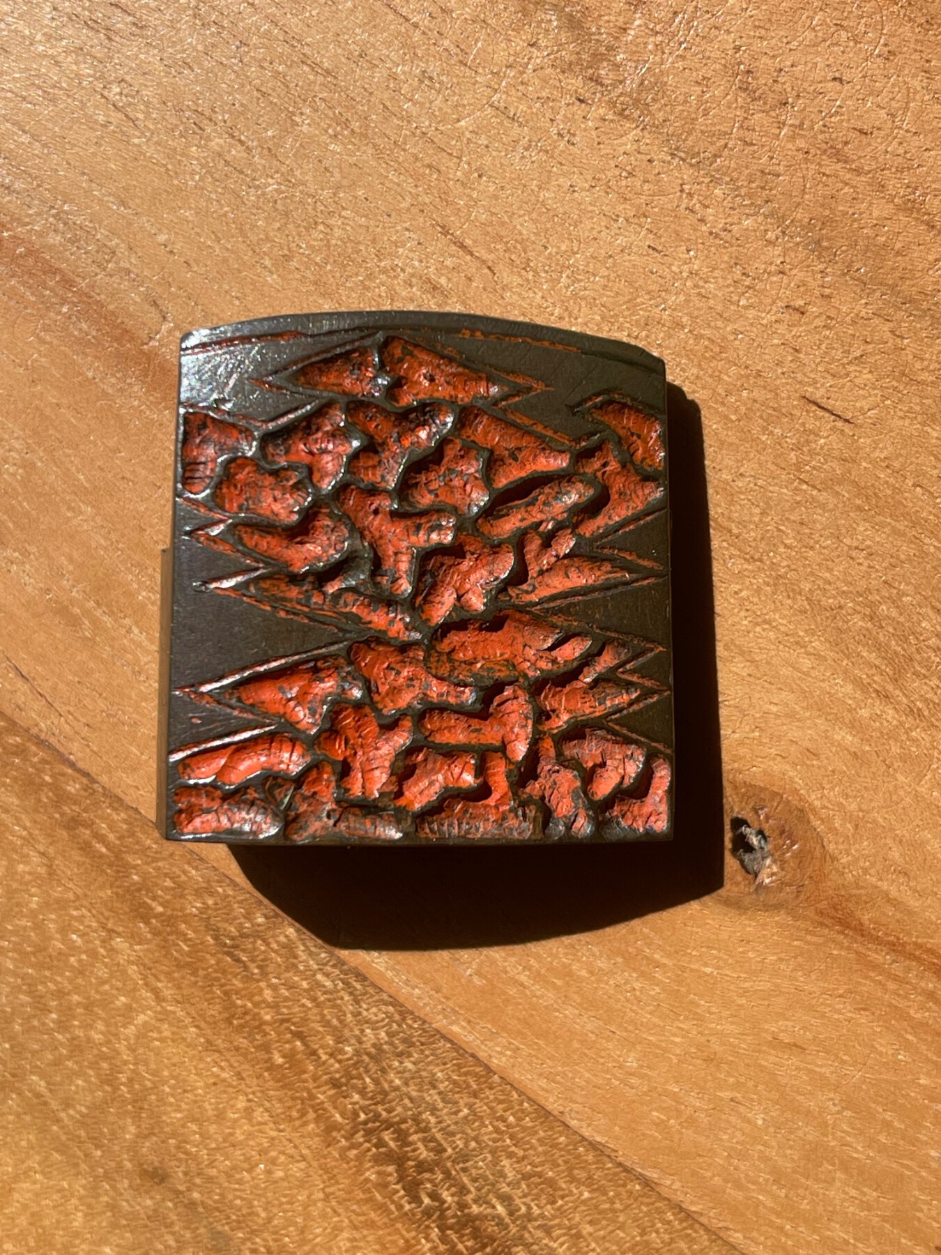

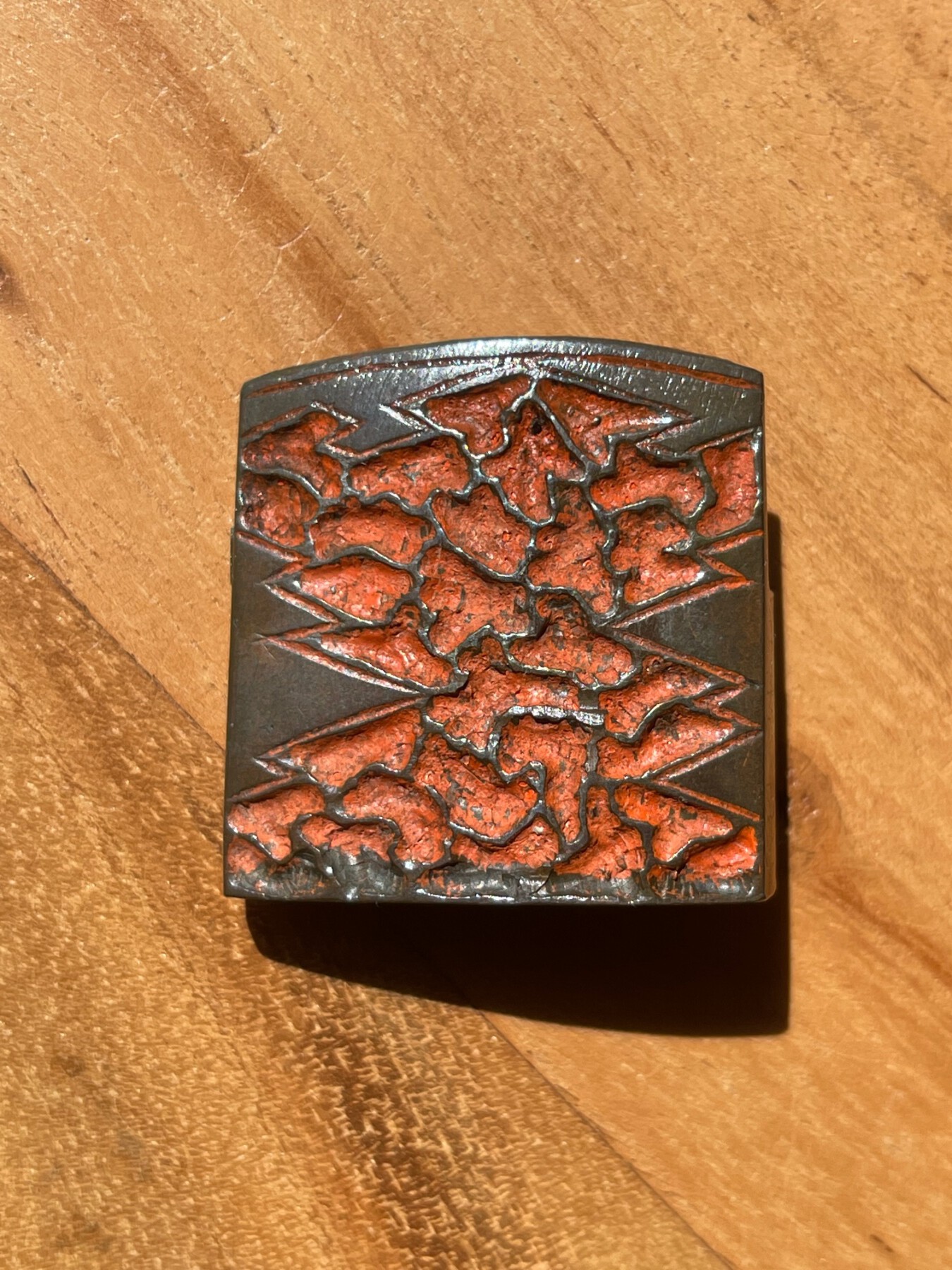

Bruce Pennington Posted June 2, 2022 Report Share Posted June 2, 2022 17 hours ago, Michael 67 said: favorite sword. Michael, Could I get a full shot of that habaki for the Habaki thread? Quote Link to comment Share on other sites More sharing options...
Michael 67 Posted June 2, 2022 Report Share Posted June 2, 2022 Hi Bruce, you are very welcome. 1 1 Quote Link to comment Share on other sites More sharing options...

mdiddy Posted December 7, 2022 Report Share Posted December 7, 2022 On 5/21/2022 at 3:57 AM, Matsunoki said: Added mine again for posterity!!! I recall seeing that Mitsuoki at a well-known Liverpool dealer's house once upon a time. One of the best gendaito I have ever held. 1 Quote Link to comment Share on other sites More sharing options...

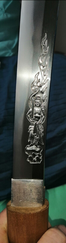

mdiddy Posted December 7, 2022 Report Share Posted December 7, 2022 Here is a tanto I had for awhile by Kasama Shigetsugu with a nice Fudo Myo-O 4 3 Quote Link to comment Share on other sites More sharing options...

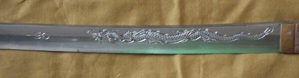

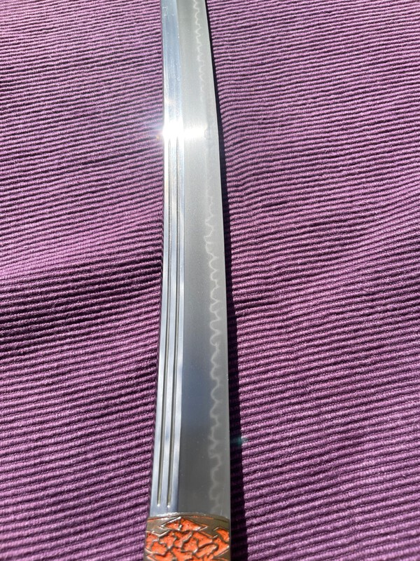

mdiddy Posted December 8, 2022 Report Share Posted December 8, 2022 Here is another one I dug up. A katana by Gassan Sadakazu in kyu gunto mounts with sankozuka-ken on one side (as well as bo-hi, goma-bashi + bo-hi on the other side, etc). 2 5 1 Quote Link to comment Share on other sites More sharing options...

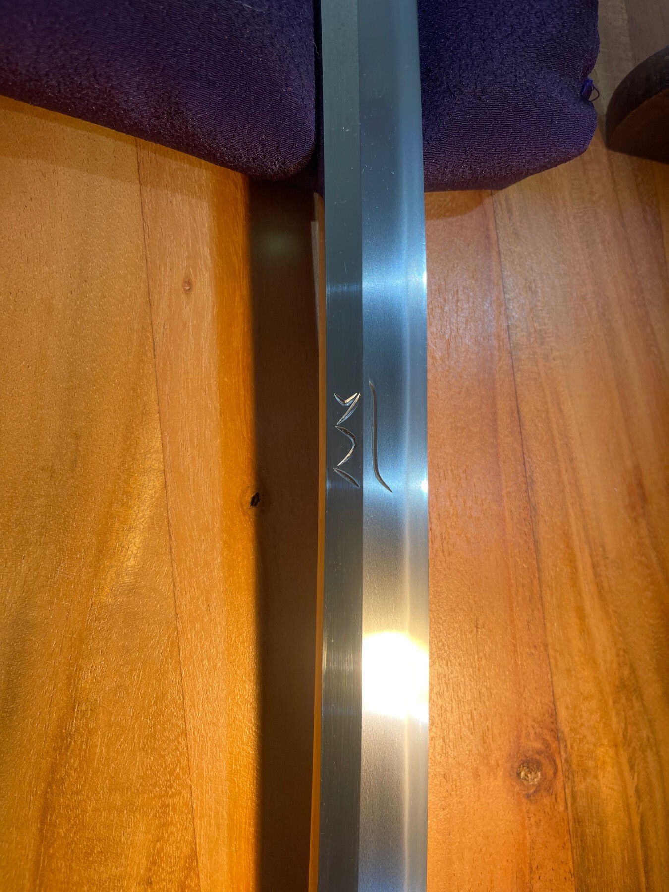

Bruno Posted August 31, 2023 Report Share Posted August 31, 2023 I would be interested to see examples of military stamped showato or star stamped gendaito with bohi. So far, the ones I saw were private orders non-stamped showato and gendaito. Thanks Quote Link to comment Share on other sites More sharing options...
Guest Simon R Posted August 31, 2023 Report Share Posted August 31, 2023 3 hours ago, Bruno said: I would be interested to see examples of military stamped showato or star stamped gendaito with bohi. So far, the ones I saw were private orders non-stamped showato and gendaito. Thanks Hi Bruno, I have no photos (although I would be able to pull out an oshigata of the nakago) but the very first Japanese sword I ever owned (over 40 years ago) was a 'Sho' stamped Showato signed "Kawamura Masanobu saku" which had bohi. Simon Quote Link to comment Share on other sites More sharing options...
Bruno Posted August 31, 2023 Report Share Posted August 31, 2023 Thanks Simon. Any idea if the bohi was made when the sword was forged or added later? Quote Link to comment Share on other sites More sharing options...
Itomagoi Posted August 31, 2023 Report Share Posted August 31, 2023 Isn't every bohi cut after forging/hardening like Horimono!? Otherwise the sword is too unstable during hardening and can quickly bend. 1 Quote Link to comment Share on other sites More sharing options...
Bruce Pennington Posted August 31, 2023 Report Share Posted August 31, 2023 You will find many examples on Kyu gunto and zoheito. Buts it’s rare on stamped blades, but not unheard of. Here’s a Sukenobu with a Showa stamp https://www.militaria.co.za/nmb/topic/44152-need-help-authenticating-whether-this-blade-is-of-value/#comment-458639 1 Quote Link to comment Share on other sites More sharing options...

Bruce Pennington Posted August 31, 2023 Report Share Posted August 31, 2023 A stainless Tenshozan Forge blade with one 1 Quote Link to comment Share on other sites More sharing options...
Bruce Pennington Posted August 31, 2023 Report Share Posted August 31, 2023 A zoheito Small photo, but it’s there. 1 Quote Link to comment Share on other sites More sharing options...
Bruce Pennington Posted August 31, 2023 Report Share Posted August 31, 2023 Oh! I forgot I own one! Probably made in the mid to late 30s, it’s a “slim line“ blade that was part of the early experiment to chrome blades. Not exactly what you were asking, but still an early Showa era blade with bohi. More on it here Quote Link to comment Share on other sites More sharing options...
Nihonto Chicken Posted August 31, 2023 Report Share Posted August 31, 2023 Would take some time to get to the sword and take a pic, so will you take it on faith that I have a Fukumoto Kanemune (or Fukumoto Kumemune per Yumoto, pg. 40, essentially identical mei) gunto that has bohi and a Showa stamp? I mean, would I lie to you? 1 Quote Link to comment Share on other sites More sharing options...
