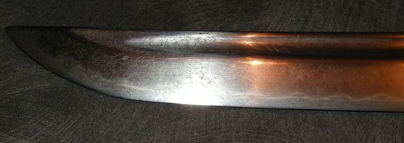

Great looking Hataraki in the hamon!!!

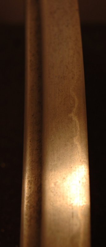

Maybe it´s just too late her in central Europe (just returned from the pub ;) ) but the weakly cut bôhi,
the uniform hamon, the hardly existing yokote (if there was once a yokote which got just worn, the areas
before and after the place where it was wouldn´t look that uniform), and the two huge identically sized
mekugi-ana let ring my warning bell!

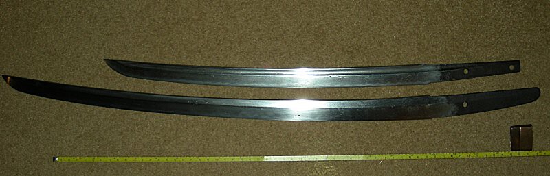

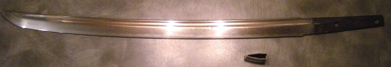

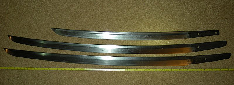

I am adding these images for a size comparison with an unpolished 52cm sanbonsugi blade of shinto origin and also with a Takada saneyuki blade of 54cm from approx 1790 at the very bottom.
This should help people to see the narrow aspects of the blade with Bo Hi.

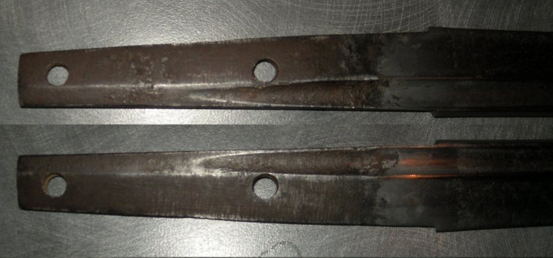

There is evidence just above the first mekugi ana of at least Machiokuri on one side of the nakago but it does not translate in the images.

Here are the size comparisons

I believe Markus is referring to how amateurish the hi seems to terminate at both ends. There is something soft about this whole sword and I agree that bells should be ringing. I am sure something isn't right here. John

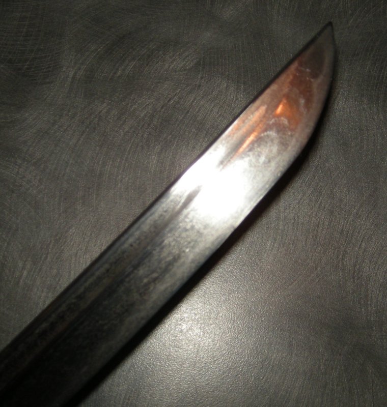

I don't know for sure, But my guess would still have it as a very old, polished down, and well used WAkizashi. Looks a bit tired from the pics .

Shan, Markus' remarks are by no means cryptic. They are just polite and he's perfectly right in pointing out the poorly cut bo-hi and other suspicious features. - The comparison of blades you are presenting is no help at all. It's just one blade's sugata compared to others (confirmed in any way?). - No matter what the honey-dipper says: There are no "great looking hataraki" visible in your pics, it's just poor condition of the blade. The blade looks like any 20th century Seki-style blade by now. Garlic again.

The nakago looks a little weird to me. It seems a little "unfinished".
To me, every time I see a hi that looks like that, I think "showato". The nakago rust tells me otherwise. I believe the nakago may have been hastily finished if suriage.
The hamon just doesn't look right to me either.

The hamon is very precise I agree but I believe still genuine and shows No Mizukage.
The nakago shows signs of at least one previous machiokuri above the first Ana and I believe the blade to be O-suriage.

I also understand that the addition of this Hi was sometimes to rebalance a blade that had lost its balance because of suriage or to cover Flaws in the steel.
