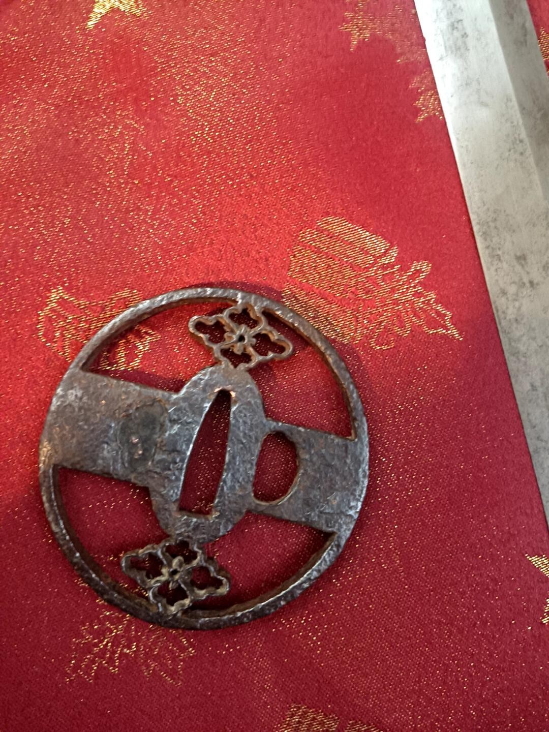

vieira Posted May 16, 2022 Report Posted May 16, 2022 Hello, I am a european edged weapons colector, i know (almost) nothing about Japanese swords, this sword was in a old family house for display with many other european edged weapons, the house dates to the times Portuguese had MACAU and GOA and the family said the sword belonged to one of his ancestors that worked most of his life in GOA/INDIA and MACAU/CHINA. As i european edged weapons colector i am very impressed with the quality of the blade, very sharp and solid, but i guess all Japanese swords are of good quality so that means.... i would like to know some of your opinions of the style and period of the sword. Many thanks for all help! Vieira Quote
Mark S. Posted May 16, 2022 Report Posted May 16, 2022 Difficult to determine much from the photos and state of polish. Shape hints at late Shinto into Shin-Shinto. Fittings appear to have seen better days. The appearance of the area in the Ha-machi (area where the sharpened edge meets the tang) 'looks' like it might be rather healthy and blade may not have seen too many polishes, but that is pure speculation. Others may have other opinions, but that's the best I can do for now. Trying not to assume what you do or don't know, just want to be sure... Do not touch blade with bare hands, NEVER clean nakago (tang). You can gently clean blade with microfiber cloth or plain soft tissue (non-scented or no other lotion added tissue) and as close to 100% isopropyl alcohol as possible. DO NOT use any type of metal or jewelry polish of any sort. A shiny sword is NOT a well polished sword. Huge difference. Also, after cleaning, a bit of light oil (sewing machine oil) or Japanese choji scented oil (from sword supply dealers) may help as well to stop additional rusting (very light coat). Don't be afraid to ask questions before you do anything to blade or fittings. 2 2 Quote
vieira Posted May 16, 2022 Author Report Posted May 16, 2022 To be honest i already clean some of the blade, i know Japanese procedures are diferent from european, as a european weapons colector i maintain my 200 swords and now something about metals and restoration process, i also by curiosity saw a video of the Japanese polish process, and its something that in first steps is very agressive and takes out metal, so i think the only thing i did that was a light cleaning machine polish with cotton would not arm the metal in anyway, am i wrong ? i also notice that this blade ger much more hoter in the polish process than european steel, any ideia why ? Tks. Best Regards, Vieira Quote
Brian Posted May 16, 2022 Report Posted May 16, 2022 Do NOT polish in ANY way. This is not a Western or European sword. It is not treated the same way, and their processes have zero to do with this. Oil and wipe...that is all. 1 Quote
AntiquarianCat Posted May 16, 2022 Report Posted May 16, 2022 It might be worth mentioning there are many documented cases where people have lost old and desirable blades because of leaving them in the hands of a polisher without formal training. I’ll admit I don’t know much about polishing but my understanding is a classically trained polisher will seldom be “very agressive and take out metal” especially if the overall geometry is intact like yours. The reason is a sword’s lifespan is measured in metal and once you run out of hard outer steel the sword is effectively dead. That’s why trained polishers always endeavor to remove as little metal as possible. 2 1 Quote
vieira Posted May 16, 2022 Author Report Posted May 16, 2022 On 5/16/2022 at 4:36 PM, AntiquarianCat said: It might be worth mentioning there are many documented cases where people have lost old and desirable blades because of leaving them in the hands of a polisher without formal training. I’ll admit I don’t know much about polishing but my understanding is a classically trained polisher will seldom be “very agressive and take out metal” especially if the overall geometry is intact like yours. The reason is a sword’s lifespan is measured in metal and once you run out of hard outer steel the sword is effectively dead. That’s why trained polishers always endeavor to remove as little metal as possible. Expand Yes but that factor is universal for any edged weapon, as i said i used only cotton polish no way it could take out metal its just a soft cleaning, and has i said earlier i watched some videos of the Japanese traditional process, this blade because of the black spots if it went to Japan to polish they would take a much more agressive 1st step to go deeper in the metal, noting compared to cotton! ofcourse i will not use anything with the capacity to scratch the metal. tks. Vieira 1 Quote
Mark S. Posted May 16, 2022 Report Posted May 16, 2022 Please go here: There is a discussion on amateur polishing. While it is a bit strongly worded and really aimed at people who pretend to polish Japanese swords as a 'hobby' or for whatever other reason they feel it is OK, I think it may answer some questions on why polishing Japanese swords ISN'T like any other type of sword. I also don't want to re-hash all this information here. Please read it and understand it is not a personal criticism of you... but we all have to learn somehow and sometimes education comes with a bit of pain. Hope you stay with us and continue to learn! Not sure what you mean by "cotton polish", but if it is a mechanical process (spinning wheel?) then it isn't doing the blade any good. 1 Quote
Baba Yaga Posted May 16, 2022 Report Posted May 16, 2022 Check this out http://www.japaneseswordindex.com/measure.htm You can give us some measurements. Doesn't look like you scratched it in an attempt to clean it, but advise to stop. That rust is much deeper than it looks, it always is. 1 Quote

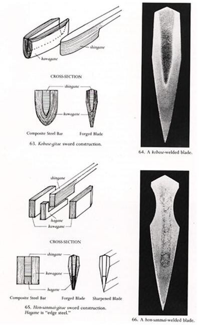

WillFalstaff Posted May 16, 2022 Report Posted May 16, 2022 Hi Vieira, Here is how tamahagane steel is made: 1 Quote
