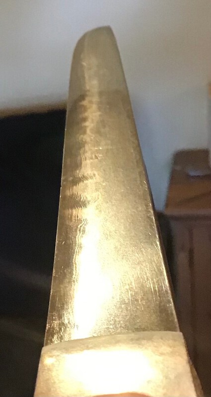

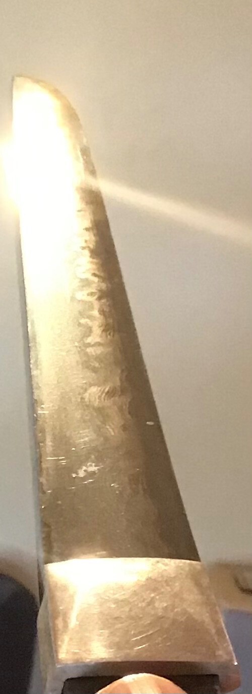

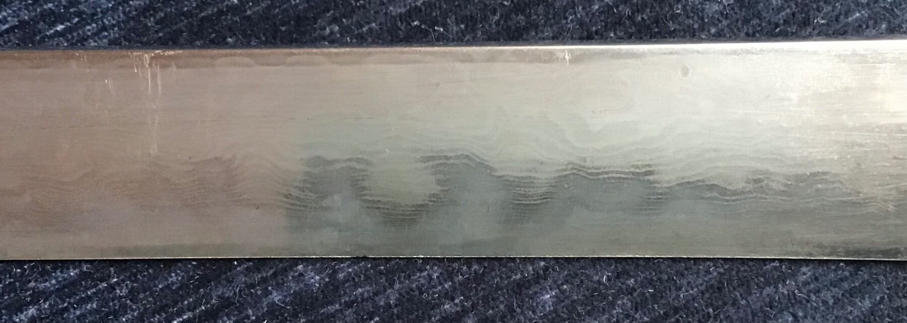

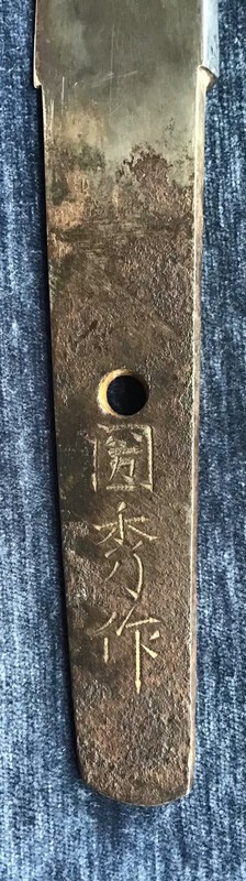

Matsunoki Posted May 16, 2022 Report Posted May 16, 2022 Greetings again from the UK. I hope you don’t get fed up with me posting my eclectic recent acquisitions!…but I’m enjoying being part of this forum greatly. ”in hand” this is a pleasing elegant Tanto blade of Yoroi-doshi proportions. However trying to image it has been, as usual, very tricky. It has a strange polish…..almost a milky finish….I hope it is not the dreaded acid?…..opinions welcome. The colour of the hada and hamon appear to be reversed! No mountings at all….bare blade and habaki. Nagasa 24.3 cm Motohaba 9.1mm Motokasane 2.46mm Mei Kunihide saku. Koka3. 1846 I think. solid silver habaki It’s a bit of a wild hamon, perhaps gunomechojimidare…..I’ll just post loads of images and welcome your comments …..good or bad! BIG QUESTION IS…can you please tell me which Kunihide? Many thanks in advance. best wishes Colin Quote
kyushukairu Posted May 16, 2022 Report Posted May 16, 2022 Colin, one thing to note is although ‘Kunihide’ [国秀] is a fairly common name, the mei on your tanto is signed with 圀, which is an unusual character for Kuni. I believe this to be the work of Enryūshi Kunihide [円龍子圀秀], who resided in Kōzuke, Annaka [上州安中] (modern day Gunma prefecture), and was trained by Nakayama Ikkansai Yoshihiro” (中山一貫斎義弘), who worked in the Norishige style. Here is another example of Kunihide’s work - https://www.nipponto.co.jp/swords4/KY328889.htm The one in the link is dated three years after yours, also displays the same pronounced hada, and is listed as an utsushi of Norishige. 4 Quote

Bazza Posted May 17, 2022 Report Posted May 17, 2022 The kissaki features uchizori, reverse curvature, surely hallmarking it as an utsushi. BaZZa. Quote
WulinRuilong Posted May 17, 2022 Report Posted May 17, 2022 - 圀秀作 弘化五年二月日(則重写) Kunihide - 日本刀の通信販売 明倫産業株式会社 (nipponto.co.jp) 上州安中住円龍子圀秀 Quote

sabiji Posted May 18, 2022 Report Posted May 18, 2022 Basically, Kyle has already written everything with the reference that Ikkansai Yoshihiro was a teacher of this Kunihide. If one sees such a Hamon torn by an aggressive Hada, must go actually immediately the alarm bells that here influence of Ikkansai Yoshihiro is present. He had developed a forging technique whose result is almost reminiscent of modern damascus, in order to come as close as possible to the appearance of Norishige blades. This effect is also sometimes seen in Kawaii Hisayuki, who also learned from Yoshihiro, only that Hisayuki forged the Hada more densely, so that the effect appears much more subtle. With Yoshihiro's work, I sometimes don't know whether to rejoice or cry. Some blades look quite spectacular, others just awful. A good example is the other linked blade by Kunihide: it's pretty special...okay, whoever likes it... Quote
