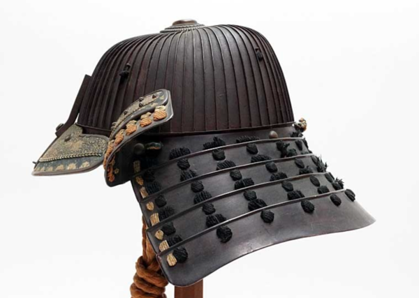

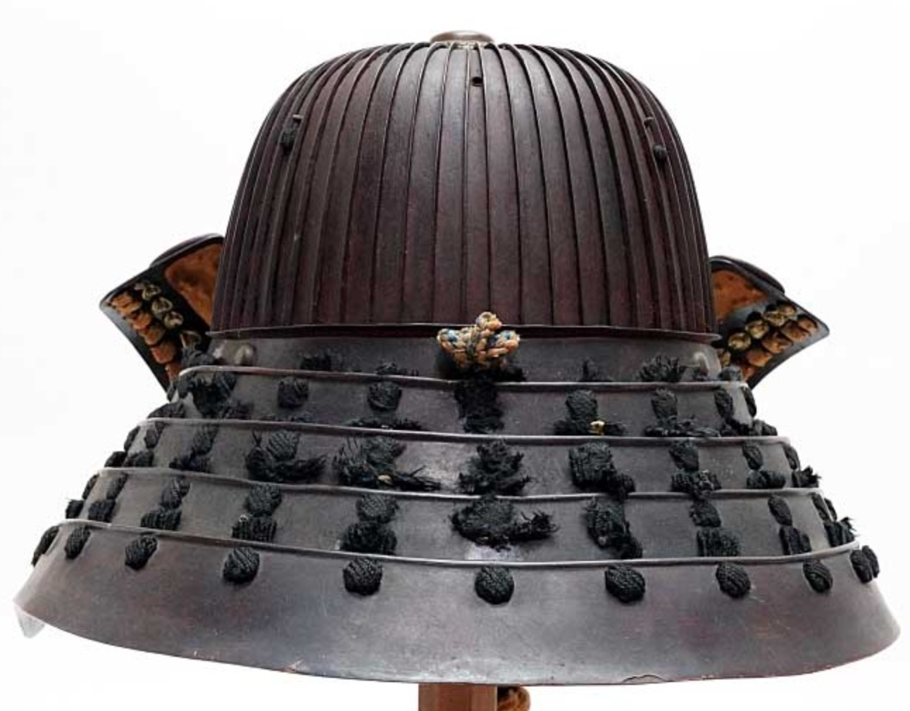

sounderites Posted May 8, 2022 Report Posted May 8, 2022 Nervous to cut through the Ukebari to look for a signature. Do we think this might be Saotome? Thanks! 1 Quote
Shugyosha Posted May 8, 2022 Report Posted May 8, 2022 Hi Julian, I'm not an armour guy but advice a saw on another thread was to buy a cheap endoscope and go in through the hole in the top (Tehen?) to check for a signature. Looks a nice kabuto whether signed or not. 1 Quote
Marc T Posted May 8, 2022 Report Posted May 8, 2022 Hello Julian, Fully agree with John. Do not cut the ukebari. Nice helmet by the way. Quote
Luc T Posted May 8, 2022 Report Posted May 8, 2022 If you want to compare: http://www.saotomebook.com Quote
uwe Posted May 8, 2022 Report Posted May 8, 2022 Agreed, I rather would put it in the Myōchin corner. 1 Quote

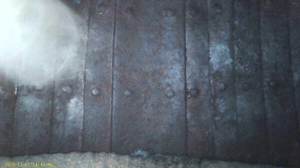

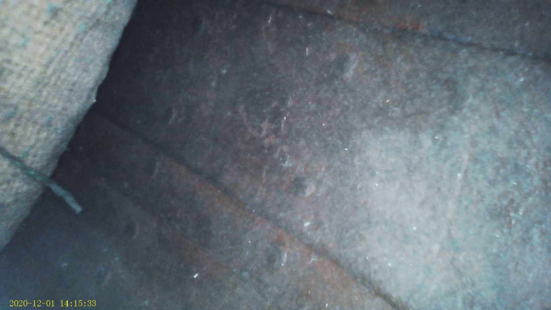

sounderites Posted May 10, 2022 Author Report Posted May 10, 2022 Looking at the back plate, I don't think I can see a mei. The $39 endoscope might not be high enough resolution though. Any other thoughts on how to tell what school this helmet is? Thanks! 1 Quote
Luc T Posted May 11, 2022 Report Posted May 11, 2022 The characteristics point towards east Japan. However determining a specific school is difficult. Yashu or Soshu are possible. Did you check the frontplate? Quote
sounderites Posted May 11, 2022 Author Report Posted May 11, 2022 I tried the front plate, but it seemed no wider than any of the other plates. Not much room for a mei. Came w/ edo period Satake clan maedate if that is helpful, but probably not. Quote
uwe Posted May 11, 2022 Report Posted May 11, 2022 Your cheap endoscope does a good job, Julian! Quite good workmanship with 6 rows of rivets. Unfortunately, no mei…. 1 Quote
Luc T Posted May 11, 2022 Report Posted May 11, 2022 On 5/11/2022 at 5:41 AM, uwe said: Your cheap endoscope does a good job, Julian! Quite good workmanship with 6 rows of rivets. Unfortunately, no mei…. Expand Good observation. This sorts out Yashu. Also no Saotome, Haruta, Bamen. 1 Quote
