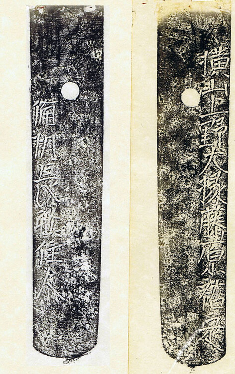

Can anyone help with a full translation of my Bizen Sukesada wakizashi. Just a few kanji I can't figure out.
Also any idea if this is a real mei, I know this is a very common gimei. :lol:
Thanks,
Peter
If I'm not mistaken it's Yokoyama Kozuke Daijo Fujiwara Sukesada / Bishu Osafune Junin.
I have a papered one with the same mei. Yours seems a bit off to me, especially the kanji for Osafune. The strokes don't match up to mine nor the one in Fujishiro's (which is almost the exact same as mine)
Here's another shoshin example
http://www.nihonto.us/Yokoyama%20Sukesada.htm
