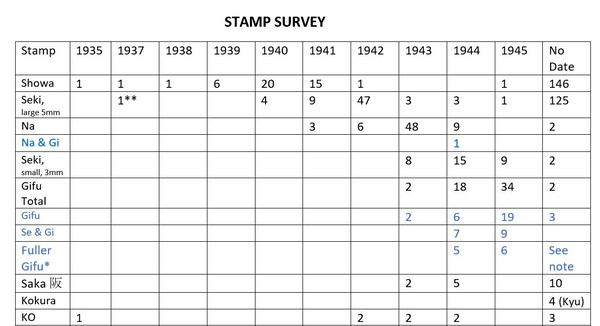

Bruce Pennington Posted May 8, 2022 Report Posted May 8, 2022 Hi Xander! I have a full discussion of this in the first chapter of Stamps of the Japanese Sword. Concerning showato in Japan, as I understand the current laws, they allow people to register swords regardless of whether they are traditional or not. The premise being someone just bought a house and "found" this sword in the attic rafters. It seems they are being "found" more frequently lately! Ha! And at the same time, like Bruno pointed out, the culture is beginning to recognize the historical value of them. Stamping - not all swords got inspected, and not all swords got stamped. In the hundreds of swords examined by Richard Fuller, Mal Cox, and myself, half have no stamps at all, yet many of them were likely non-traditionally made. To my knowledge, there have been no documents found requiring the stamping of blades of either kind, nor requiring the military to stamp blades. We do have regulation info showing the inspector stamps of the various arsenals, so this would IMPLY that they were required to do some stamping, but we still do not have proof that the stamping was done simply as an acceptance process or to indicate a blade was non-traditional. The Showa and Seki stamps are still a bit of a mystery. The only actual written evidence we have comes from the Seki City website, that describes the early years of showato manufacturing. The high demand for swords caused the industry to really ramp-up rapidly. There were forges making some really crappy showato, which bothered the dealers. So, the dealers requested the Seki Cutlery Manufacturers Association to inspect blades for quality. They complied and acceptable blades were stamped. The website does not say what the stamp looked like. It would be easy to say the "Seki" stamp was the one they used, and it may turn out to be true, but I'm bothered by the fact that we don't have any observed Seki stamps prior to 1940, and the majority of them are seen in 1942 - well beyond the surge in sword production created by the Army's demands of the China incursion of the mid-late '30s. While, in fact, we see the "Showa" stamp as early as 1935, peaking in 1940 and tapering off as the "Seki" stamp takes over. My personal opinion is that the Assoc. used them both, starting with the Showa stamp and replacing it with the Seki stamp, reasons unknown. Ohmura, in researching Seki production and stamping, found a document stating half the swords were not stamped because "traditional swords were not part of that tally". Once the Army assumed control of blade production, around 1942, stamping changed to predominantly area/arsenal stamps, but like I said, we have no documented reasons for the stamping practice. I believe, now, that they were simply acceptance stamps. Gendaito made for the military were often RJT and received the star, or Yasukuni/Minatagawa blades; or were sold privately. Were there some gendaito that received other stamps? There are one or two rare examples of Showa stamped blades that were papered, but I'm not aware of any others. Ah. So I got to rambling! There were many showato made before the stamping process was in full swing. I believe many of the non-dated blades were made early in the war, say 1935-1940, and never went through an inspection process involving stamps. 3 1 Quote
Brian Posted May 8, 2022 Report Posted May 8, 2022 Mostly correct, however no....non-traditionally made swords are not supposed to be registered. They are supposed to be destroyed. And some stamps prove non-traditional. But lack of stamps does NOT make it a Gendaito. In fact most unstamped swords are likely mass produced when made during the war. Yes, people with "contacts" or favours get swords registered that shouldn't be. That happens . 1 1 Quote
