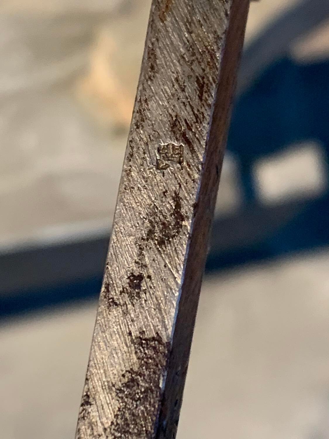

This morning I visited a man, whose father brought back this sword from Indonesia after WW2.
There is lots of study to do and its hard to see the hamon, because the blade has lots of tiny scratches. I really like this one nonetheless. I do however wonder what the character(s) on the nakago mune mean.

The marking on the nakago mune is the katakana character HO ホ.  It is a factory inspection mark used by the 1st Factory of Kokura Army Arsenal 小倉陸軍造兵廠第一製造所.

There could be a second inspection mark on the nakago mune above the ホ under the grime or rust.  If so, it would probably be a 名 for Nagoya Arsenal.

Christian, this stamp/ sign on the Nakago mune does not mean it is not traditional to my knowledge.

@Leen, The last character on the date is "Spring", so it was "Spring 1942".  Kanenobu became an RJT smith, likely after this blade was made (from lack of star-stamp).  The program had only just begun at this time, so he must have gotten qualified sometime later.  You will often see inspection stamps on the mune, like this, on star-stamped gendaito, so it does not mean the blade is non-traditional.  Your small stamp above the "HO" in the corrosion does look like a "Na", like Thomas said.  I have a few other gendaito with this combination on file, all between 1940 - 1942.  They seem to stop after '42.
