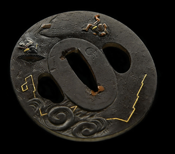

Marco Posted April 25, 2022 Report Posted April 25, 2022 Good morning, can somebody help me for identifying the theme or the Kao? Any info would be much appreciated. 1 Quote
Bazza Posted April 26, 2022 Report Posted April 26, 2022 "... can somebody help me for identifying the theme or the Kao?" Should this question have been " ...the theme of the tsuba?" ?? The KAO is the KAO, a glyph, it has no intrinsic meaning in and of itself I would opine (thrusting neck out). BaZZa. Quote
Brian Posted April 26, 2022 Report Posted April 26, 2022 Identify the theme.....or identify whose kao. Quote
Bugyotsuji Posted April 26, 2022 Report Posted April 26, 2022 Taira Tadamori and the oil thief? 1 Quote
Spartancrest Posted April 26, 2022 Report Posted April 26, 2022 Don't use a metal umbrella in a thunderstorm. 2 Quote
Marco Posted April 26, 2022 Author Report Posted April 26, 2022 On 4/26/2022 at 10:08 AM, Brian said: Identify the theme.....or identify whose kao. Expand Thanks Brian, it’s what I meant to ask. Quote
