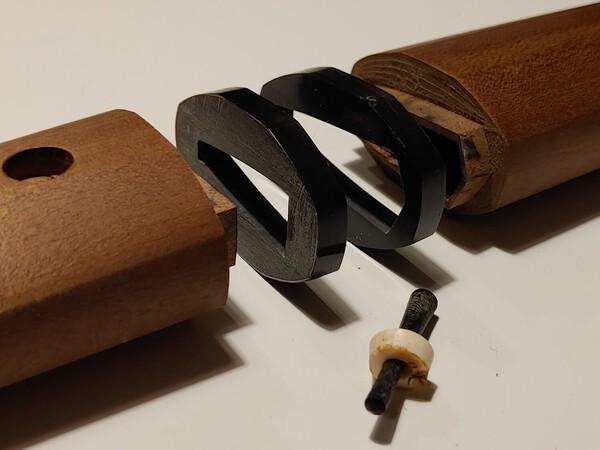

Hi Ian,
Please excuse my poor experimental tsuka.
This is how the nakago should fit into the tsuka. Notice the alignments and the spaces on both halves of the tsuka, as well as the alignment of the mekugi ana. The two lower pics have the mekugi through a tsuka half and the nakago.
