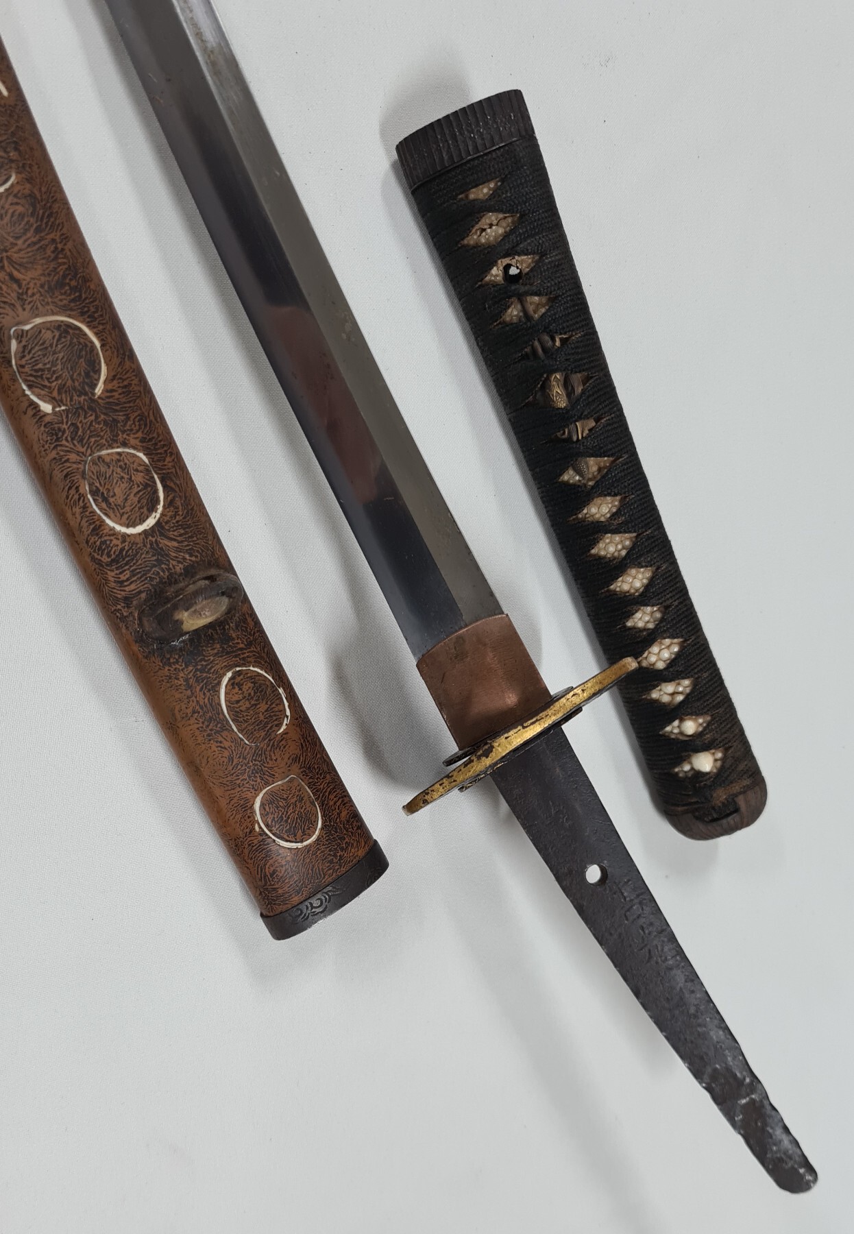

Hello Gents, just posted a listing of new yoshimitsu dword but curious about the fittings. Tsubas quite flyid in its main detail, almost like pressed clay in the malluable ways the irons been formed, not something ive come across as mainly collect WW2 era pieces. Any help appreciated.
  • Love 1
Was sure about the simple form of forging on the fittings but actually really like the way the irons  folded over and seems habd pressed in its finish the more i look at it.
First guess would be Shoami - "style".  Its not signed and a pretty conventional design based I think on Chinese landscape paintings.
The ategane in the hitsu points to several mountings and the gold nunome edging lifts its quality a little.  Please be aware the images should be the other way up with the narrow part of the nakago-ana pointing upwards [cutting edge] the way they would be seen when mounted.
It is interesting you say the way it looks like it was molded in clay - that sentiment was held by many early European writers back in the 19th century and the skill of the tsuba maker is still inspiring that thought even today.
Thankyou for your knowledge, your detail on correct presentation and your mentioning of how my 1st impression as a western sword collector was an echo of earlier westerners describing this style of tsuba.
Greatly appreciated.

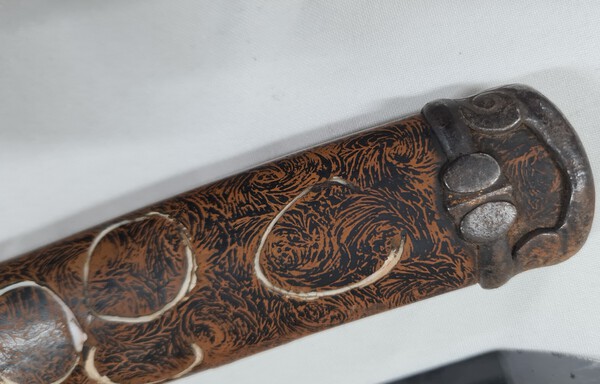

I am no expert on Saya but I do like the iron fittings on yours. Do you think the white circles are inlay of shell? I saw a similar effect on a knife handle where they used boar teeth in resin [not something you would expect to see] it turned out spectacular - on a "forged in fire" episode.
I like the tsuba. I know the concept of looking at iron/steel and saying "looks like good iron/steel" judging from the aesthetic and patina is probably largely a fallacy, but if it had any truth, I'd say this looks like good iron. Dark, and nice and smooth with good patina. Very appealing.
The saya 2 tone lacquer and the white swirls look to be sectionalized sea shell pressed into the surface. Yes the iron fittings are very nice.
