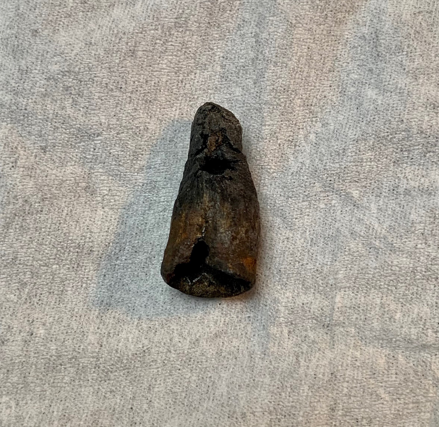

PS Just for interest, here is something that was jammed inside a Satsuma barrel. It’s a strange misshapen thing. Not iron, possibly lead? A Minié-type of round which could have melted as ignited powder escaped around/through it??? Stumped for ideas.
It def got a ”projectile” shape to it. Is that a hole on top?
You find the strangest of things inside your barrels. I got 10+ matchlocks at home and the only thing I ever found was a piece of blackpowder-covered cloth in one of them 🙂
