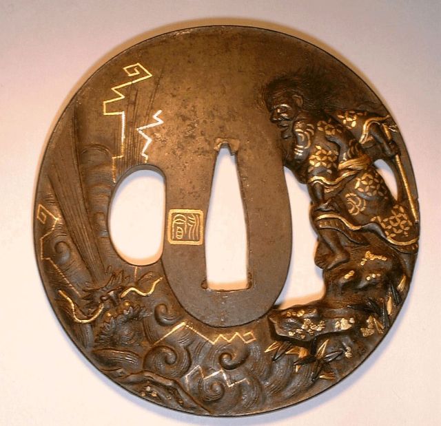

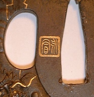

docliss Posted April 1, 2009 Report Posted April 1, 2009 Can any kind member please identify the gold hon-zogan seal on the attached tsuba? It is, I suspect, Tetsugendo work, but .... With thanks, John L. Quote
Bob M. Posted April 1, 2009 Report Posted April 1, 2009 Hi John, From what I can see , looking at the seal only, closest to Issando Joi - whether an adaption of his or someone's attempt to copy, I wouldn't know... Regards Quote
docliss Posted April 1, 2009 Author Report Posted April 1, 2009 Dear Bob, thank you for your reply, and I can certainly see where you are coming from. The first character is identical - but the second differs appreciably - from that of Joi as illustrated on p. 189d of Kinko Meikan - and the work is certainly not that of Joi. I have a feeling that we are not there yet! Regards, John L. Quote

Soshin Posted April 26, 2009 Report Posted April 26, 2009 Great looking tsuba! :D I have seen another tusba that was mumei like this one with only the artists seal in kin-iroe. It was listed on eBay and I bid on it but it never got above the reserve price and I don't think it was ever relisted. I am sorry I can't provide any additional information about the maker of the tusba. Quote
