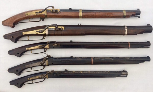

Hi!
Piers, the Yonezawa at the top is 10 monme. Under There is a 50 monme Seki. Then there are two ten monme Seki were one is converted to percussion. That one is made in Kunetomo and returned there for the percussion upgrade. The one at the bottom is kind of a hybride. It’s a six monme bajozutsu. The stock and lock is all Seki but the barrel is maybe nanban and pegs are holding the barrel, not the brass or cupper bands you normaly see on both schools. The 50 monme Seki has both the original cupper and brass band as well as a set in silver with chrysantemum decorations.
