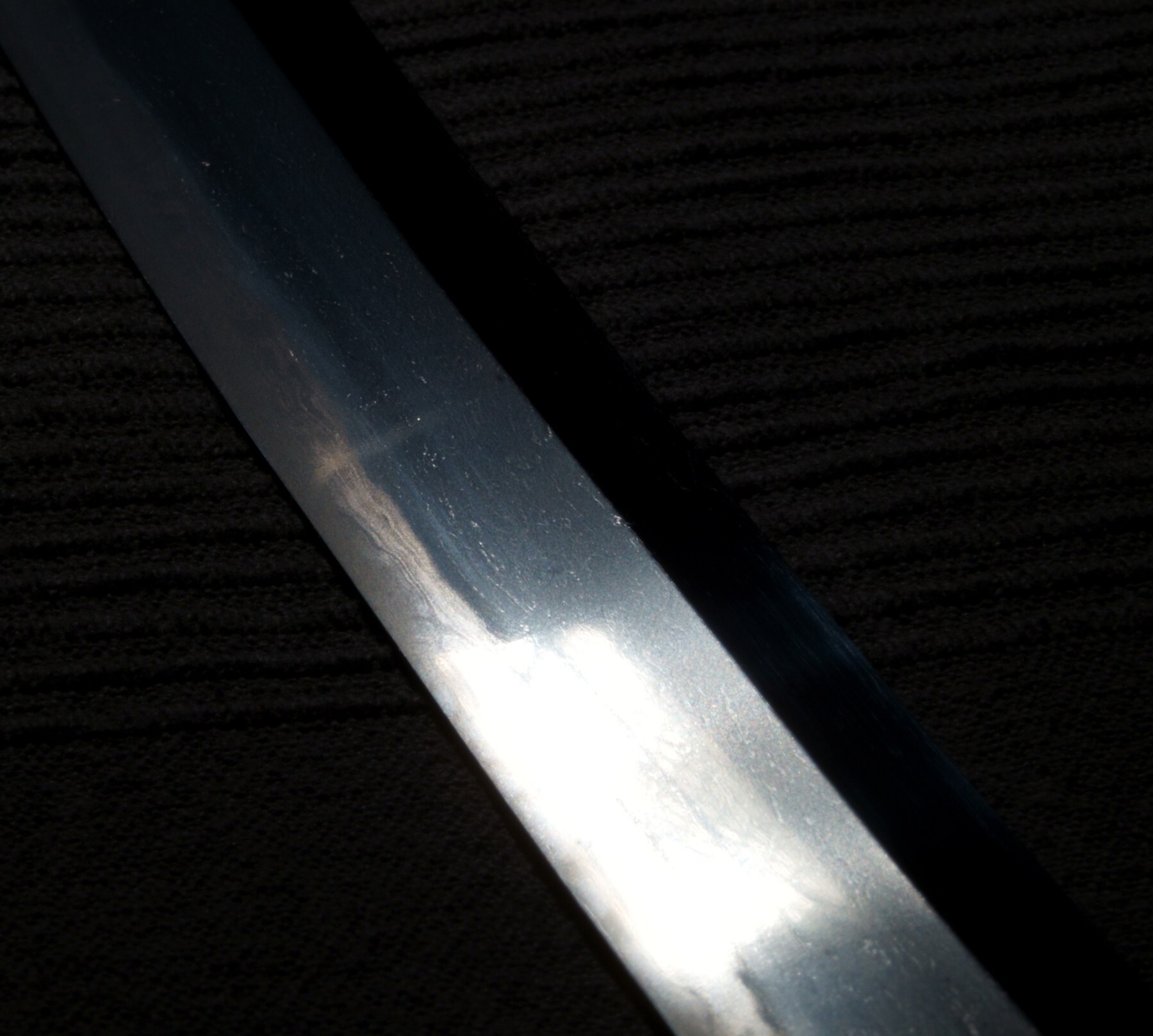

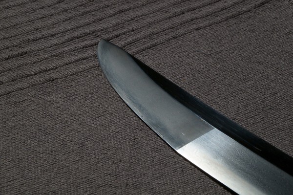

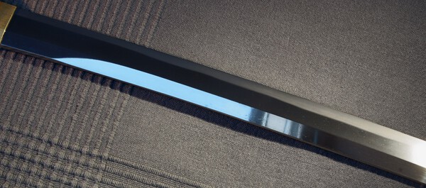

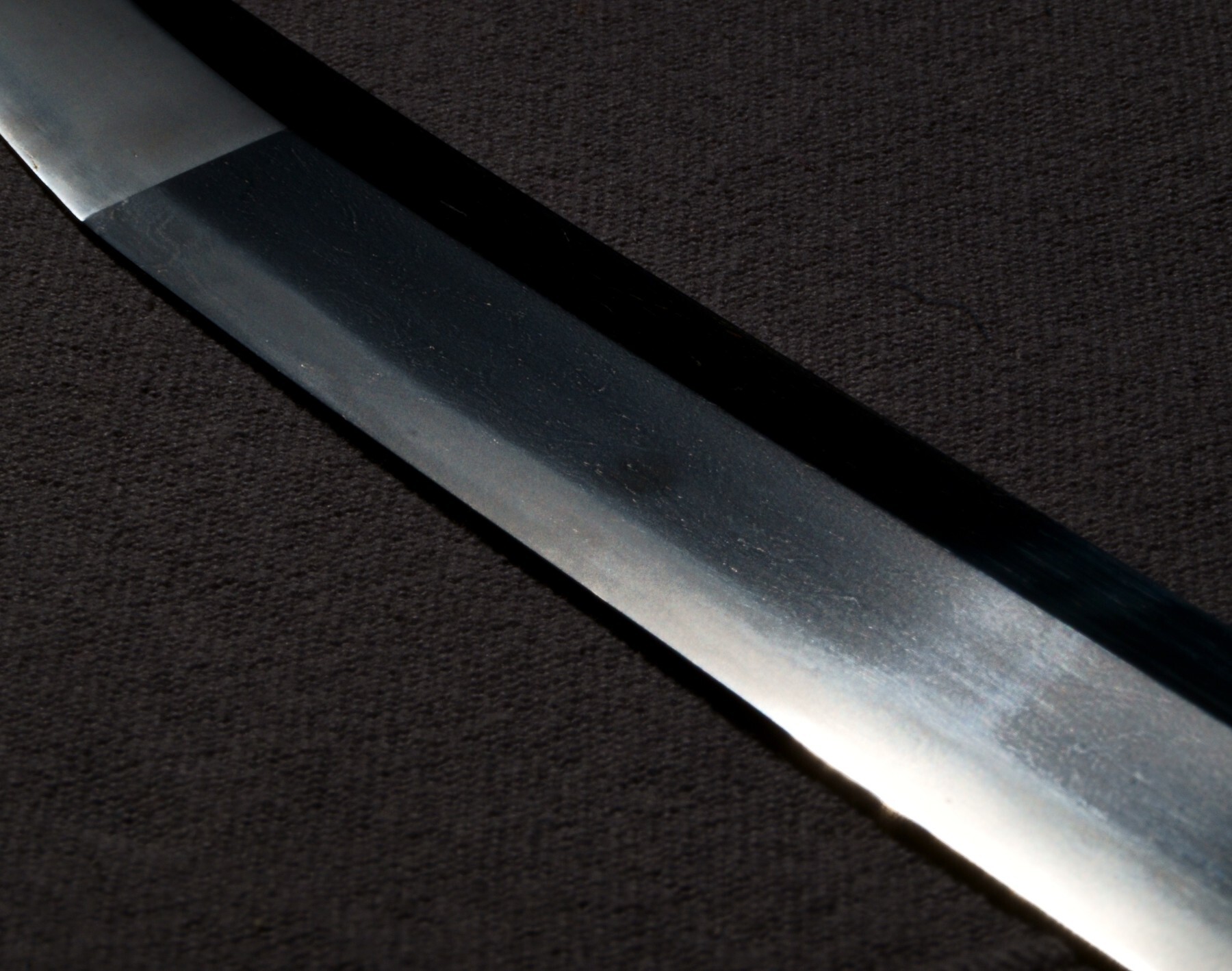

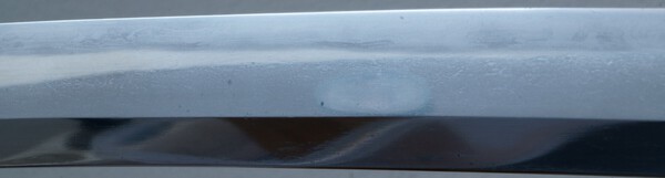

DoTanuki yokai Posted April 17, 2022 Report Posted April 17, 2022 Hi Just for our entertainment and inspired by others, i will also try to make a Kantei thread. The blade is Unokubi-zukuri and the Shinogi is high. Nagasa: 55,2cm Kasane: 0,58cm Sori: 1.05cm Moto-Haba: 2,9cm Saki-Haba: 2,6cm Weight: 520g I Hope everything else can be seen in the pictures. The Nakago is hidden but i can later add it when it is too hard, its only by pictures after all. I hope for many participants and i will let it run for a week or some days more. Please forgive the dust on my camera lens. Have fun and Happy easter. 4 Quote

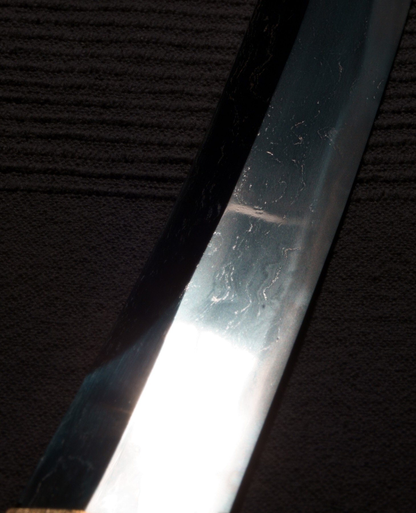

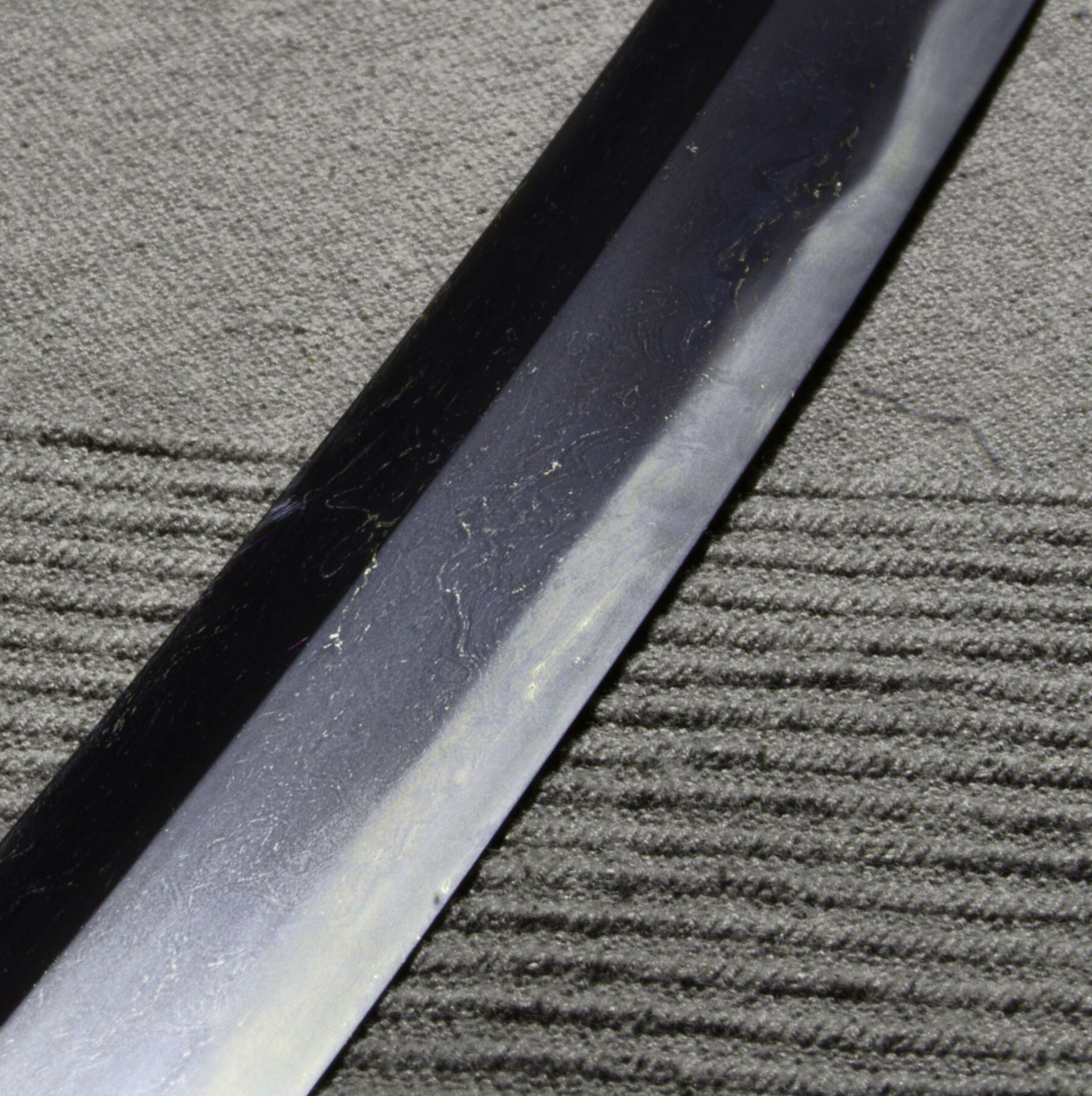

DoTanuki yokai Posted April 17, 2022 Author Report Posted April 17, 2022 I needed some photo sessions to capture enought useable pictures and i hope i got some good ones. Thanks. 2 Quote
Rivkin Posted April 18, 2022 Report Posted April 18, 2022 Ugh! I wanted to say right away a Nambokucho Yamato off-shoot Tegai/Mihara type but the hamon is a bit too intricate... Sue Sa? 2 Quote
Jussi Ekholm Posted April 18, 2022 Report Posted April 18, 2022 Thanks for posting this one. These are always great experiences. Spoiler My guess would be naginata-naoshi from Nanbokuchō period. I am also thinking it has Yamato feeling but with bit roughness (not maybe good word to use). I think I would go for Ko-Uda. 3 1 Quote
Rivkin Posted April 20, 2022 Report Posted April 20, 2022 Looking at it once again I feel the nie is a bit too ill defined for Yamato... Echizen Rai? 2 Quote
Sutraken Posted April 20, 2022 Report Posted April 20, 2022 Although the sugata appears to be typical for a nanbokucho period sword, I would guess the wakizashi was made by the shinshinto master Sa Yukihide. 2 Quote

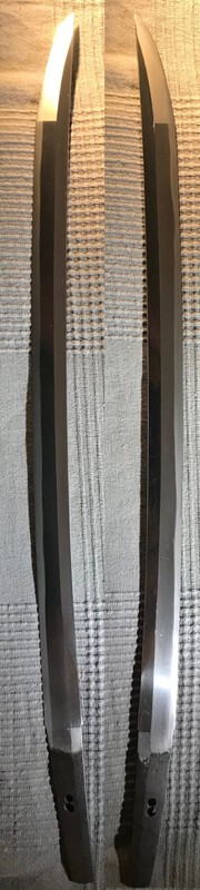

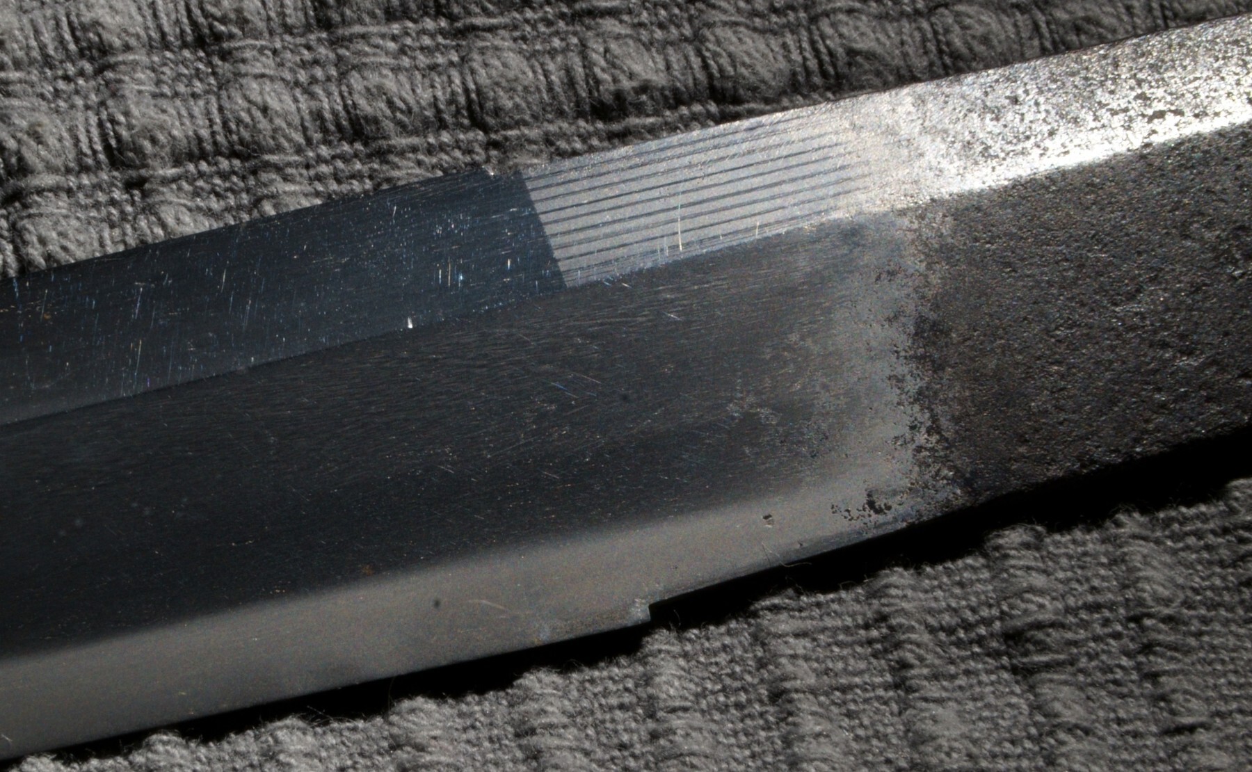

DoTanuki yokai Posted April 20, 2022 Author Report Posted April 20, 2022 Thanks for participating so far, here is the Nakago for the undecided. If someone want to change his opinion it’s alright but I don’t want to influence anyone. 1 Quote
Sutraken Posted April 20, 2022 Report Posted April 20, 2022 Well, after seeing this nakago I have to change my guess to the nanbokucho sa school. This grade of patina makes shinshinto very unlikely. 2 Quote

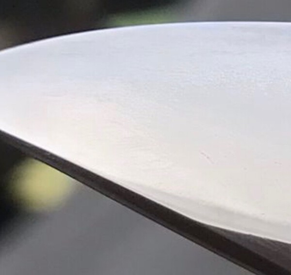

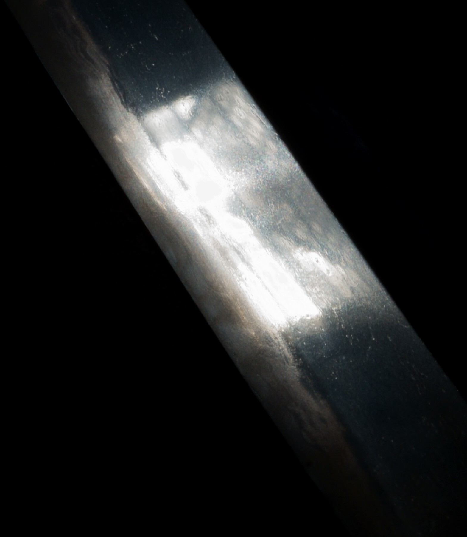

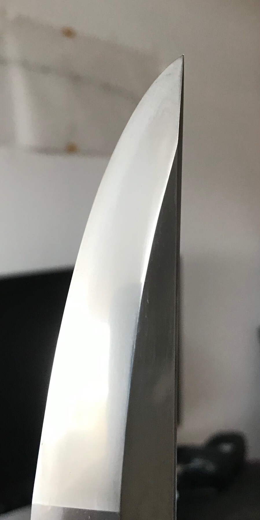

Toryu2020 Posted April 20, 2022 Report Posted April 20, 2022 Do we have better photos of the boshi? 1 Quote
SteveM Posted April 21, 2022 Report Posted April 21, 2022 Looking forward to the reveal. Too hard for me. I can't even say with confidence what this is; Nambokuchō naginata-naoshi or shintō revival? I'll throw my hat in with Sue Sa, but not through any brain-work of my own. 2 Quote
DoTanuki yokai Posted April 21, 2022 Author Report Posted April 21, 2022 This is the best I can do at the moment, i have tried to have the whole kissaki on my pictures but it’s hard to get the light right for it. I will try a better close up of the Boshi later. Quote
DoTanuki yokai Posted April 21, 2022 Author Report Posted April 21, 2022 I hope this is good enough. I have to add that the tip geometry is not 100% perfect, the last few millimeters change angle a little. Quote
Toryu2020 Posted April 21, 2022 Report Posted April 21, 2022 have we tried the old trick of closing yourself up in a completely black room and then using the flash on your phone to capture a photo? -t Quote

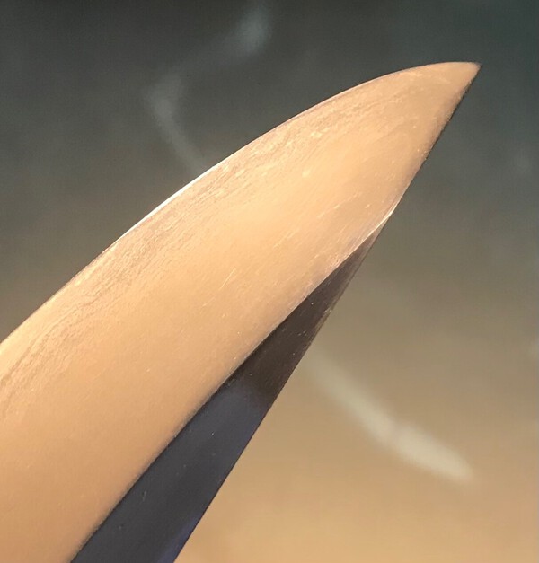

DoTanuki yokai Posted April 21, 2022 Author Report Posted April 21, 2022 Found one more. EDIT: I will try the flash next Quote
Jussi Ekholm Posted April 21, 2022 Report Posted April 21, 2022 I must admit that nakago is different than I thought it would be but I still think it would be a greatly shortened Nanbokuchō sword. It is very interesting. Quote
Sutraken Posted April 21, 2022 Report Posted April 21, 2022 In my opinion, this sword was originally made as a regular size nanbokucho tachi, which was later shortened to its actual length as a wakizashi. Perhaps there were some battle damages making a shortage to this length below katana standards necessary. 2 Quote

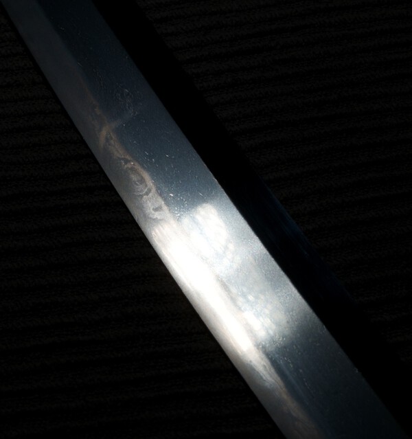

DoTanuki yokai Posted April 25, 2022 Author Report Posted April 25, 2022 Sorry I’m late first the pictures with flash didn’t worked as good as I have wanted and then my Computer stopped working. Here is the best I got with my phone but i will show the attribution soon. Quote
DoTanuki yokai Posted April 25, 2022 Author Report Posted April 25, 2022 Thanks for participating and watching everyone. Im not sure if someone was right or wrong because it is only an attribution , but Jussi was of the same opinion as the NBTHK „Ko Uda“ so he wins I think. Good work i don’t know if I would be able to guess it right but I don’t want to say the NBTHK is wrong here Maybe this could have been useful for this (Usagiya website) And the NBTHK paper 6 Quote
Jussi Ekholm Posted April 26, 2022 Report Posted April 26, 2022 Wish I could claim just hitting it by confidence but in reality lot of it was luck and I do think it could have been multiple of similarish options. I think the snippet from Usagiya is good one as I thought that way although I am not sure if rough etc. is best way to describe. I know the feature was present in some schools and I felt Ko-Uda is a quite common "bucket" attribution for such feature along with other characteristics it has around this time period. I was quite sure it would have been shortened naginata but as it is classified as wakizashi I'd think it to be possibly a shortened tachi or ōdachi (I'd see that as logical but I am not yet 100% sure how NBTHK sees things). 4 Quote
Ooitame Posted April 27, 2022 Report Posted April 27, 2022 The long boshi threw me off from uda. Good one. Again Jussi, with instinct lead towards the right path, way to go! 1 Quote
DoTanuki yokai Posted April 27, 2022 Author Report Posted April 27, 2022 Im also not sure how this blade start life but from the feel I can imagine that the shape was altered because of the weight. Compared to other swords of this size and with a short nakago the blade feels still heavy. I prefer to say what it is now unokubi zukuri, because I think there won’t be a reliable answer how it started. the blade seems to be in this size for long time, for me it looks like it was shortened around mid Muromachi but this is just speculation from what I see in the Nakago. For the Boshi I have read somewhere that sometimes they have a very long kaeri that turn into muneyaki sometimes. EDIT: Ohh Maybe you talk about the overall size of the Kissaki, i think it is the longest i have seen with this attribution but i can imagine that this could be from some form of reshaping from naginata or nagamaki and the small kaeri is only a repurposed bigger Hamon element. Some years ago the founder Uda kunimitsu was just on papers but now there a 2 signed works existing. I think there is more research necessary too understand Uda school better. (Alternatively i dont have the right books) Also how reliable are sources that claim that some Uda smiths learned from Norishige, I can understand how someone can come to such conclusion but the similarities are not that much and also different. 1 Quote
