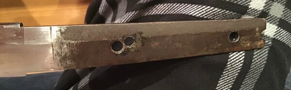

Matsunoki Posted April 14, 2022 Author Report Posted April 14, 2022 George, thank you for excellent explanation and helpful image. Looking closely, I think the two at the base of the nakago are old but the two grouped closely nearer the machi are “difficult”. The one nearest the machi is large and on one side the diameter is far bigger than the other side and it looks heavily “worked”. I’m thinking that one is drilled and badly reshaped. The smaller one next to it looks as if it has been affected by the filing work done on the large one ….if that makes sense. The rim has been brightened although the internal patina is dark. That would further fit my theory that it had WW2 mounts….maybe. If only it could talk. It looks like all opinions are in and the consensus seems to be “possibly Nanbokucho Yamato Shizu”. Could anyone give me an idea re it’s scarcity? So much more is known in the West about Nihonto now compared to when I had my first collection (30-35 years ago) so where does this sit in modern day thinking…..common? rare? worth polishing/shinsa? interesting ? shame about the………. All opinions welcome, Thanks again. Colin Quote
Jacques Posted April 14, 2022 Report Posted April 14, 2022 11 hours ago, Matsunoki said: Jacques…..Please excuse me but I do not understand. I agree the machi look crisp but surely that suggests machi-okuri rather than “suriage yesterday”? Colin When a sword is suriage (over than 1 or 2 cm) it's always machi-okuri too. This sword is not from Nanbokucho but probably from the 20th century, it was made to look like an old one. About mekugi ana, they are in no way a proof. i've seen punched mekugi ana perfectly circular and drilled ones which are not. 1 Quote
Matsunoki Posted April 15, 2022 Author Report Posted April 15, 2022 10 hours ago, Jacques D. said: When a sword is suriage (over than 1 or 2 cm) it's always machi-okuri too. This sword is not from Nanbokucho but probably from the 20th century, it was made to look like an old one. About mekugi ana, they are in no way a proof. i've seen punched mekugi ana perfectly circular and drilled ones which are not. Jacques, that is a very bold statement. Please can you tell me the features of the blade….hada, sugata, jihada, hamon, kissaki, boshi etc that make you think 20thC? The nakago (with all its confusion re the ana and machi) has obviously been so heavily modified that in my opinion it isn’t really much use in Kantei anyway……so we must look at the original work of the smith in the forging and tempering? However I know the condition is rather difficult…old worn polish etc. Quote

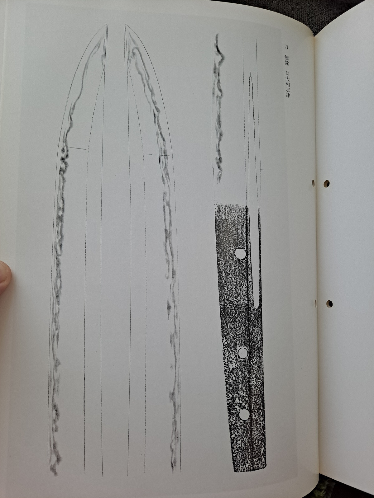

Jussi Ekholm Posted April 16, 2022 Report Posted April 16, 2022 Here are two examples of wide Yamato Shizu with large kissaki. I should have lot more of them in books. Nagasa: 71,4 cm Moto: 3,0 cm Saki: 2,6 cm Kissaki: 10,5 cm Nagasa: 64,7 cm Moto: 3,0 cm Saki: 2,5 cm Kissaki: 8,0 cm Regarding scarcity, shortened Nanbokuchō blades, while relatively rare are still in thousands and thousands (if that is what the sword is). They will get various attributions and some are more common than others. It is bit crazy but lot of the assumed value and rarity hangs on the attribution by experts. 1 Quote
Jacques Posted April 17, 2022 Report Posted April 17, 2022 On 4/15/2022 at 8:26 AM, Matsunoki said: Jacques, that is a very bold statement. Please can you tell me the features of the blade….hada, sugata, jihada, hamon, kissaki, boshi etc that make you think 20thC? The nakago (with all its confusion re the ana and machi) has obviously been so heavily modified that in my opinion it isn’t really much use in Kantei anyway……so we must look at the original work of the smith in the forging and tempering? However I know the condition is rather difficult…old worn polish etc. Have à look a the location of nakago shinogi on both sides, they show the sword is ubu. Compare the size of the ha machi with these on oshigatas shared by Jussy; it's why i said that sword was shortened yesterday 1 Quote
Alex A Posted April 17, 2022 Report Posted April 17, 2022 Looking at this image at the start of the thread, nakago looks unusual to me too, for a nanbokucho blade. As in that it does not appear to have the age. Quote
Matsunoki Posted April 17, 2022 Author Report Posted April 17, 2022 3 hours ago, Alex A said: Looking at this image at the start of the thread, nakago looks unusual to me too, for a nanbokucho blade. As in that it does not appear to have the age. Alex, of course it looks to have little age. There is absolutely none of the original nakago left so looking for a Nanbokucho nakago sugata or patina is pointless. For o-suriage koto (?) blades the nakago is often of little use in Kantei especially if it has been heavily reworked/reshaped as well as suriage/machi okuri. The nakago mune is sometimes seriously altered to allow the overall new blade sugata with a new tsuka fitted to look “right” ie the tsuka fits at the desired angle. I believe this blade emerged from WW2 koshirae……anything could have been done to it at that time. The remaining blade sugata and visible forging/tempering details are far more useful in forming an opinion…..in my opinion🙂 Quote
Matsunoki Posted April 17, 2022 Author Report Posted April 17, 2022 4 hours ago, Jacques D. said: Have à look a the location of nakago shinogi on both sides, they show the sword is ubu. Compare the size of the ha machi with these on oshigatas shared by Jussy; it's why i said that sword was shortened yesterday Jacques, thank you for your further comments. We must agree to differ. I cannot see how the size of the machi or the nakago shinogi tells us anything when an obviously already o-suriage nakago has then later been so extensively reworked. I think there is a very good chance that this blade emerged from WW2 koshirae so indeed it could have had anything done to it then. I go back to what I said earlier….what features of the blade make you think 20thC? The sugata is appropriate for Nanbokucho o-suriage including o-kissaki and deep motohaba. The visible hamon and hada look appropriate, there are many suguha hada openings- some quite large, the boshi which is quite complex also is appropriate etc etc. Quote
Alex A Posted April 17, 2022 Report Posted April 17, 2022 46 minutes ago, Matsunoki said: Alex, of course it looks to have little age. There is absolutely none of the original nakago left so looking for a Nanbokucho nakago sugata or patina is pointless. For o-suriage koto (?) blades the nakago is often of little use in Kantei especially if it has been heavily reworked/reshaped as well as suriage/machi okuri. The nakago mune is sometimes seriously altered to allow the overall new blade sugata with a new tsuka fitted to look “right” ie the tsuka fits at the desired angle. I believe this blade emerged from WW2 koshirae……anything could have been done to it at that time. The remaining blade sugata and visible forging/tempering details are far more useful in forming an opinion…..in my opinion🙂 Hi Colin, look at other examples of shortened Nanbokucho blades, places like Aoi online museum, then compare what you see to your blade. The patina, mekugi-ana, then you will know what i am referring to. Not really looked at the entire blade, just something that stood out as unusual when i first saw the image of the nakago When something dont quite look right, best to be cautious Im not saying it is not Nanbokucho, not saying it is Nanbokucho, just something that stands out as a little odd. Quote
Utopianarian Posted April 17, 2022 Report Posted April 17, 2022 Just an observation. There appears to be evidence of file patterns on the nakago. It doesn’t say much. It could have been original to the blade if ubu as stated above or added later if it was cut down and finished which I am kind of leaning away from. Hard to say without more evidence or most of all blade in hand. Quote
Utopianarian Posted April 17, 2022 Report Posted April 17, 2022 Here is a cut down Nanbokucho blade of mine to get an idea generally of what to look for. Sorry the end is out of the photo Quote
Matsunoki Posted April 17, 2022 Author Report Posted April 17, 2022 Thank you all for further comments…..I do truly appreciate your time and I respect your knowledge and expertise. What puzzles me is why we focus on a nakago that has been totally ruined by (several) reworkings. In hand it becomes a bit more obvious and my images are not great……sorry. It is (imo) o- suriage….you can see where it was just partially chiselled and then snapped off at the jiri (sorry I didn’t image that earlier) the last time someone butchered it leaving half an ana hanging off the end. The nakago also already has two (maybe 3) different age patinas on it and the large ana is obviously drilled…..you can see where the drill chuck hit it. All it tells me is that it tells me nothing useful ….so we default to the blade which tells us a lot more in my opinion. Similar Kiri yasurimei now cover the whole nakago but are obviously (imo) not original. There is a deep scour horizontally caused by reusing (imo) the old habaki at the last “refit” which now does not fit so snugly. My money is on the last refit being into Gunto mounts…..reusing old habaki, nice fresh large machi, nice big ana badly drilled……but at least it still has a nakago. I’ve seen worse though🙂😖 Anyway…..it’s a good debate 1 Quote
