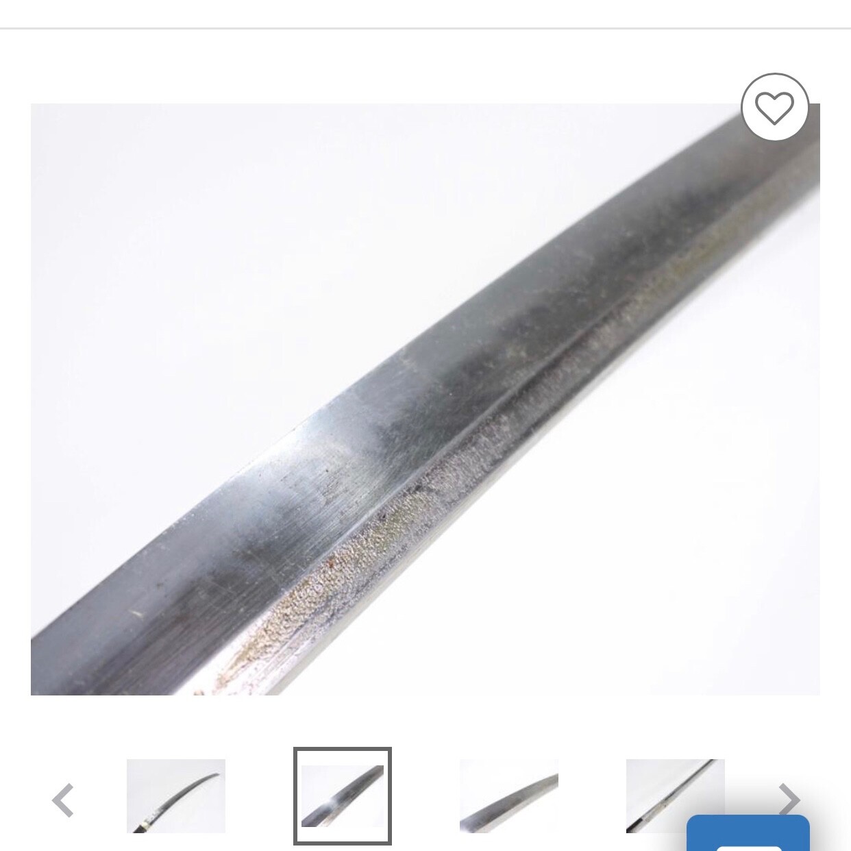

The photos are not good enough to say what the hamon really looks like.

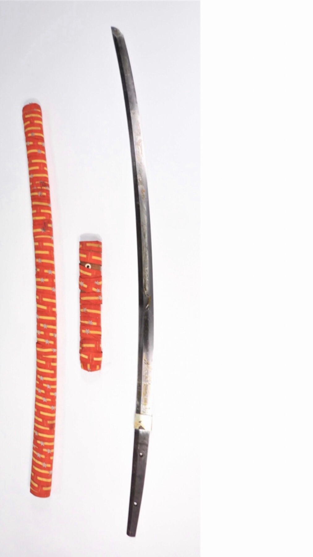

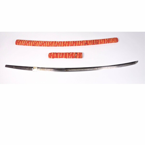

Also, look at the sugata. If the Ichi were genuine this would purport to be an ubu zaimei Ichimonji tachi. The sakizori seems very deep there and you would expect a bit more koshizori at the bottom of the blade.

Again, I can barely see anything here, but a formation like this (denser, uniform choji), one would be looking towards Yoshioka and other later Ichimonji.

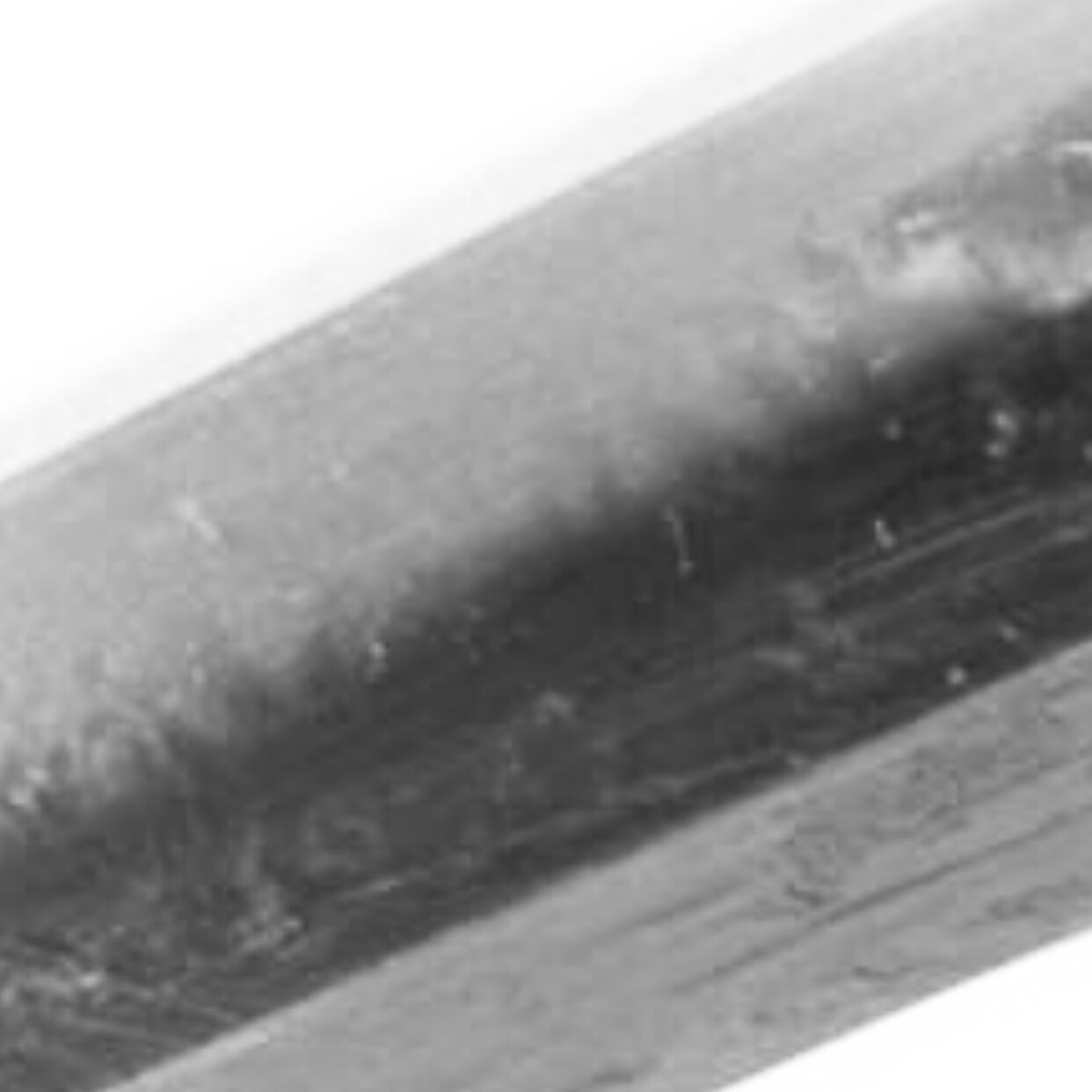

I think this picture shows that this blade is not even close to be that old.
The amount of polishes such an old sword must have would be visible on the Mune.
~1700 would be my guess.
The "Sugata picture" is taken in an angle that make the sori look larger.

Also to add if you look at the two images taken the angle it was photographed will show different effects of how the sori or curve looks from each angle. I do agree with Michael if possible in hand assessment of the blade is best. Others were present I was informed in house as well for blade viewing in person.904F1137-CBEE-49D1-8A72-809F07793EC1.thumb.jpeg.e5db08ffd74f3dbb8219034dbb72f700.jpeg8A6AB505-2D14-4A2A-A768-FAF0CB65D424.thumb.jpeg.b363f5411a1789703d68f3f7ed31c80f.jpeg
Unfortunately I am at a loss re the hammer price is this one. There is a lot of niku in the blade, no strong evidence of midare utsuri, there are no defects... Yes, there are Kamakura blades with no defects - they are TJ as a rule. It is not in polish, but there is very little here suggesting Kamakura attribution.
