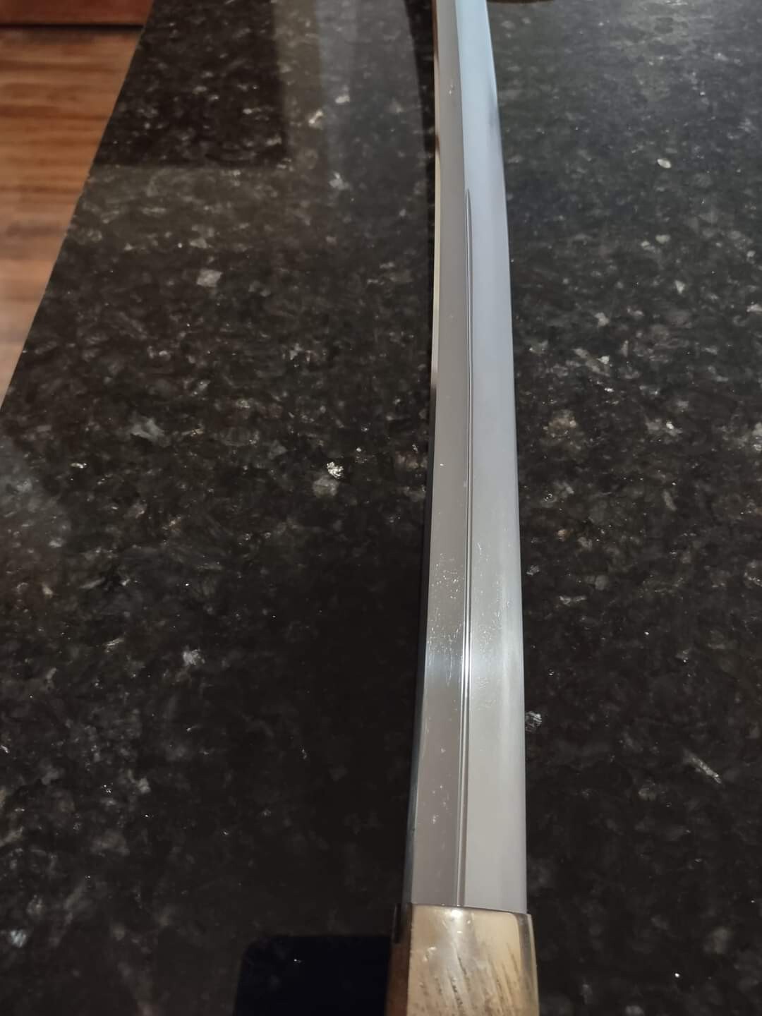

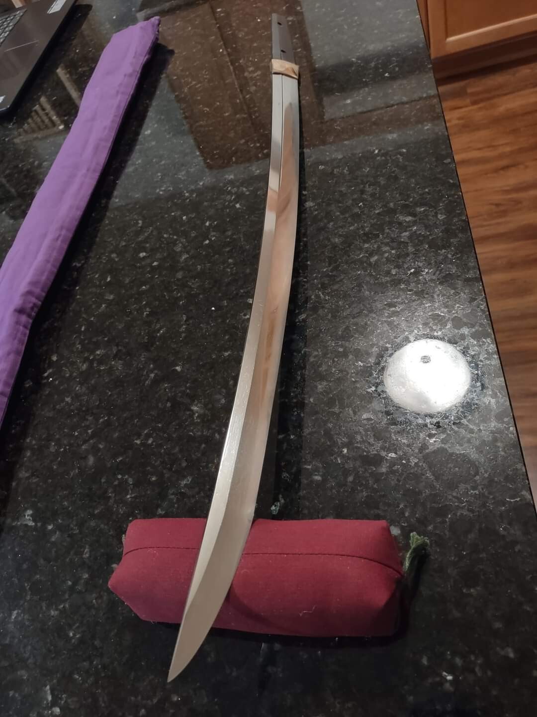

Tengu1957 Posted March 28, 2022 Report Posted March 28, 2022 Nagamaki Naoshi ( cut down pole arm ) Nambokucho Jidai ( 1336-1392 ) O Kissaki typical of this period 57.8 cm NBTHK Tokubetsu Hozon attribution to Kaga Sanekage who worked around 1362-68 Sanekage was a student of Shodai Etchu Norishige ( student of Masamune ) Sanekage works are rated Ryo-Wazamono ( very good cutting ability ) 2 1 Quote
Gakusee Posted March 28, 2022 Report Posted March 28, 2022 Gary, thanks for posting. Could you please post some closer photos of the hada / hamon? It will be interesting to see the chikei and jinie. Tametsugu and Sanekage are the close followers of Norishige and probably there are strong traits unifying their workmanship. Thanks 1 Quote

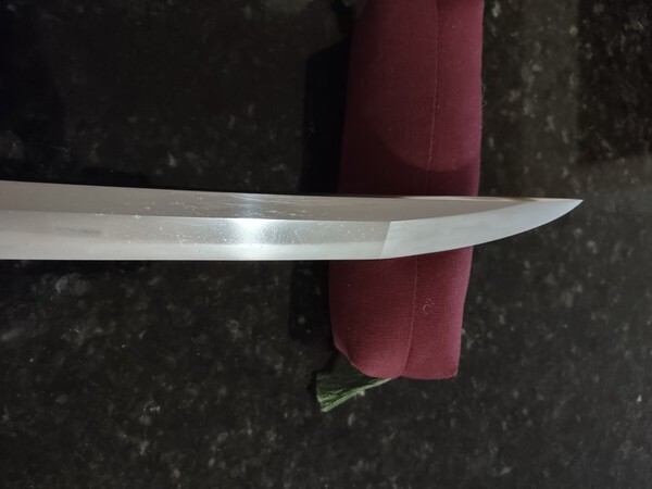

Franco Posted March 28, 2022 Report Posted March 28, 2022 On 3/28/2022 at 9:53 AM, Tengu1957 said: O Kissaki Expand Is it still considered to be an O Kissaki even without the presence of a yokote line? Isn't the yokote line what defines the kissaki? Or am I just not seeing the yokote line in this image? Quote
Geraint Posted March 28, 2022 Report Posted March 28, 2022 Dear Franco. I think perhaps the yokote is at the point where both the ha and the shogi change direction, most visible in the first photograph. You are right, the usual clearly defined line is not evident in the photographs but the change in angle is there. All the best Quote
Tengu1957 Posted March 28, 2022 Author Report Posted March 28, 2022 the O kissaki is more apparent Quote
Franco Posted March 29, 2022 Report Posted March 29, 2022 Thank you for comments and the additional image. Quote
