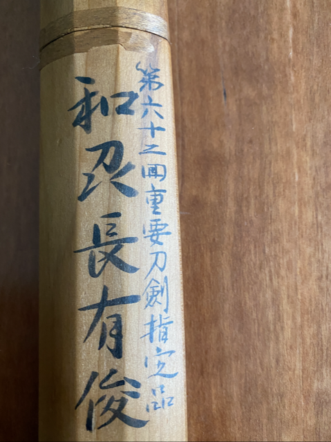

JAL Posted March 27, 2022 Report Posted March 27, 2022 Hi, Nice Taima sword. Although it is stated that Taima is a somewhat rare school, I owned four blades in during twenty years of collecting and two of them attributed to Cho Aritoshi. Currently I still have in my collection a juyo token attributed to den Cho Aritoshi (62nd juyo session) with a sayagaki by Tanobe sensei which translates approximately to: Sayagaki Tanobe Sensei 62th juyo token The Wasyu Cho Aritoshi. This sword is Osuriage Mumei. This sword smith was Taima school’s student, he was a sword smith in the Kenmu era. Hamon is Suguha and Syogunome with deep and thick Nie. Also, Hamon has many Niju- ha and Yubashiri. This sword has a lot of characteristics of Aritoshi and is excellent. Nagasa 2 shaku 2 sun 2 bu Year of the Rooster 2017 best regards, John 5 1 Quote

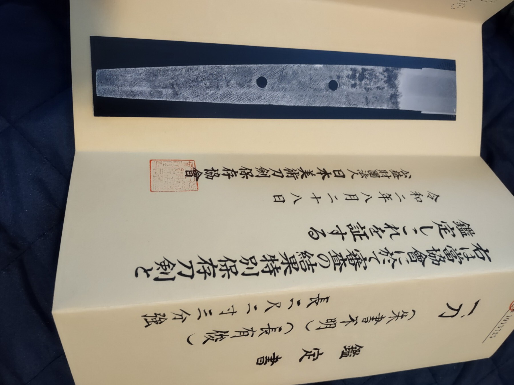

Tengu1957 Posted March 27, 2022 Author Report Posted March 27, 2022 4 hours ago, b.hennick said: 👍👍 Here is Taima #1 paper and #2 sayagaki , I'll get a better image of sayagaki #1 when I am at home next Friday 1 1 Quote
JAL Posted March 28, 2022 Report Posted March 28, 2022 Hi all, here are some pictures of the sayagaki of my Taima. Translation in earlier post. I was not really looking for specifically Taima, but did at that time have a vested interest in Yamato. Still own a TH Kamakura tachi, a juyo Senjuin Yoshimitsu Kamakura tanto and this Taima Cho Aritoshi. best regards John 1 1 Quote

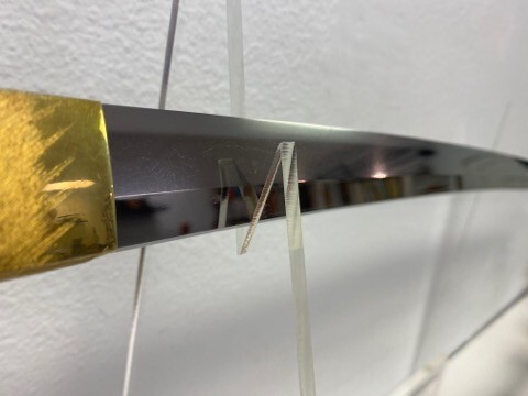

Baba Yaga Posted March 28, 2022 Report Posted March 28, 2022 The 1st photo threw me. Looked like it was almost straight with no sori. I thought may be exception 10,001. Back to the Optometrist. 1 Quote

Rivkin Posted March 28, 2022 Report Posted March 28, 2022 1 hour ago, Baba Yaga said: The 1st photo threw me. Looked like it was almost straight with no sori. I thought may be exception 10,001. Back to the Optometrist. On a very personal note I have to wonder if these are Kamakura per se. They both look like earlish Nambokucho. Quote

JAL Posted March 28, 2022 Report Posted March 28, 2022 Sayagaki of my Taima Den Cho Aritoshi states the smith being active in Kenmu era (1333-1336 so Nambokucho). 1 Quote
Gakusee Posted March 28, 2022 Report Posted March 28, 2022 Yes, you are both right, the masculine sugata, lower curvature and okissaki or rather extended chu kissaki are of course more Nanbokucho. But it is one of these where the blade is +/- five to ten years of the watershed (1333, which demarcates the end of Kamakura). It is not as though these blades are from towards the late/ end of the 14 century 1 Quote

JAL Posted March 28, 2022 Report Posted March 28, 2022 Hi, Setsumei translstion best effort. Description It is said that Aritoshi was a swordmaker belonged to Yamato Taima school and he has two names: one is Aritoshi (有俊) consisting of two Chinese characters and another is Cho Aritoshi (長有俊) consisting of three Chinese characters. The former one can be seen produced in Einin 6 (1298). It is a common theory that mei of Cho Aritoshi (three Chinese characters) shows the second Aritoshi, the era is approx. Kenmu, shortened name of Chobei (no) jo Aritoshi. This sword is that jigane is koitame with slightly nagare masa, thick jinie sticked to pieces, hamon is suguha, kochoji, kogunome, kui chigai ba & niju ba & yubashiri on habuchi, thick nie is brightly saeru, etc, significantly see Cho Aritoshi’s feature on jiba (jihada and hamon) and kiwameno syuko sareru (it is proved as the past authentication.). As Cho Aritoshi’s feature, habuchi is a highlight of niju ba. This sword has strong hanie with Cho Aritoshi’s kiwame, niju ba with thick and condensed nie can be frequently seen on habuchi, hamon is clearly skillful. It is an excellent piece of work. best regards, John 2 1 Quote
