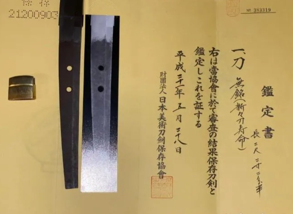

I would like your expert opinion about this katana that sell together with the katanakake and that it would be my first purchase. I have not seen it in person and these are all the photos i have. Indicates edo period XVIII century

Looking at that hamon, Shinshinto is plausible. Torizori sugata with not too deep sori is consistent with the period. You should ask for closeups of the hada, nakago, boshi and photos of the certificate.
You might ask to buy the blade separate from the katanakake, as that doesn't add to the blade's value. And Mike's right that you should get photos of the entire bare blad, nakago, & boshi as a minimum. The origami (certificate) should exactly match the nakago, & it would help to know the translation of the tosho. Clear closeup shots of the hada will show the overall condition.
Bienvenidos!
Looks like a nice package, decent quality with no red flag so far. As mentioned, depends on price and how much you are willing to pay.
Get a guarantee from the seller that there are no fatal flaws.

once cleared with the seller, in other site he has the same katana with more description and pictures
This is the link if you want to see it in detail
https://www.todocoleccion.net/militaria-armas-blancas/katana-japonesa-edo-koshirae-shirasaya-katanakake-edo~x317930523
