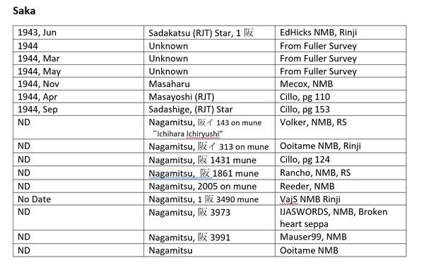

Bruce Pennington Posted March 25, 2022 Report Posted March 25, 2022 Volker, quite a beauty! No date I presume? And those stamps! It's the first blade I've recorded with both a 阪 Saka and a イbefore the number! All but one (now 2) of the blades I have with these kanji are Nagamitsu. The other one was a Sadakatsu blade. Anyone know what prefecture Ryushi was from? Nagamitsu was Okayama and Sadakatsu was Osaka. So this イstamp must be an arsenal inspector or something. Also, backs up the idea that these mune numbers are Arsenal numbers not fittings shops. 1 Quote
francois2605 Posted March 25, 2022 Report Posted March 25, 2022 Bruce, Nagamitsu = "Ichihara Ichiryushi Nagamitsu" as per http://www.japaneseswordindex.com/naga.htm Quote

Kiipu Posted March 25, 2022 Report Posted March 25, 2022 The nakago mune markings of 阪 イ143 are the Ōsaka Army Arsenal final inspection mark followed by the arsenal assigned serial number. In this case, it a 1st イ series and not that of the proceeding 0 (zero) series. These markings are common on Ōsaka swords but are rarely mentioned or photographed. I am unaware of anyone seriously studying these swords like the Mantetsu swords are. I briefly touched upon this subject in the thread below. Stamp Survey 1 Quote
Bruce Pennington Posted March 26, 2022 Report Posted March 26, 2022 On 3/25/2022 at 1:37 PM, francois2605 said: Bruce, Nagamitsu = "Ichihara Ichiryushi Nagamitsu" as per http://www.japaneseswordindex.com/naga.htm Expand Thanks Francois! That clears that all up. On 3/25/2022 at 6:32 PM, Kiipu said: I am unaware of anyone seriously studying these swords like the Mantetsu swords are. Expand I track them when I can find one. They just don't seem to be as common as Mantetsu, Showa-stamped, or Seki-stamped blades. I'd be glad to cover them in more depth if we can find them! Quote
BANGBANGSAN Posted March 26, 2022 Report Posted March 26, 2022 This Nagamitsu has nakago mune markings 阪 2511 1 1 Quote

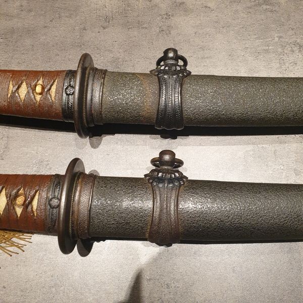

Volker62 Posted March 27, 2022 Author Report Posted March 27, 2022 stamp on a Gunto Typ 3 sayahanger/ Ashi. pictures shows two shin gunto Typ 3 sayahanger/ashi on the top one is a small stamp on it. perhaps someone knows about the meaning Quote
Kiipu Posted March 27, 2022 Report Posted March 27, 2022 (edited) On 3/27/2022 at 7:01 PM, Volker62 said: Stamp on a Gunto Type 3 saya hanger/ashi. Expand Rotate the picture 90 degrees clockwise and one will see an Ōsaka 阪 final inspection mark. Edited March 27, 2022 by Kiipu 1 1 Quote
Bruce Pennington Posted March 27, 2022 Report Posted March 27, 2022 OK! First Saka stamp I've seen on a haikan (ashi)! Quote
Volker62 Posted March 28, 2022 Author Report Posted March 28, 2022 Like Bruce I see it for the first time! Intetesting what everything was provided with an acceptance stamp....like in Germany 1 Quote
IJASWORDS Posted March 28, 2022 Report Posted March 28, 2022 Bruce, most people miss seeing the stamps, being small. Fairly common, see one of mine. 1 Quote
rancho Posted April 5, 2022 Report Posted April 5, 2022 My Nagamitsu got the same stamp on ashi 2 Quote
