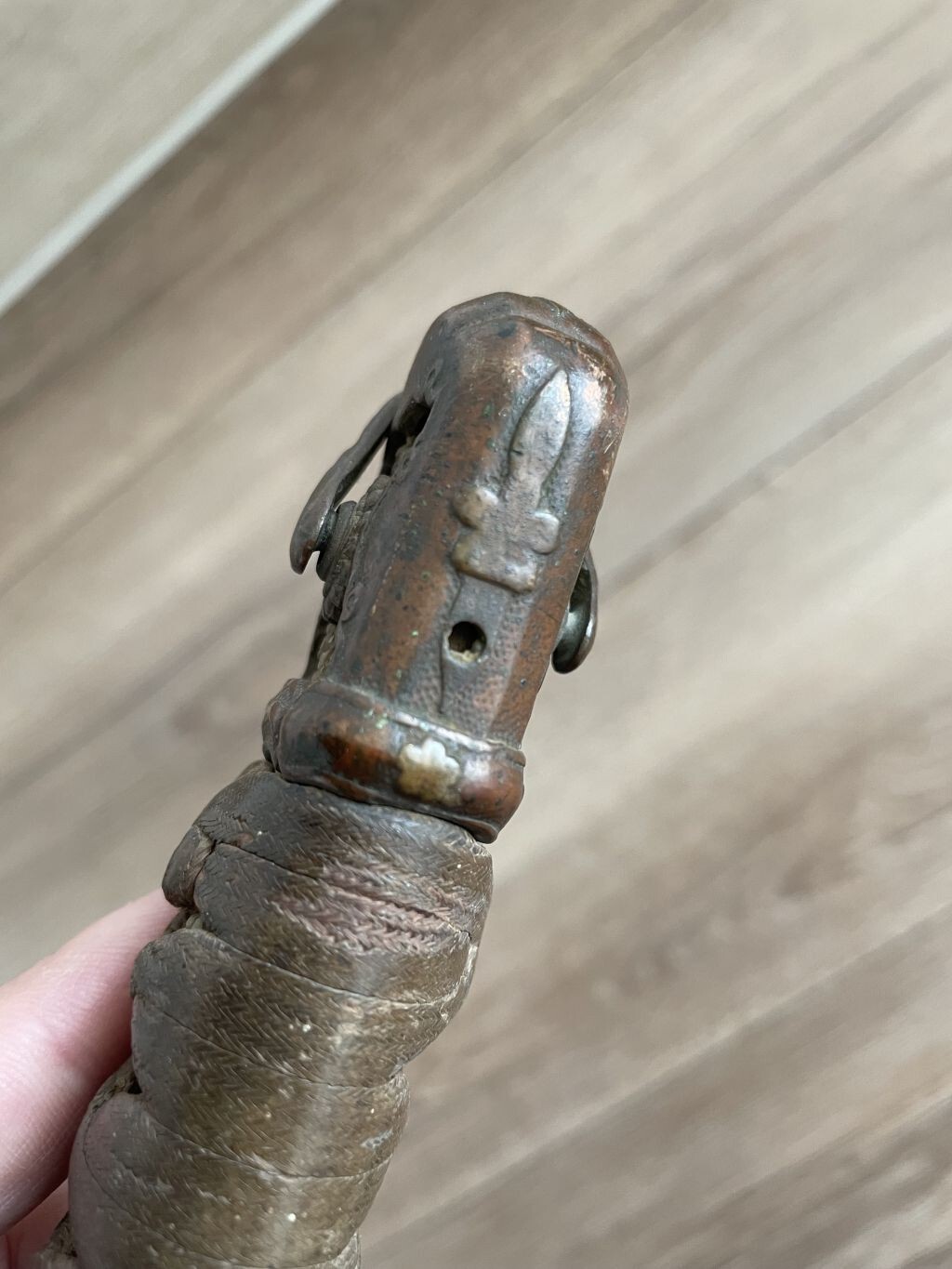

few days I bought this poor conditioned officer sword which was not storaged very well. Despite these fact, sword is still nice. Very carefully I removed wooden grip and find markings on both sides of blade tang. I know there is a lot of rust, but I do not decide to clean it, because I don´t want to damage it. Please can anybody help me with translating the markings - I mean blade smith or maybe date, when it was produced. Each part of sword have same number "87" and one seppa is missing - but when I carefully inspect the sword, l think, it was never on sword, or was lost very, very long time ago, because sword fits tight and very well and patination on tsuba is just around other seppas. Mon on pommel is also missing :(

Take a wooden spoon or like object. Tap nakago untill red bubble rust falls off ...take a old T-shirt and lightly oil it. Wipe down change fold repeat until no more red rust show's on T.
When you have a nice dark patina... you'll know you have saved the nakago from being eaten up.
You can oil the blade the same...diff T....wipe up change fold repeat until you have a light film...no droplets.
Good project ther.
PS put some white paper on table. Tap light the saya. Opening down...see if debris falls out keep doing until it stops you don't want to put a oily blade back in to pick up grit and grime.

Just did similar on those 2 matchlock guns of mine, on the underneath of the barrel where rust was thick and stood proud. Works well. I used a light brass hammer, and light tapping. Rust flakes off. Go slowly and carefully
Sometimes you can slide the saya liners out.  You remove the saya opening cap, and you'll see the liners.  Some are loose enough to pour/slide out.  Others, for some reason are really stuck and can't be removed.  But if yours will come out, you can clean the inside of rust, grime, and other crud.  If not, Stephen's method is better than doing nothing.
 I have used a .177 air rifle cleaning rod to wipe/scrub inside saya before now. Not ideal but better than nothing if you cannot remove the liners.
