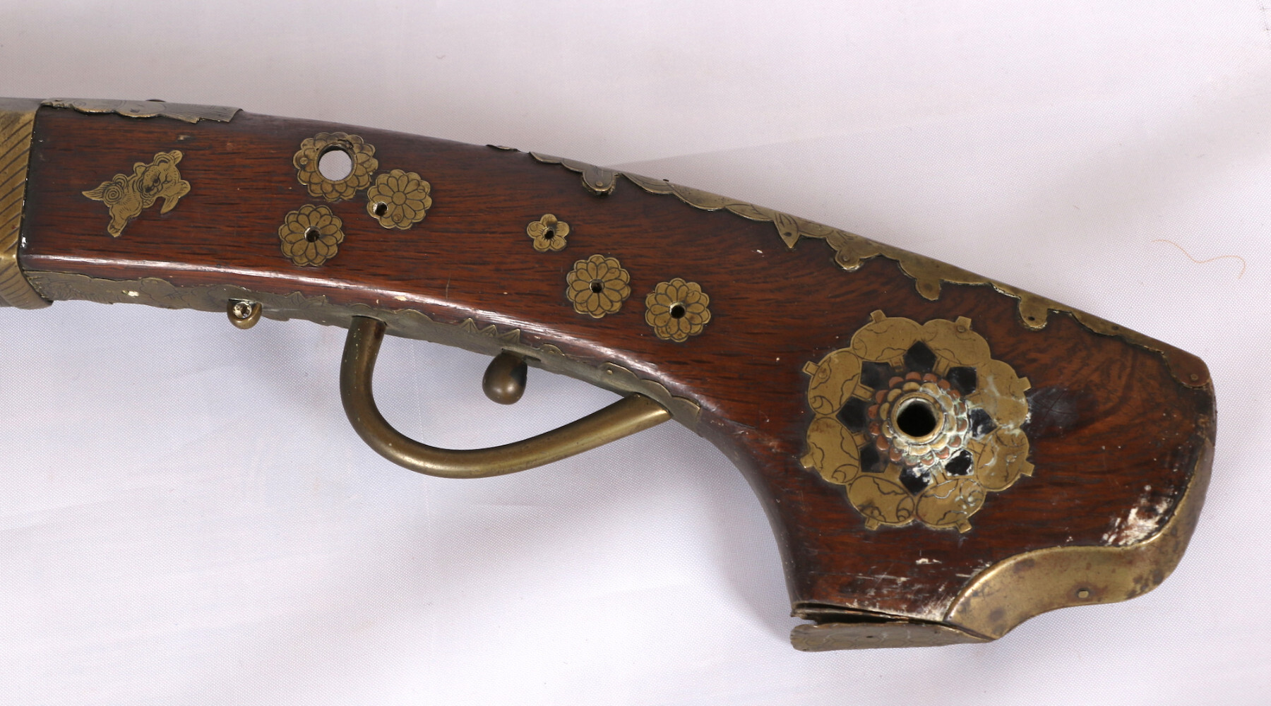

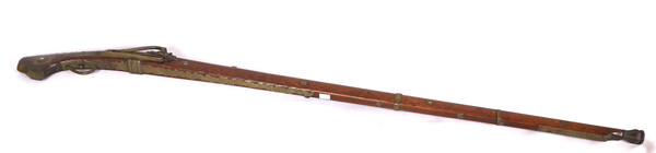

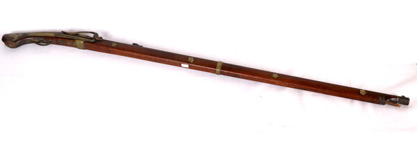

One very generic....very similar to one I have. And missing the pan cover, amaooi and wedge. i find most matchlocks are missing some parts.
Condition is fair...flash hole is open. Haven't stripped it yet, they've just arrived and sitting on my office table. But I am hoping  (and guessing) it's signed. We shall see. Likely sell it to help pay for the other.

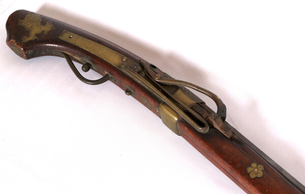

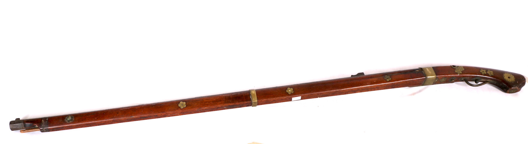

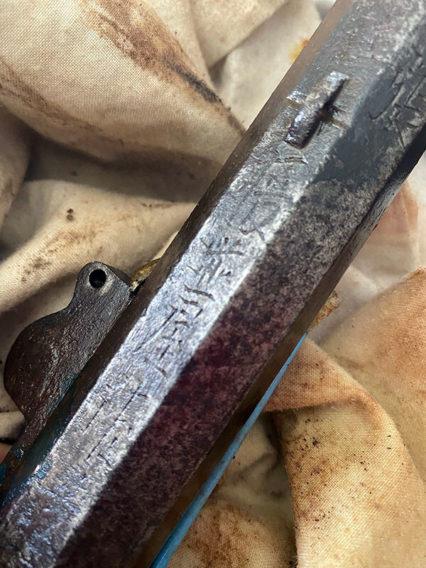

The other is a gem for me. Sakai matchlock from what I have learned from Piers' posts, with onion shaped muzzle. Complete with pan cover, amaooi, wedge etc. Both function well. Bit of loose brass sheet to pin down, but nothing serious.

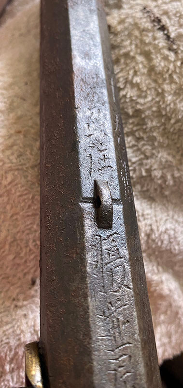

Have taken the barrel off, LOTS of rust under, but I'll do some gentle TLC. Can see a signature. Interesting that this one is round on top of the barrel all the way.
And octagonal (well, HALF of octagonal) underneath.

Anyways, pics of the first one here, and of the second one in a reply. Quite chuffed to dig up stuff that I didn't think was floating round South Africa.

Pier, pics of the mei on the onion-muzzle presumed Sakai.
Rust prevents the viewing of some of the kanji, others are visible. Hoping you can make some of it out. 3 Kanji on one flat, and a row on the other.
Don't want to overclean, so just oiling and wiping. As expected, bisen appears stuck. *sigh*
Thanks anyone for any info on the kanji.
Yes, Brian, 半巻張 which suggests an older gun to me.
The smith is one of the Enamiya House in Sesshū. (I’m just working on his individual name.)
摂州住榎並屋…. 作兵衛(?)
There were at least 120 Enamiya gunsmiths, but that last name is so faint. I’m guessing it’s one of these or a close artisan.

I have some more pics of that mei below.

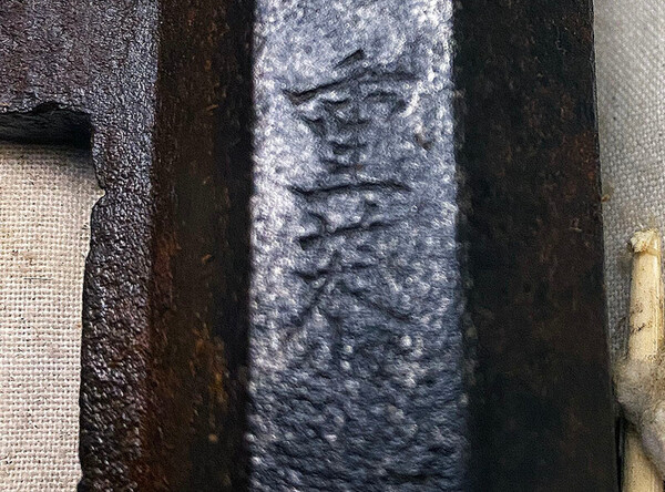

And then after that, another post with the second one. Both have mei, and I am VERY happy to report that both bisen are unscrewed and good. Finally guns that are not stuck. A heat gun and oil were a huge help. Heat gun most of all.
Here's the second gun. Bit less rust, but missing pan cover and guard. Oneday I'll tackle making one of each.
Hopefully mei is legible.
Thanks in advance Piers and anyone else.
Your second gun is from Kunitomo, Brian. Interesting for a couple of reasons. *Kunitomo Tōbei was a famous smith line. (See photo of 20 Tōbei smiths with a personal name beginning with Shigé…)
As to 巻張 makibari it is how the steel barrel was fashioned.
(to be cont.)
A metal band was wound around the barrel for extra strength. When the process was in its infancy it was wound only once, on half of the barrel from the chamber end for strengthening. That is what your Sakai gun proclaims, a ‘half winding’, Han-makibari 半巻張.
As this became standard, a double full-length helix or 二重巻張 Ni-jū makibari was the least that customers wanted. As written in your Kunitomo barrel, on a facet to the right of the Mei.
Later in Edo a third twisting was added for extra strength, in most cases described as 総巻張 Sō makibari, or overall/complete twisting/binding. (Although I know of one exceptional large gun that actually specifies 三巻張)
Gō-Shū Kunitomo Tōbei Shigé…+ X
Is he listed?
Thanks Piers, that's a big help.
Few possibilities there. I'll try and examine the mei more to see which one. Possibly #1 or #11 down...Hmm.
Brian, I would need to devote some time to breaking that one. I see elements of 菜 (na) and 采 (sai) and/or 添 (soe/zoe/ten) in it. (?) Not every smith name is recovered, though. Few dates for Tōbei smiths are noted. The ballpark likelihood is first half 1800s.
