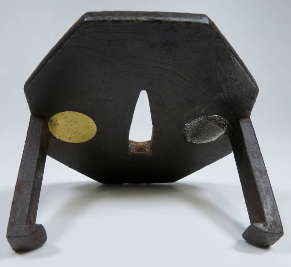

Can anyone tell me what this object was used for? It has similar 'prongs' to the tsuba in this thread - but three rather than two.
The original Japanese is 《氷》南部鉄器 鈴木盛久造 鉄製 五徳 蓋置 共箱 (検) 鉄瓶 鉄壷 初荷 骨董 古玩 古美術品 古道具 H61
https://www.jauce.com/auction/o1038455926  Nambu tekki - something to do with making tea or for tea ceremony?
A bit of Googling for Gotoku Futaoki brings up this (see image) but Nanbu tekki is kettle, so perhaps a kettle stand?
Jon
Yes, these come in various sizes. Usually cast iron.  I searched for what seemed like ages to find an old one, and having reluctantly bought a new one then discovered a nest of antique ones.
That little one however is being used as a decorative stand for the e-shaku dipper.
The word 五徳 Gotoku itself is interesting as it contains the meaning of ‘five virtues’. Recently I saw a double-yoker shaped with two semi rings and five legs. You bury the legs in the ash and place your iron kettle on top.
Thanks Jon and Piers, so two legs, [prongs] would not work for the same purpose. The red 'coral' or 'enamel' wouldn't last in a fire either.
I think I can cross that off my list. Thanks for your insights and research.
