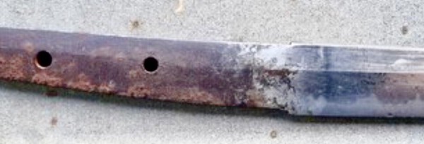

Hi, hopefully I am not out staying my welcome,  I just have a question about my second blade,  I see wavy lines that I assume is the grain ? I also see a hamon, would this be a WW2 blade made by hand ?
Probably someone late, shinshinto or later imitating Hosho. Pure masame, high contrast, very uniform like drawn lines and absolutely no ji nie - very late work.
