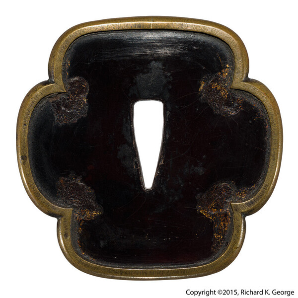

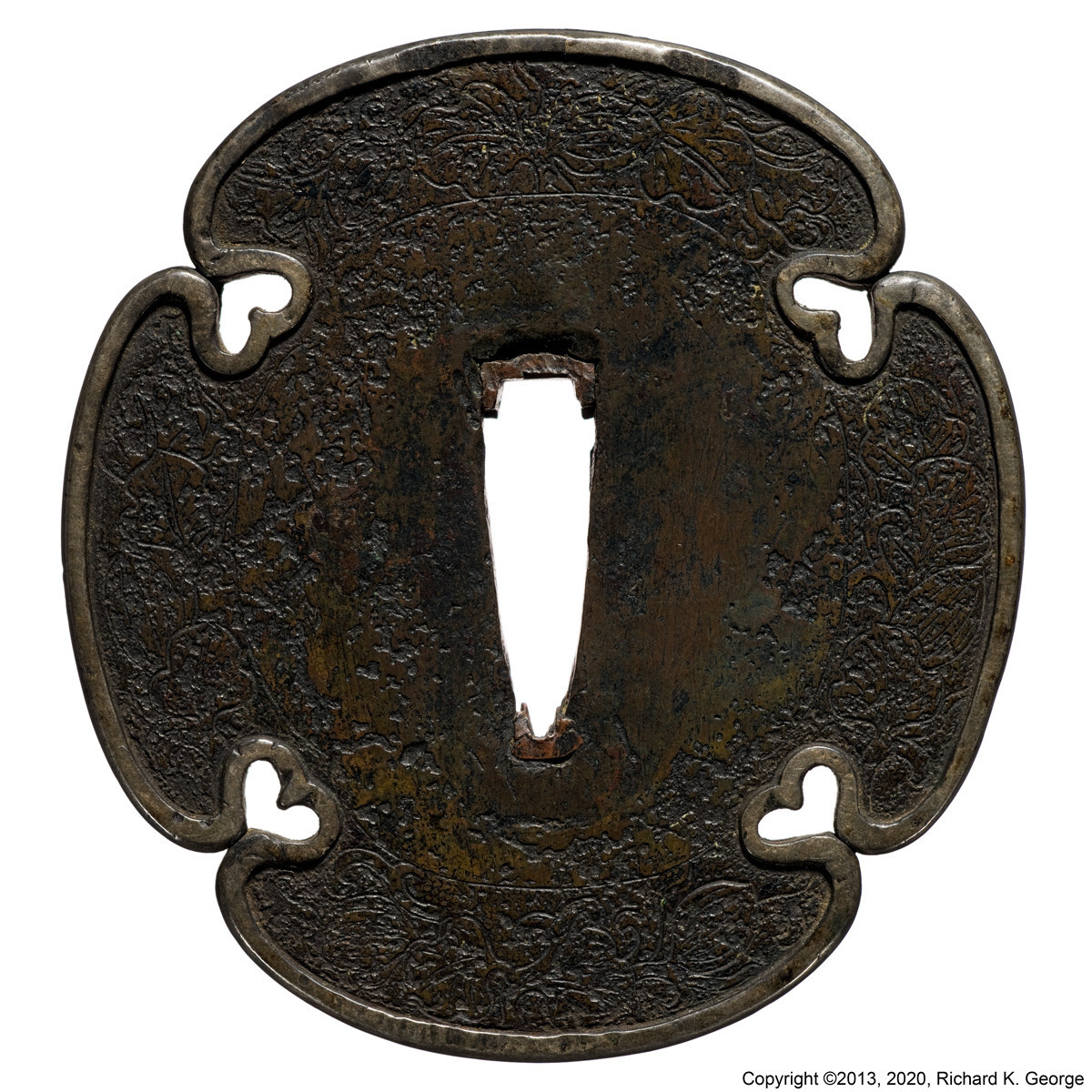

and... and the really old ones often weren't that big.  I don't currently have any of the archaic (shitoji) pieces, but here's a examples of other styles:
kamakura period:
Nambokucho-muromachi period:
