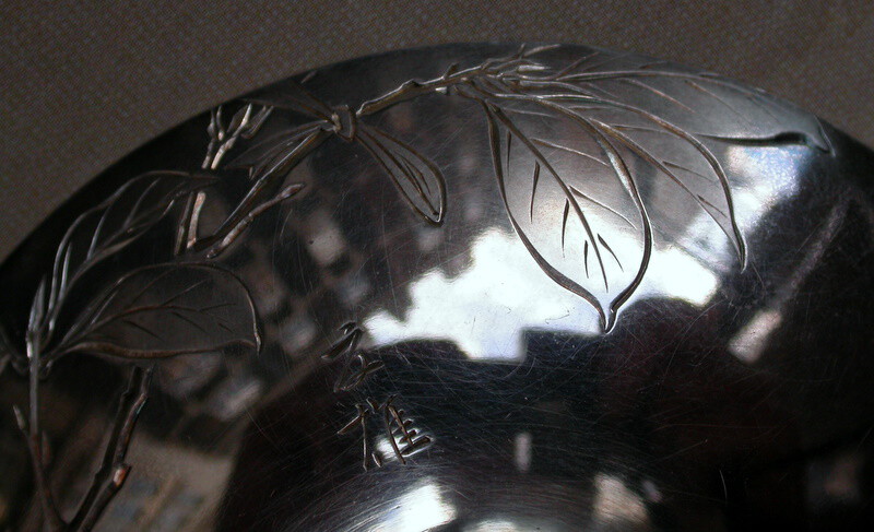

Marc BROQUIN Posted March 12, 2009 Report Posted March 12, 2009 Hello all, I post this tsuba for its spectacular carving. I cannot decipher the kanjis but I am sure many of you will be able to give their ideas. kind regards Marc Quote

Nobody Posted March 13, 2009 Report Posted March 13, 2009 This is only my guess about the mei. I am not sure about several kanji including 夏 and 鎬. 寛齋夏雄 鎬 (Kansai, Natsuo, ?) I cannot understand 鎬 in that context. There was a painter whose name was Mori Kansai (Ref. http://edb.kulib.kyoto-u.ac.jp/exhibit/ ... /Mori.html ), although I do not know if he is this Kansai or not. 慶應四戊辰 (Keio 4 Tsuchinoe-Tatsu) - 1868 初夏 (Shoka) – early summer Quote
John A Stuart Posted March 13, 2009 Report Posted March 13, 2009 A wonderful tsuba. Koichi san, may I suggest that the kanji after Natsuo is not Ko, shinogi 鎬, but, instead the kanji Sen, ho(ru), for engrave, carve, chisel, sculpture, inscribe. Ref # 6349, J6f43, M40924. Meaning carved by Natsuo. I can't access this kanji to print it here. John Quote
Markus Posted March 13, 2009 Report Posted March 13, 2009 Yes, John you are right. The character is: 鐫 BTW: Kansai (寛斎) was one of Natsuo´s pseudonyms. Quote
Nobody Posted March 13, 2009 Report Posted March 13, 2009 John A Stuart said: ..... , but, instead the kanji Sen, ho(ru), for engrave, carve, chisel, sculpture, inscribe. Thanks John, I have learned the kanji today. Quote
Eric H Posted March 13, 2009 Report Posted March 13, 2009 A very fine Tsuba, and if it's shoshin Natsuo :D Eric Quote
John A Stuart Posted March 13, 2009 Report Posted March 13, 2009 I still find this tsuba appealing, but, don't hate me, of the 26 or so signatures by Natsuo I am looking at none match in critical ways. The 夏 natsu kanji in sosho form does not match. There is no mei recorded that ends in 鐫 ho. He was 40 when this was made and the mei should be well in line with others. Now, I am just a student and my opinion has little weight, so, I await other judgement. Quote

Marc BROQUIN Posted March 14, 2009 Author Report Posted March 14, 2009 "Hello all, I post this tsuba for its spectacular carving. I cannot decipher the kanjis but I am sure many of you will be able to give their ideas. kind regards Marc" Hello all, When I wrote those words, I must say that I had some ideas "behind my head" as we say in french. I was nearly sure it was not from NATSUO because the carving had not this natural mixture of simplicity and complexity of NATSUO (Reinhard is right, workmanship doesn't fit). I was sure also that the 3rd kanji was O; the same O that appears in Natsuo. it was a track for me. Who is able (by tradition) to use a part of the master name : one of his students. So I checked yesterday with all your information you gave in the different answers and found : As far as my research is complete the only student having taken the O from Natsuo and having a simple kanji for the begining is ...... FUMI O (the FUMI equivalent to BUN in BUNSEI) in other words SEKIBUN III, who was a student of NATSUO and having taken this name FUMI O. And there is at the end of the book related to NATSUO a tsuba made by FUMI O with this signature KANSAI (which was one of the artist "family" name of NATSUO) FUMI O. Of course this signature being relatively rare, and fitting partially with this one of the Natsuo book, I cannot say it is shoshin. But I have the impression it is because of the quality signed by a "second gun" artist and not by the master. I let those comments to your appreciations. Anyhow and it is true : what is written on the reverse ? Perhaps Koichi San could give us the solution ? Kind regards to all Marc Quote
Marc BROQUIN Posted March 14, 2009 Author Report Posted March 14, 2009 Hello all, Sorry for the obverse you deciphered Koichi San. I think I was a bit sleepy ! I checked this morning on the Haynes and it is said that SEKIBUN III born in 1869 worked with NATSUO around 1885. It does not fit with the date : he was not born !!! What else ? best regards Marc Quote

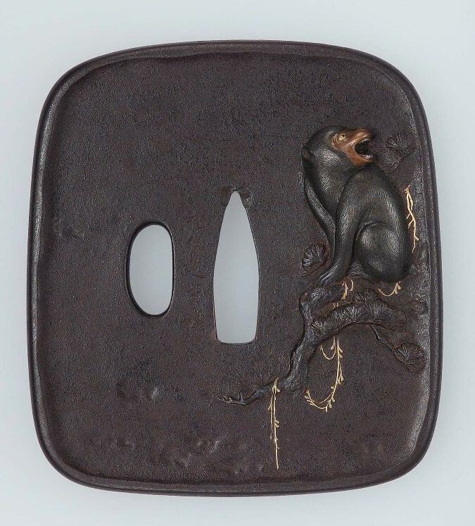

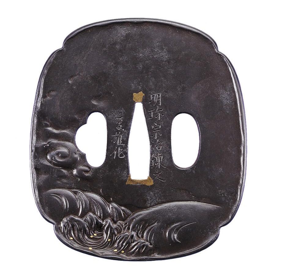

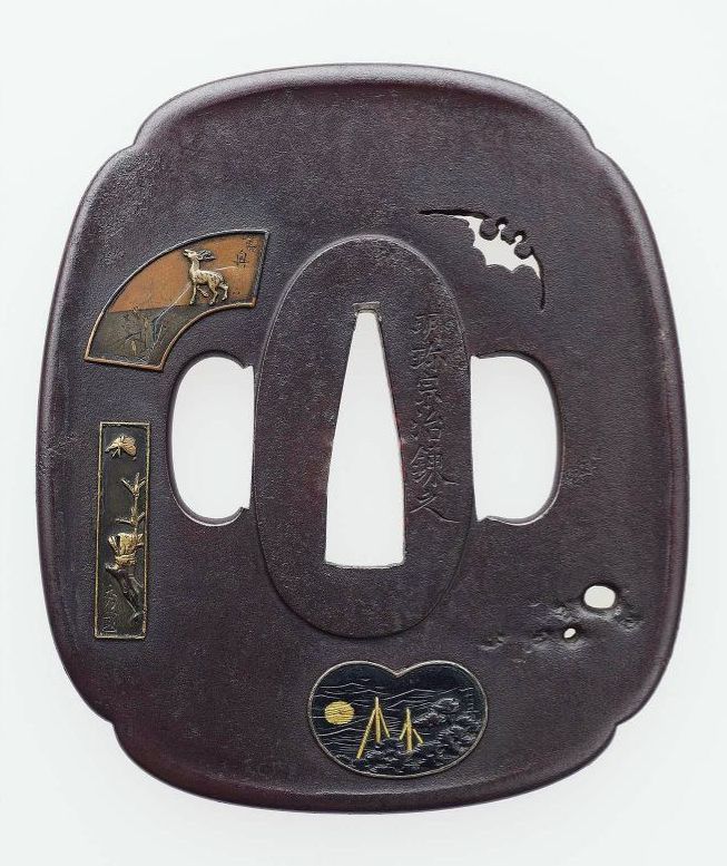

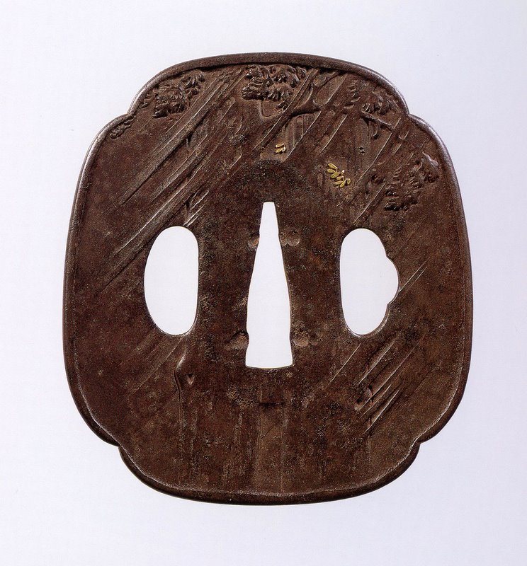

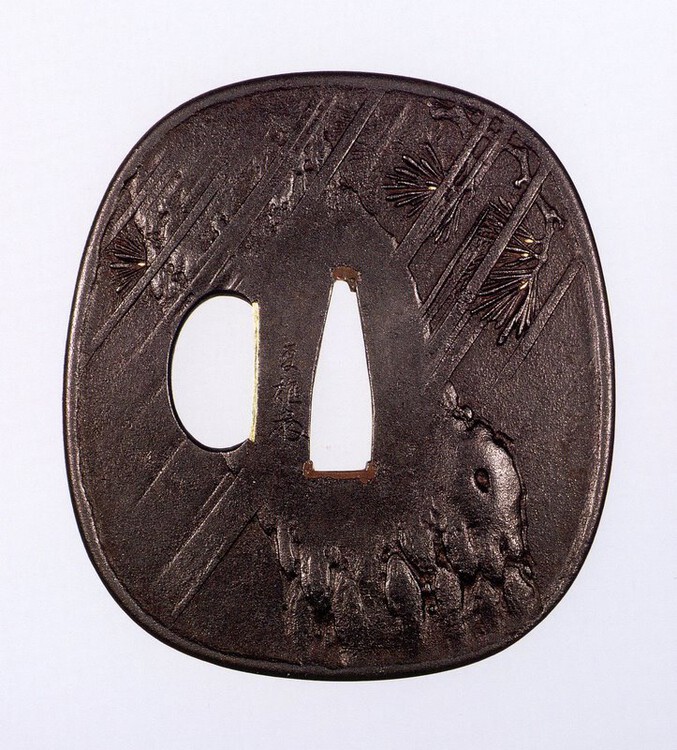

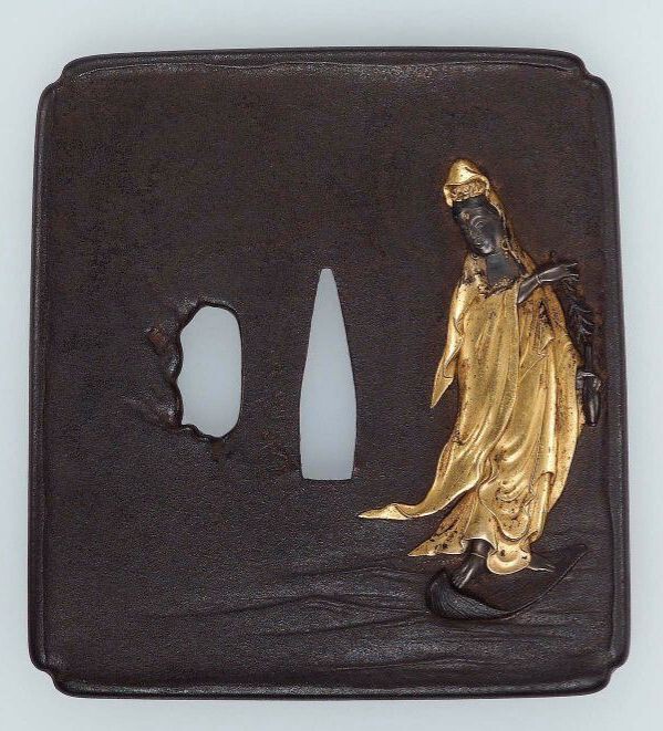

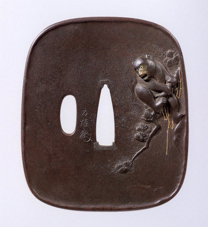

Eric H Posted March 14, 2009 Report Posted March 14, 2009 For comparison 4 Tsuba by Natsuo - Museum of fine Arts, Boston Eric Quote
Ford Hallam Posted March 14, 2009 Report Posted March 14, 2009 hmmm...interesting comparison with the Boston museum examples. However, it remains to be seen which, if any..., are ultimately appraised as being by Kano Natsuo My immediate doubts would centre on the copper one and the last, the Kwannon. The tsuba with the various panels is, to my knowledge, generally accepted as genuine but the monkey, while sharing some similarities with examples by Natsuo in the Tokyo national museum, seems a bit uninspired to me. Quote
reinhard Posted March 15, 2009 Report Posted March 15, 2009 Agree with Ford, The tsuba with several panels has a good chance of being genuine. (BTW, the others weren't mentioned in Ogawa Morihiro's book, for good reasons, I guess). The "screaming monkey" tries to meet western expectations during early Meiji-period and is lacking NATSUO's grace and dignity. The copper tsuba is an uninspired display of mere craftsmanship, slightly out of proportions and without NATSUO's unique view on a subject. This can be said of the Kwannon-design tsuba even more. reinhard Quote

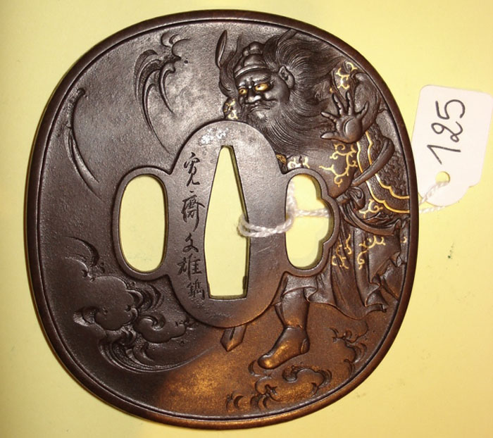

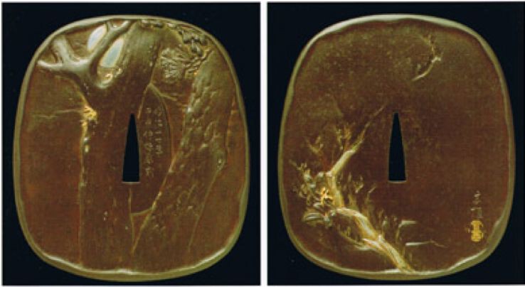

Eric H Posted March 15, 2009 Report Posted March 15, 2009 I have found in my library the following pictures, unfortunately of poor quality. Do these examples represent at best the workmanship of Natsuo ? Eric Quote
Ford Hallam Posted March 15, 2009 Report Posted March 15, 2009 Hi Eric the first one might well be genuine and this is one I've not seen before. It's hard to say for sure based on the image though. It's very similar in treatment to a particular style of work of Natsuo's that I personally find very appalling and is a mode of expression that he did far better than anyone else, imo The moon has been over-cleaned though so this gives the piece a rather harsh aspect... The second one is much harder to judge but from what I think I can see of the lines of the waves it appears to be a bit awkward so I'd suggest not by the man. As for the third piece, the kagamibuta with the frog. Absolutely no chance whatever that is genuine...it's fairly generic work, technically competent but not much more than average craft. Certainly not an example of Japanese metal art. Quote
Brian Posted March 15, 2009 Report Posted March 15, 2009 Ford Hallam said: It's very similar in treatment to a particular style of work of Natsuo's that I personally find very appalling... Ford, Knowing your love of Natsuo's work..I am pretty sure you mean appealing. Brian Quote
Eric H Posted March 15, 2009 Report Posted March 15, 2009 Hi Ford Thank you for your opinion. It is of course almost impossible to give an accurate judgment based on indistinct pictures. In any case, all examples are genuine Natsuo. The first Tsuba is in the gallery of a Japanese seller, who is well known for his top class items. A deeper search in my library revealed much better pics of the second Tsuba, it's an extremely fine work by Natsuo and was designated Juyo Kodogu in 2000. In 2004 at Christie's, Estimation 60,000-65,000 GBP. The Lot was not sold. On the other hand Natsuo occasionally made plates for Kagamibuta. This is ex Bushell Collection. Eric Quote
Ford Hallam Posted March 15, 2009 Report Posted March 15, 2009 Thanks for those additional pics, Eric. The front seems reasonably well done, not fantastic though, the dragon is quite weak in my opinion. The claws in particular lack any sort of feeling of power, they're just spikes. The back is as I surmised and the mei is not at all convincing. As for Juyo papers, I prefer to trust the evidence my eyes provide...and perhaps so did the bidders at that auction. If you consider the way the waves are carved on the back, where they splash, it is not well thought out at all. Natsuo never made mistakes like this. You are right about Natsuo making kagamibuta...but this is most definitely not one of them. As I said, this isn't even a particularly inspired bit of craft-work. Just have a closer look at the legs of this unfortunate creature...there is no real modelling there at all. The kebori is also only just competent....while Kano Natsuo was possibly one of the most sensitive handlers of the chisel ever. But of course I suppose we'll have to agree to differ in our estimation of what constitutes the work of one of the greatest masters in this art form. This is a genuine Natsuo kagamibuta that belongs to my friend Mr Ikeda Nagamasa, the togishi. His father was a leading authority on Natsuo and his family still retains a very impressive collection of Natsuo's work. There is a very similar one in the Boston museum of Fine Art. and this is greatly enlarged view of a portion of kata-kiri by him on a silver sake cup. The piece you see is about an inch across ( 25mm ) and sake drunk from this cup somehow tastes extra nice :D ...I know Hey Brian...thanks for catching me :D , I really must stop dropping those e's Quote
Eric H Posted March 16, 2009 Report Posted March 16, 2009 Ford I agree your reasoning relating to the Kagamibuta's, the differences are obvious, it's like day and night. As for the Juyo-status..... as far as I know there is a panel of (how many people ?) recognized, competent Japanese experts, who are deciding on the status of an art object. It is also well known, the barrier to get over to receive Juyo is very high, for swords and kodogu. Speaking for myself I have full confidence in the wide knowledge and expertise of these gentlemen, and it's my definite belief, that only a handful "Westerners" come close to these Japanese connoisseurs. But everybody feel free to have a mind of one's own. The Lot was most likely not sold because it had an unrealistic estimate : $ 111,000-120,000 DEGUSTIBUS NON EST DISPUTANDUM Eric Quote

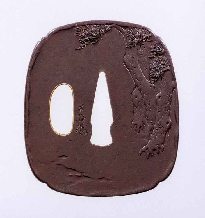

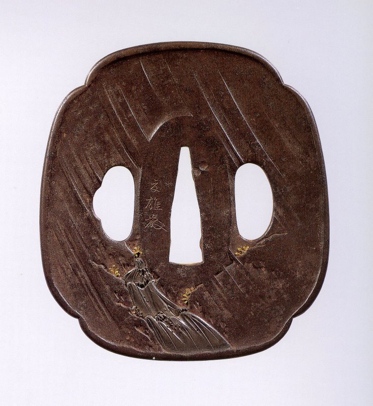

Ford Hallam Posted March 16, 2009 Report Posted March 16, 2009 This last one might give a little idea of how he tended to treat waves and splashing water. These examples are taken from one of the most recent publications on his work and is beautifully illustrated, hence these very clear images. Please bear in mind also that the images you see are generally more than twice the size of the actual pieces themselves. I hope they serve to show a little of why he is considered to be such a great sculptor in metal. Quote DEGUSTIBUS NON EST DISPUTANDUM “The critic has to educate the public; the artist has to educate the critic.” Oscar Wilde :D Quote
