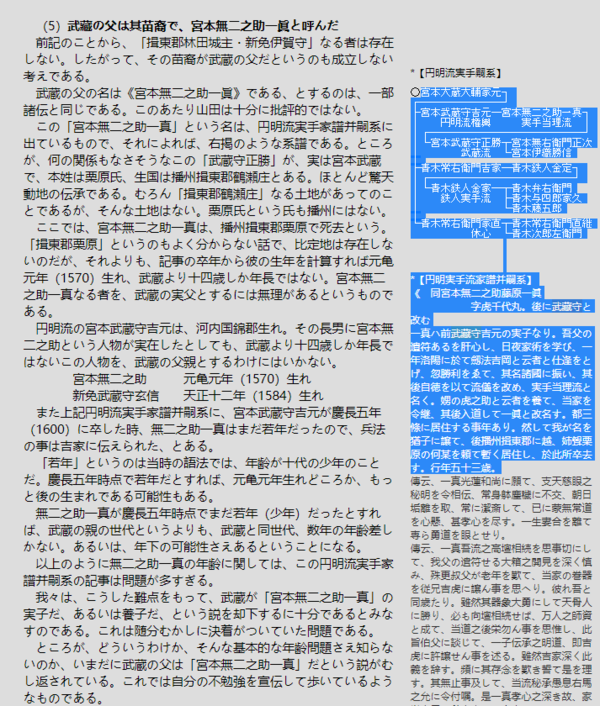

SteveM Posted February 25, 2022 Report Posted February 25, 2022 Hello Yanchen, For #3 and #4, I refer you to the Musashi research site below source: http://musasi.siritai.net/ref/t01.html#n04 In particular, this part; このとき、職人としての武芸者の家職ということに留意すれば、その職名も相続するわけだから、武蔵の「新免武蔵守」という職名も、無二の「十手の家」の職名だったようである。 ...At this time, keeping in mind the family business was "swordsman", the business name was also inherited, and therefore the business name of "Shinmen Musashi-no-Kami" was apparently also the business name of Muni the "Jutte Master" (nb. Musashi's father) But also want to point your attention to this bit 周知の如く武蔵が名のった職名は、『五輪書』では「武蔵守」である。これについて、武蔵は不当にも大名が名のる「武蔵守」を僭称したとの愚かな錯誤を申し立てる論者が後を絶たないが、それは無知によるものである。「武蔵守」は職名の一つであり、職人ならこれを名のったのは、上記の「○○掾」の例と同儀である。 As is well-known, at the time of the Book of Five Rings, Musashi's working name was "Musashi-no-Kami". Regarding this, there is no end to the debaters who try to make the foolish, mistaken claim that Musashi was pretending to be like a Daimyō who calls himself "Lord of Musashi", but this is a view borne from ignorance. "Lord of Musashi" was a working name, and using this name was the same as the working name of "XX-no-Jō" as mentioned above. And, the Book of Five Rings was written well into the Edo period (1640), which, by reference to your point #1, should be an unlikely time for people to make up titles. 2 Quote
WulinRuilong Posted February 25, 2022 Report Posted February 25, 2022 8 hours ago, SteveM said: このとき、職人としての武芸者の家職ということに留意すれば、その職名も相続するわけだから、武蔵の「新免武蔵守」という職名も、無二の「十手の家」の職名だったようである。 I read this article, but this statement has no evidence. I think this is an incorrect interpretation of the inscription(父新免号無二為十手之家武蔵受家業朝鑚暮研) 父新免号無二為十手之家武蔵受家業朝鑚暮研= His father Shinmen Muni is a Master of Jutte(十手),Miyamoto Musashi learned the skill of Jitte and practiced every day. There is nothing related to the family business or business name. In fact, the author misunderstood the words(十手之家) as swordsman family. The correct translation of 十手之家 should be Master of Jutte. Also, there is another article says one record show that Musashi's father is 宮本無二之助 who claimed to be Musashi-no-Kami. But according to this record the title Musashi-no-Kami is only used in a few members of the Jutte school, so it is not a family business name, and it is contradicting other records.(Well, I read all articles on that website. Some authors claim that Shinmen Musashi no Kami is the business name of the Shinmen Muni's family, but they fail to provide directly evidence. This is the only record says 宮本無二之助 also known as Musashi-no-Kami武蔵守) In sum, if you believe that the title Musashi-no-Kami is a family business name (actually this is also a kind of self-proclaimed courtesy title) which is also used by Musashi's father. Then you have to assume that 宮本無二之助 and 新免無二 are same person. If so, you have to recognize a lot of conflicting records (So it is very unlikely to be true). And even Musashi and his father both used the title Musashi no Kami as business name, it still a proclaimed courtesy title since it is not recognized by the Imperial court. Also, there is no clear line between later Sengoku period and early Edo period. Musashi was born on later Sengoku period, so he still keeps old tradition of claiming a proclaimed courtesy title. Anyway, since you already noticed that people in Sengoku period do use some courtesy title like XXXX no Kami as their business/office name without permission, you should aware the courtesy titles like XXX no Kami on the sword don't have to be an official granted courtesy title. 1 Quote

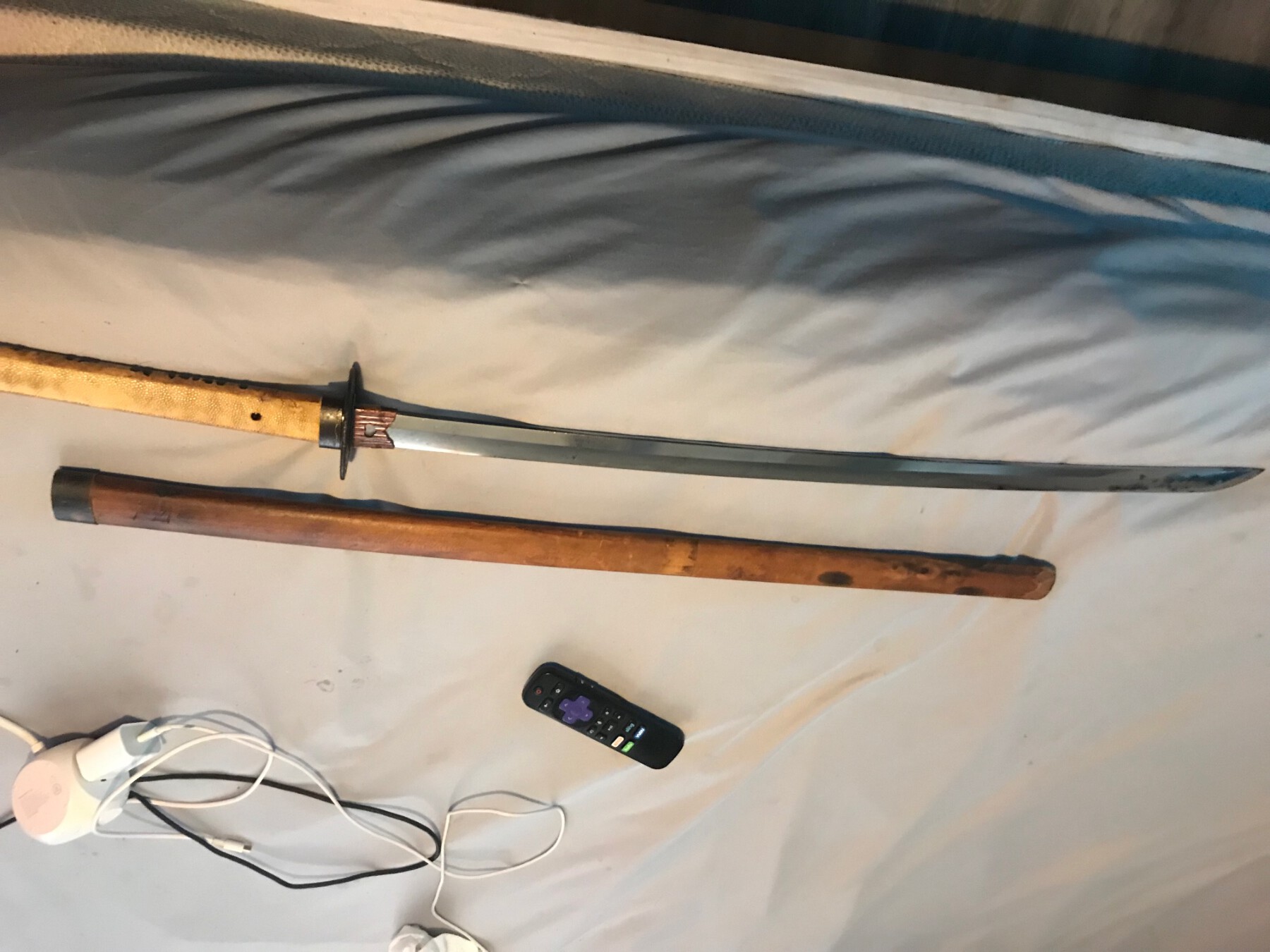

mike76us Posted March 26, 2024 Report Posted March 26, 2024 i have one with this same habaki i think the heart means you are not gonna back down from anyone that you will strike in a flash Quote
ROKUJURO Posted March 26, 2024 Report Posted March 26, 2024 Michael, this symbol is not a heart. It is called INOME, and it is shown upside-down compared with our heart symbol. The literal meaning of INOME (猪目) is " wild boar's eye". It refers to the "never twitching wild boar's eye" which is thought to be a sign of bravery and determination. 2 Quote
