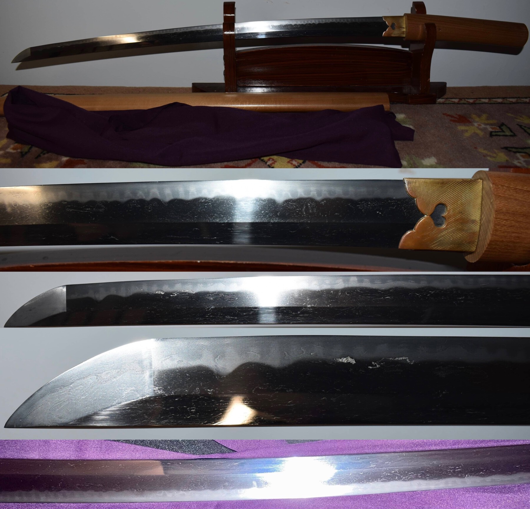

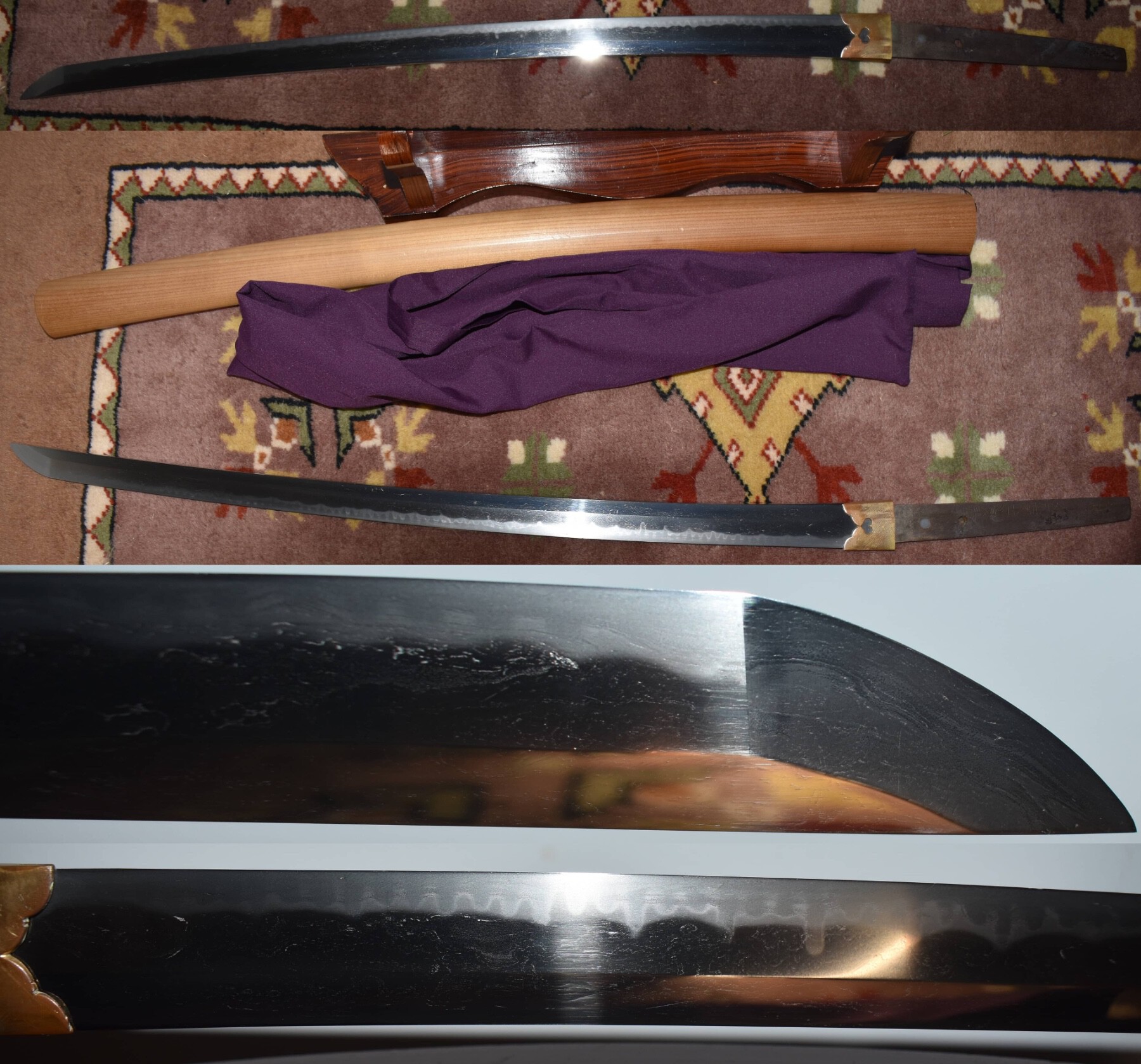

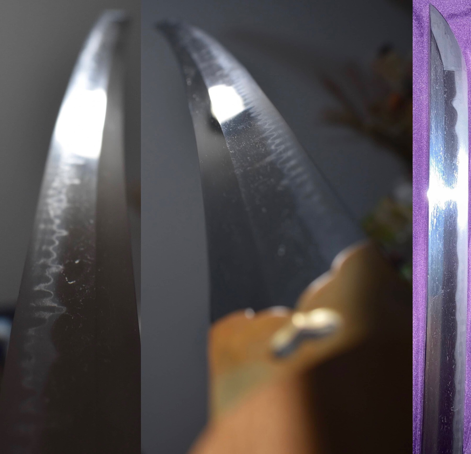

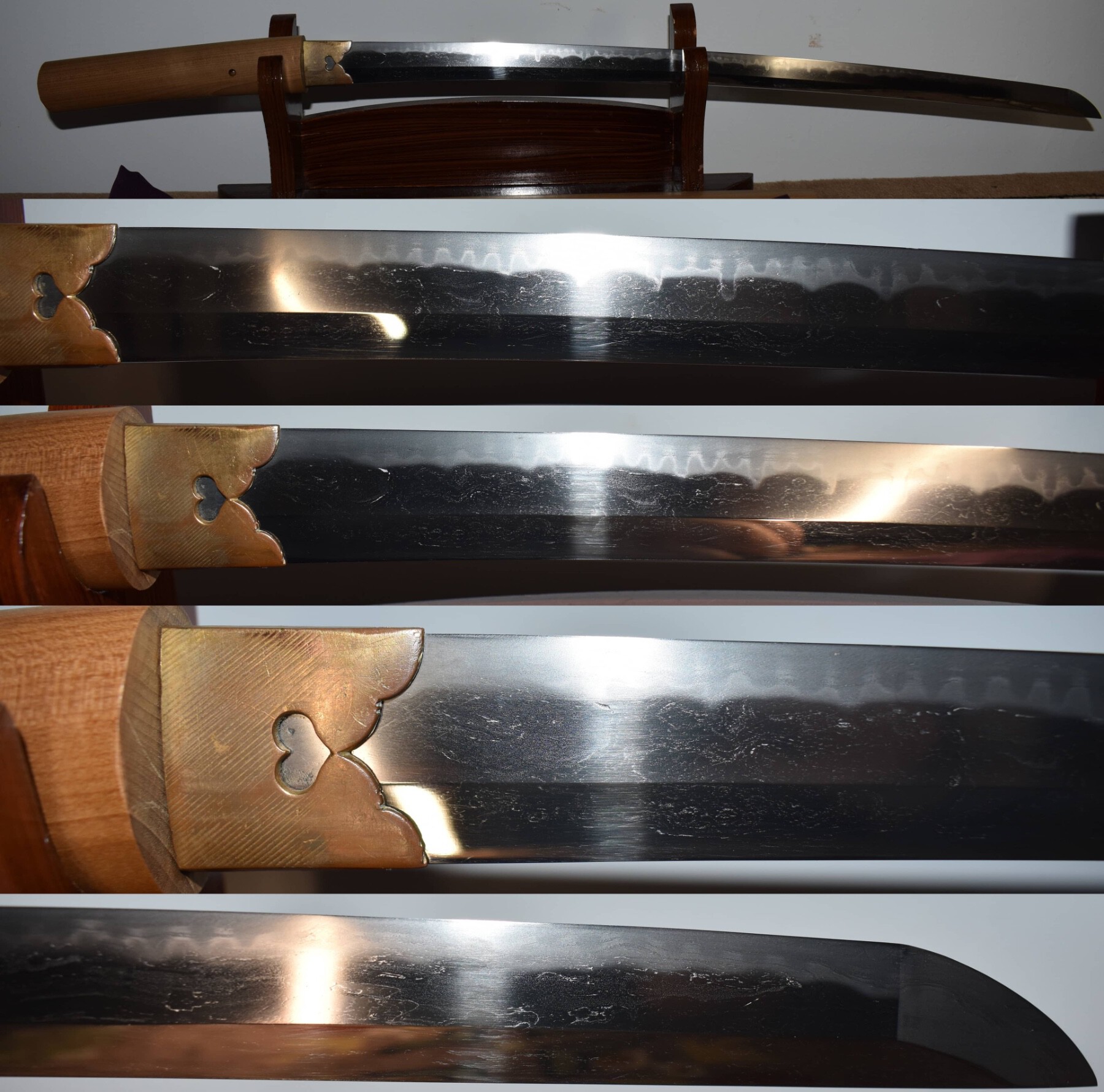

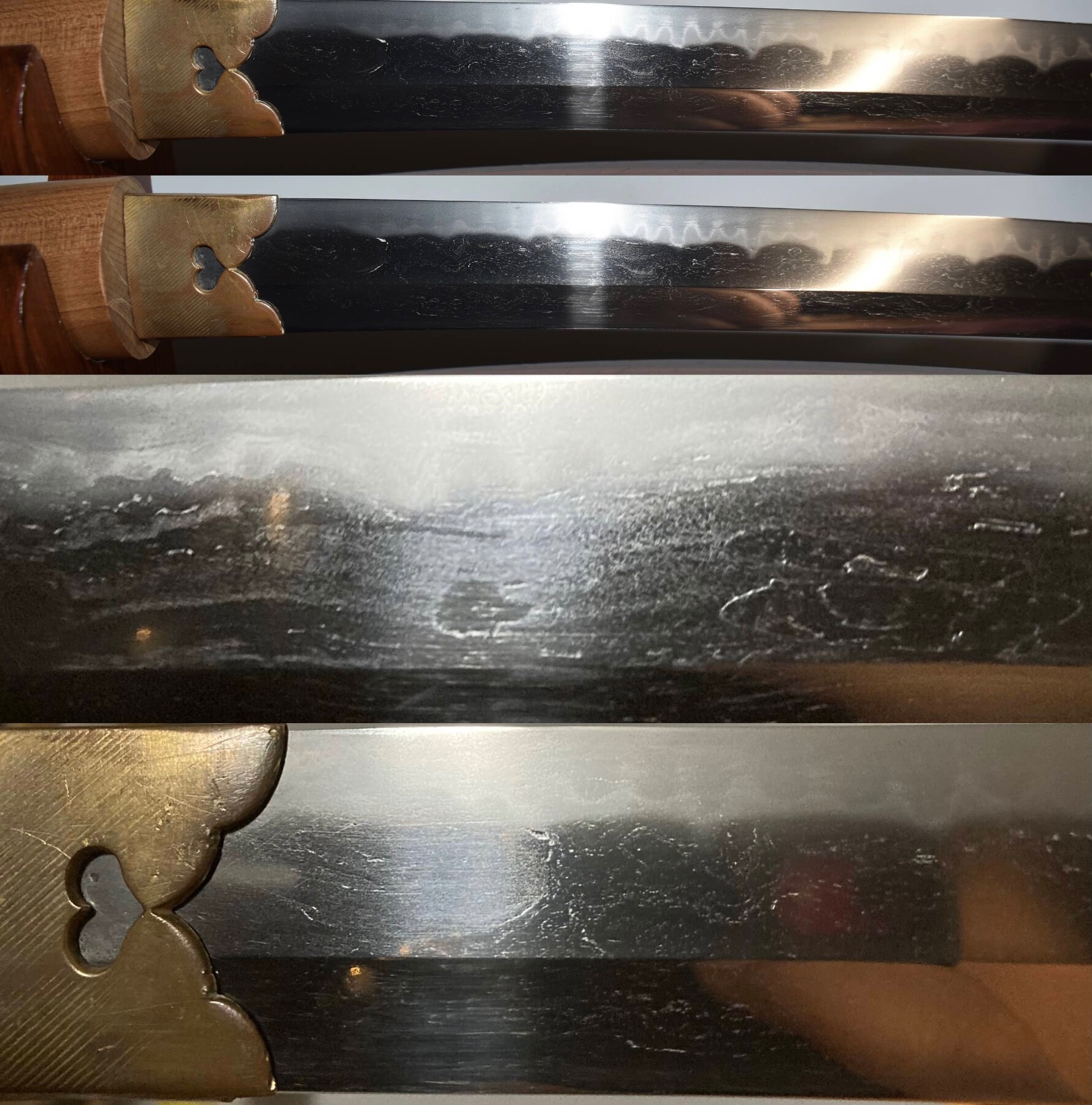

AntiquarianCat Posted February 14, 2022 Report Posted February 14, 2022 Hello again everyone, I know this blade is no treasure - it being a cheap sengoku study piece I grabbed a couple years ago - but the habaki made it pretty fitting for this occasion, so I hope you will forgive it. Also, I'd like to see if my Kantei skills are getting better so here goes: sugata is stereotypic late Muromachi, short (barely at 2 shaku) not very tapered and saki-sori so its a katateuchi; itame with some masame (mostly in shinogi) and heavy amounts of ji-nie, and what looks like a nie togari-gunome hamon. That makes me think I'm looking at a sue-seki or some other sengoku mino blade, Kazu-Uchi mono probably. Would this be a correct assumption? Also it seems to be signed by some "kanesada" but the signature doesn't match any examples so I got it under the presumption it was gimei. Would that be correct? Thanks again everyone 1 2 Quote
Alex A Posted February 14, 2022 Report Posted February 14, 2022 You assume correct for Seki, file marks correct too What length is the blade? 1 Quote
AntiquarianCat Posted February 14, 2022 Author Report Posted February 14, 2022 60.7cm, the export papers (which I left in a separate residence and can’t access) put it as a katana but my understanding is a couple mm shorter and it would be a wakizashi. Quote
Bazza Posted February 14, 2022 Report Posted February 14, 2022 Well, I've heard it said that to a dealer if buying it is a wakizashi, if selling a katana!!! The point about it is, I believe, that in their day of the 16th century they were considered katana and should still be so today, IMHO. BaZZa. 4 1 3 Quote
Alex A Posted February 14, 2022 Report Posted February 14, 2022 Difficult judging from images There is a thread somewhere with measurements of longer blades made for single hand use, if thats what you think it is, in hand . Quote
Alex A Posted February 14, 2022 Report Posted February 14, 2022 Found it, by Jussi I think modern classification is sometimes too strict when it comes to "borderline" things, as I don't believe it would have been a big deal back in the day if your sword is 59 cm or 61 cm. I picked 10 swords from Kantei-Zenshu that were listed being used in katate-uchi style by NBTHK. Here are the blade lengths, and 3 of them are wakizashi but the few cms wouldn't have mattered back then. 66,8, 66,3, 64,8, 64,3, 62,3, 61,8, 60,6, 58,3, 56,5, 53,3. Here are portions of the description of swords that are 56,5 cm and 53,3 cm. 1 1 Quote

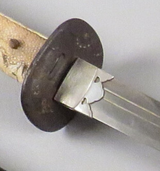

Bruce Pennington Posted February 14, 2022 Report Posted February 14, 2022 I have another habaki on file with a similar design concept (don't recall the source): Yours is only the 2nd I've recorded. 2 1 Quote
