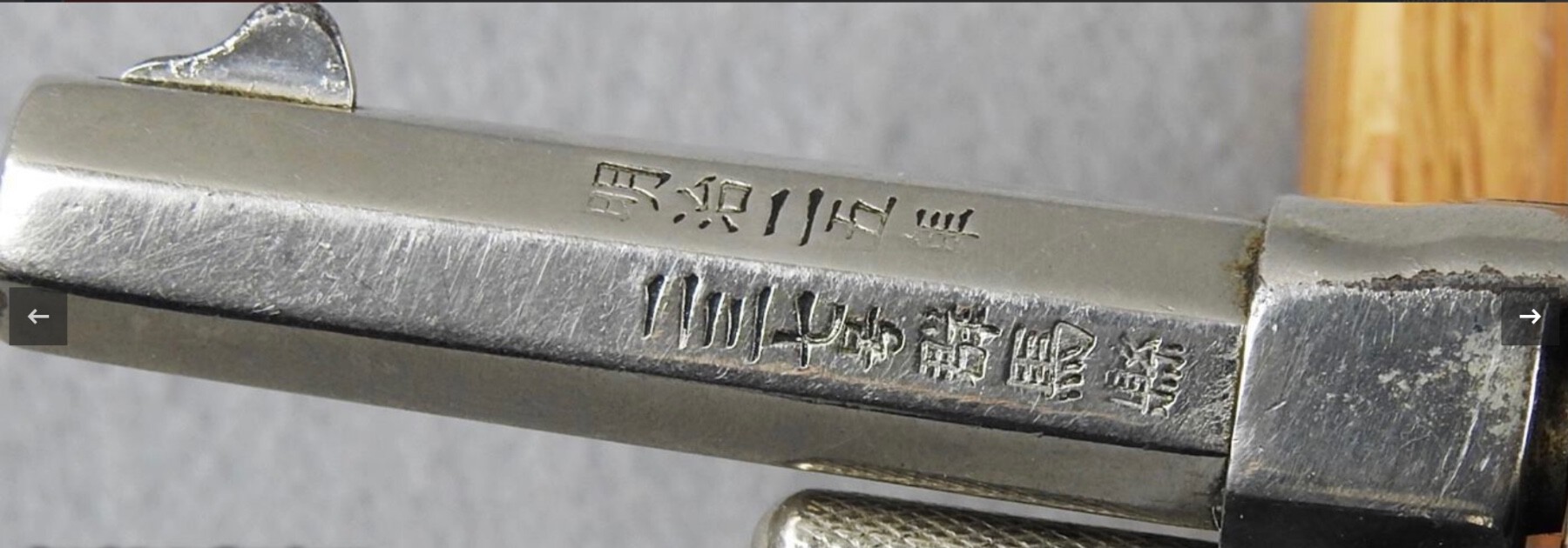

samurai1 Posted February 11, 2022 Report Posted February 11, 2022 Hi need a little help with translation on kanji on a American pistol was told. Ibaraki prefecture number 723 but was also told Meiji 7 number 23 Ibaraki prefecture. Any clarification would be appreciated. thank you Quote
SteveM Posted February 11, 2022 Report Posted February 11, 2022 Just "#723" and then "Ibara". It doesn't say Ibaraki Prefecture, but I suppose the Ibara may well be an abbreviation of Ibaraki. 2 Quote
Bugyotsuji Posted February 11, 2022 Report Posted February 11, 2022 The first and largest registration of weapons in post Tokugawa Japan was in the 壬申Jinshin year of 1872, Meiji 5. Usually the first or both of these Kanji was struck too, along with an indication of the name of one of the fledgling prefectures. The brands are found either on the wood stock or struck into the iron of the barrel. The probability is high that the numbers on that gun were applied at that time, although smaller registrations were held in later years of Meiji whenever the need was building up again with those which had escaped earlier registration. Generally, at least at first, the registration applied to larger guns, apparently. (Can’t now remember where I read that last piece of info.) 1 Quote
