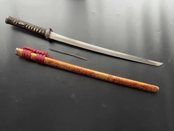

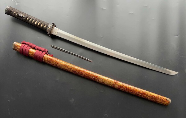

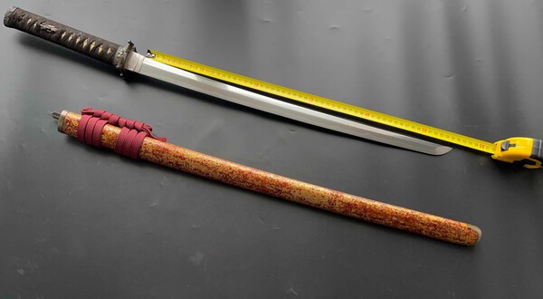

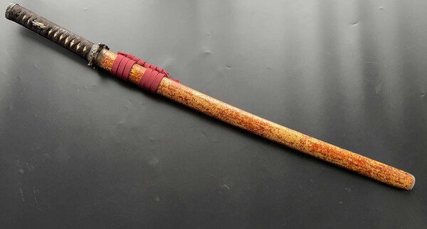

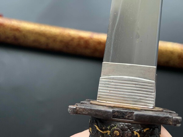

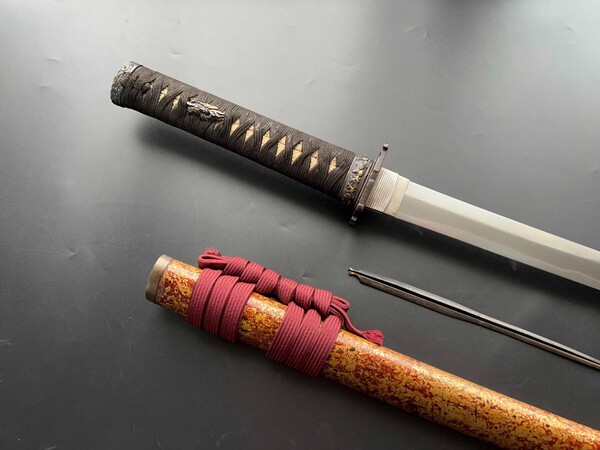

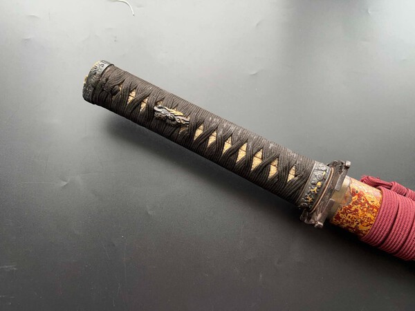

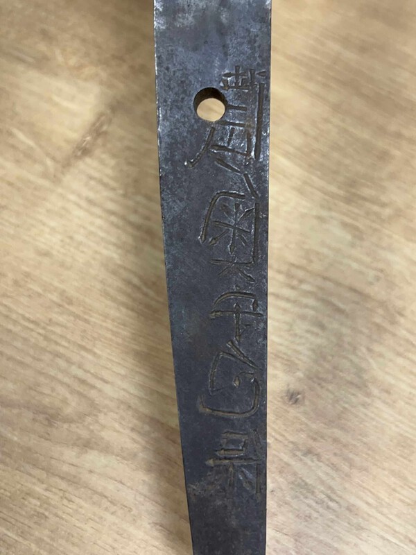

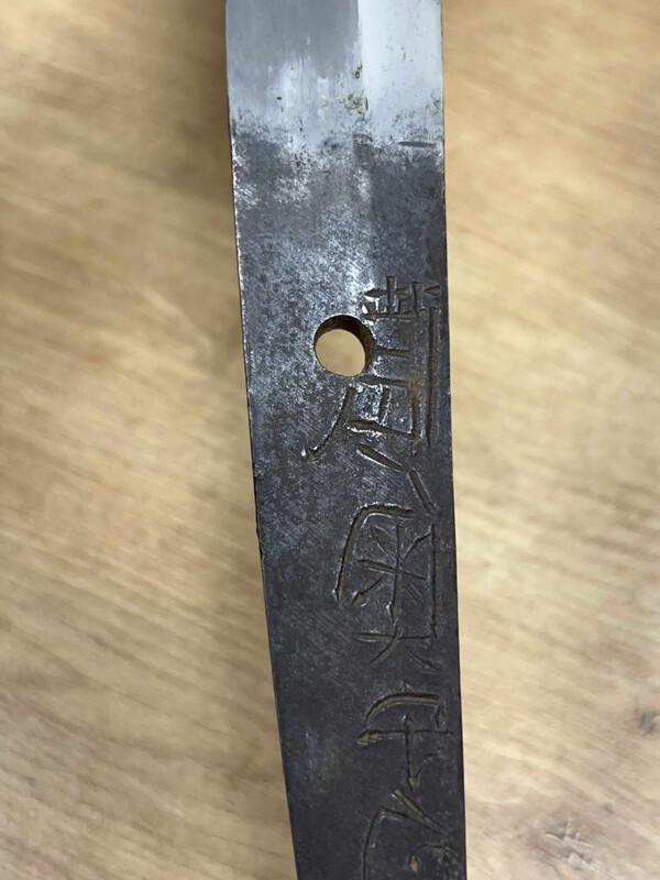

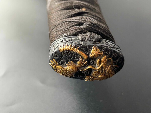

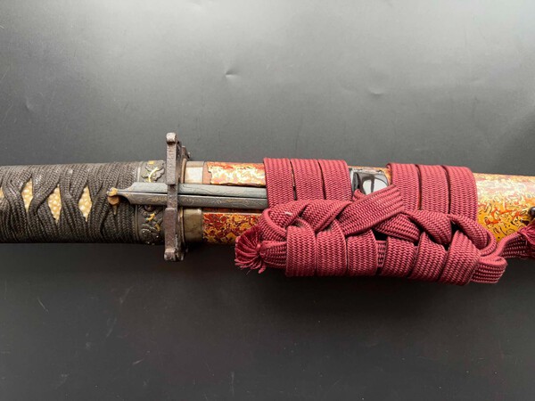

antiquegallery Posted February 8, 2022 Report Posted February 8, 2022 I also wanted to know your opinion on originality? The handle was badly tightened and will be given to a professional for restoration Quote

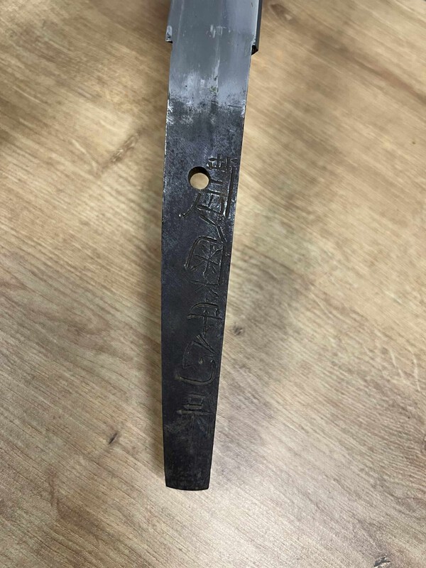

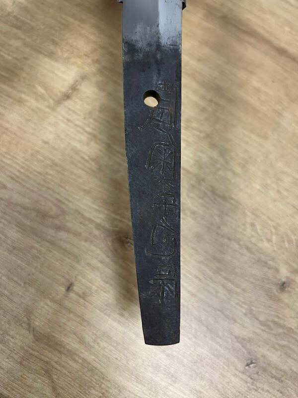

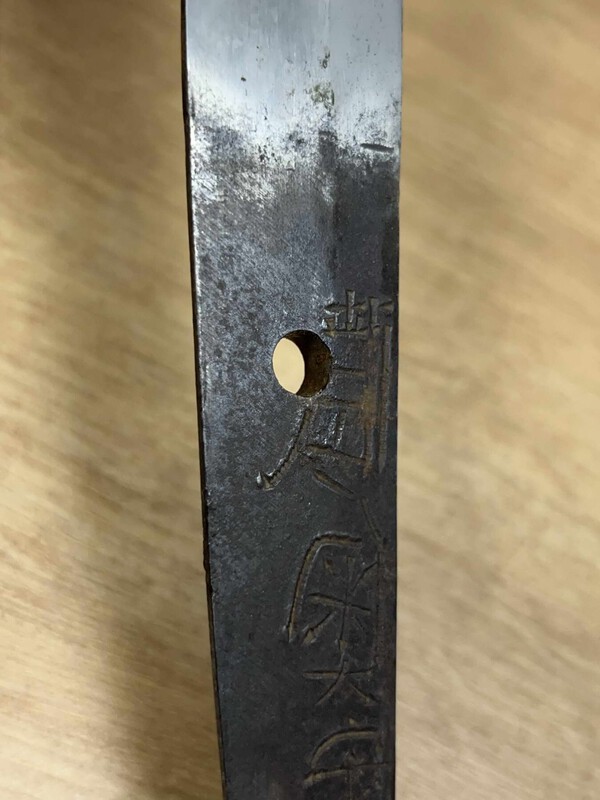

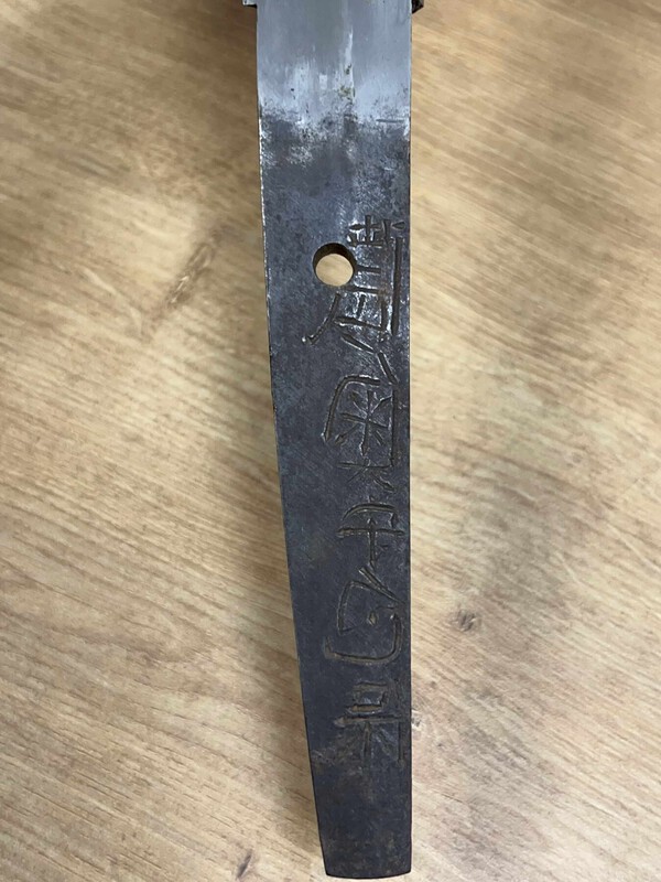

Ray Singer Posted February 8, 2022 Report Posted February 8, 2022 This is purporting to be the work of Hidari Mutsu (Mutsu no kami Kaneyasu). https://nihontoclub.com/smiths/KAN432 Quote

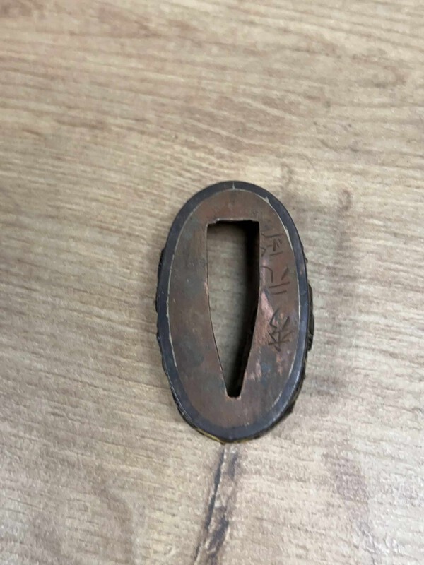

ChrisW Posted February 8, 2022 Report Posted February 8, 2022 That tsuba appears to be damaged also. It is missing the outer metal ring and there are rough spots where it would have connected. At least, I would imagine that is the case; I've never seen a tsuba intentionally made without one. Quote

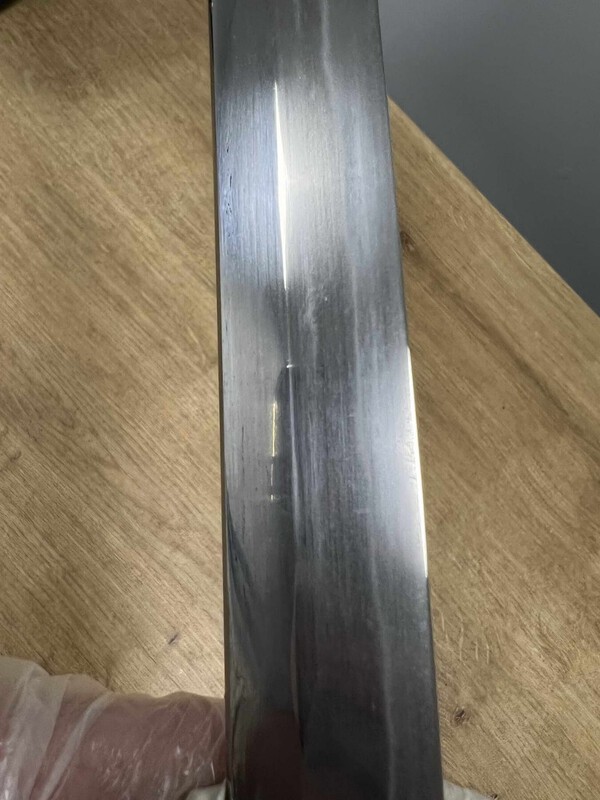

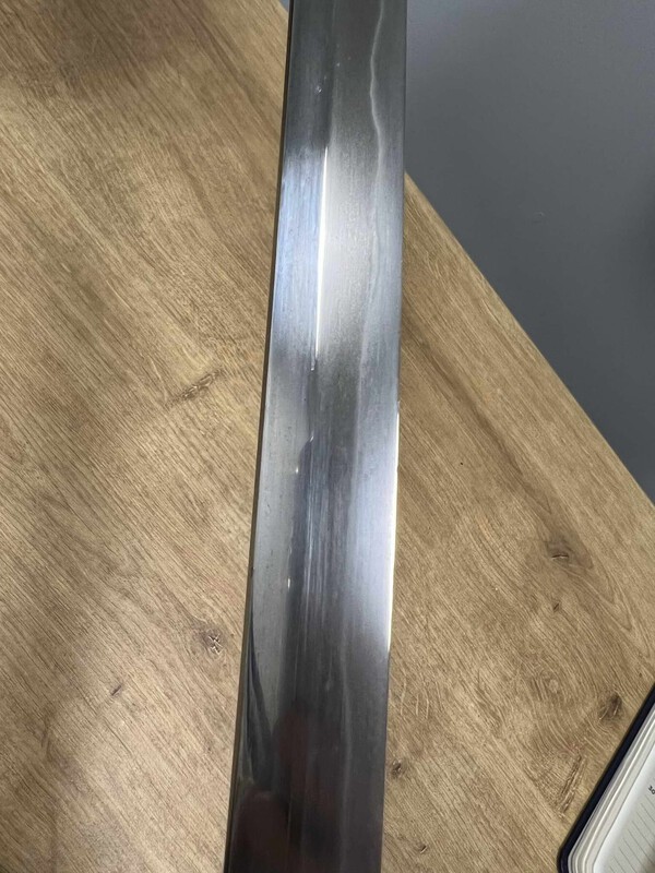

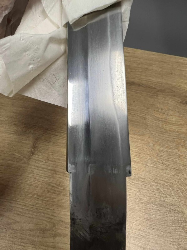

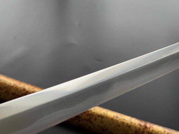

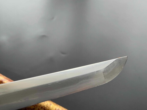

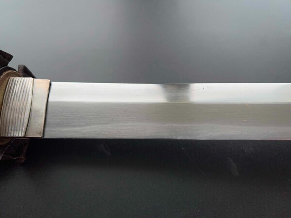

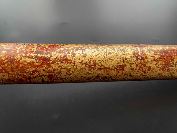

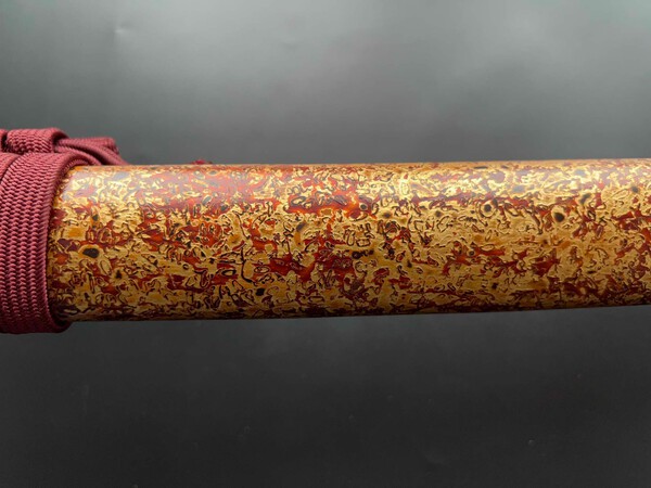

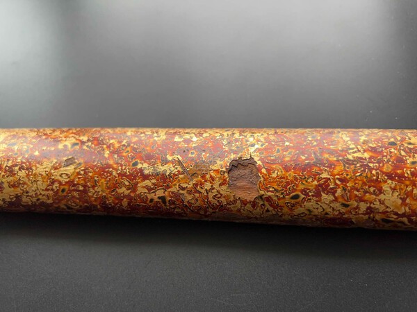

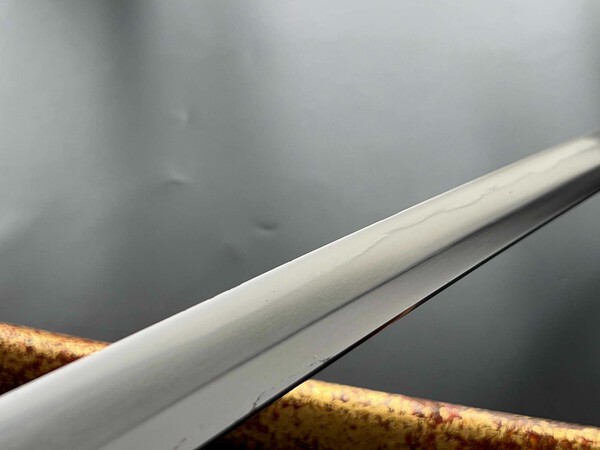

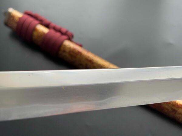

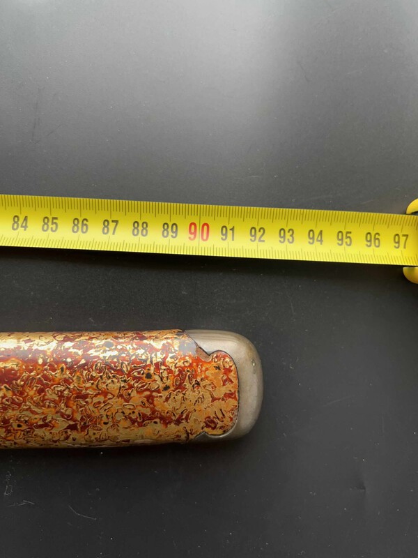

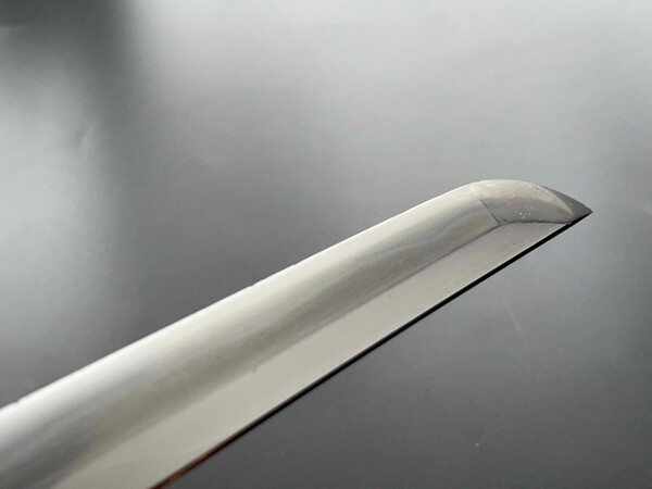

ROKUJURO Posted February 9, 2022 Report Posted February 9, 2022 Artem, bad polish (acid etched and rounded SHINOGI), quite nice TOSOGU (except the TSUBA). Nice lacquer of the SAYA, signature is a mess (looks as if made with a broken screwdriver). I would avoid it. Quote
antiquegallery Posted February 10, 2022 Author Report Posted February 10, 2022 On 2/8/2022 at 1:53 PM, Ray Singer said: This is purporting to be the work of Hidari Mutsu (Mutsu no kami Kaneyasu). https://nihontoclub.com/smiths/KAN432 Expand Thank you so much for your answer. It's very important information Quote
antiquegallery Posted February 10, 2022 Author Report Posted February 10, 2022 On 2/9/2022 at 11:10 AM, ROKUJURO said: Artem, bad polish (acid etched and rounded SHINOGI), quite nice TOSOGU (except the TSUBA). Nice lacquer of the SAYA, signature is a mess (looks as if made with a broken screwdriver). I would avoid it. Expand Thank yo for you your answer. I fink also the polish is bad and "hamon" etched. Quote
ROKUJURO Posted February 10, 2022 Report Posted February 10, 2022 Artem, to make things a bit clearer: I think this is a perfectly authentic Japanese blade, but the signature looks quite weird. I did not compare it with certified blades from this smith (that would be your task). The HAMON is not etched on the blade in my opinion, it looks absolutely traditionally made, but the YAKIBA is not displayed by a traditional polish but by means of acid. That is a big difference and will require a full polish to reveal all HATARAKI and the HADA. Quote
