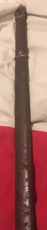

Butch Posted February 7, 2022 Report Posted February 7, 2022 Received this Shin Gunto today with a straight blade ? I have been told it was a bring back sword from Burma. Any help would be greatly appreciated Quote
Butch Posted February 7, 2022 Author Report Posted February 7, 2022 Some more pics sorry they are not the best . .o Quote
Stephen Posted February 7, 2022 Report Posted February 7, 2022 Best to show sugata with no fittings. Signed Masakuni... haven't worked the date. My guess Shinshinto blade. 1 Quote

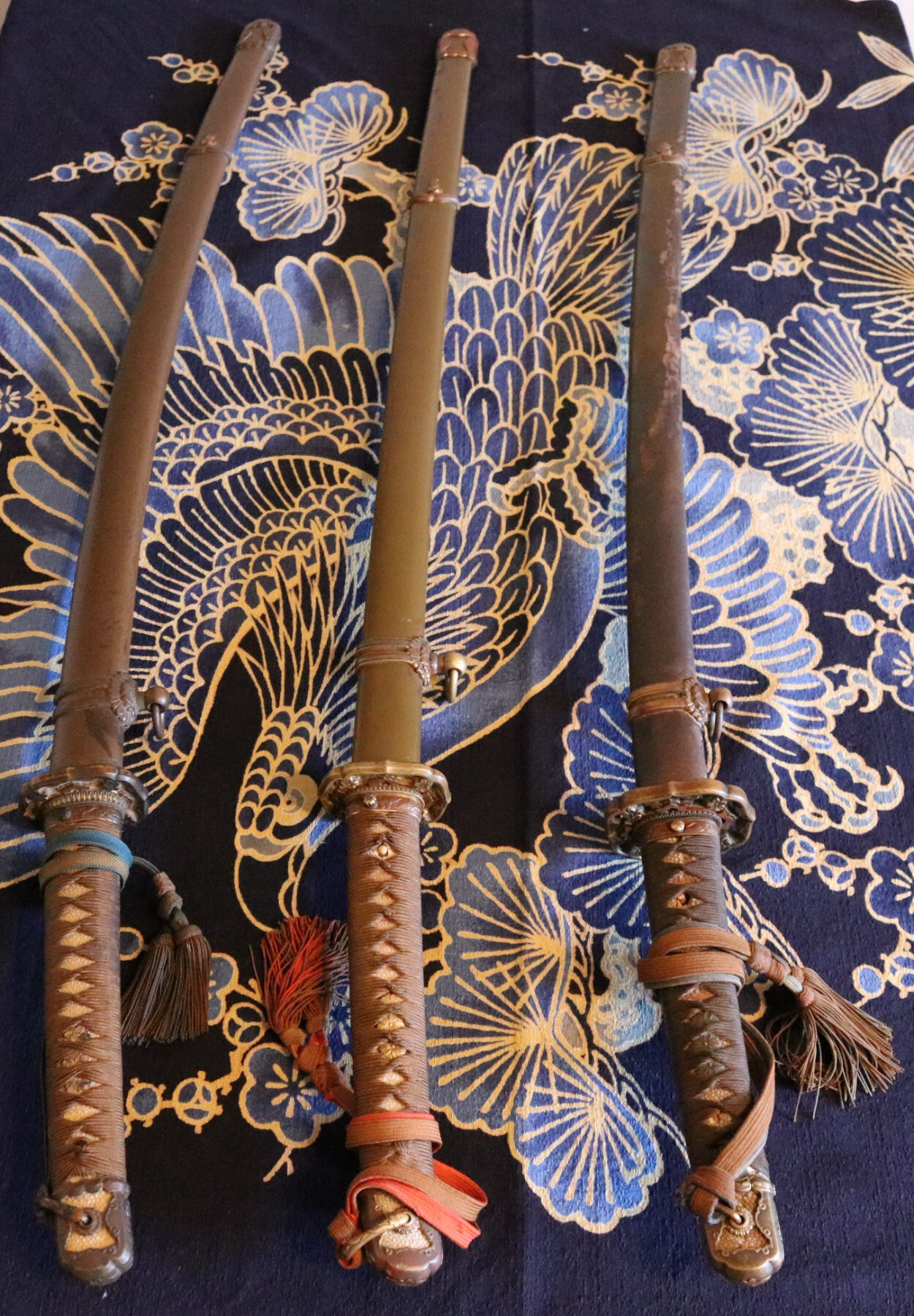

PNSSHOGUN Posted February 8, 2022 Report Posted February 8, 2022 Hi Gareth, not that common. Here is one with a blade likely from the Kanbun era, with virtually no Sori in the blade. 2 Quote

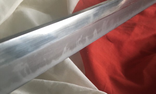

Butch Posted February 9, 2022 Author Report Posted February 9, 2022 Here are some quick pics There blade cutting length is 28,1/4inches in length 1 Quote
Butch Posted February 9, 2022 Author Report Posted February 9, 2022 There is no curve at all in this blade it is totally straight .. Sorry Stephen rushing a bit and the handle is a bugger to get off !!!!! Quote
Stephen Posted February 9, 2022 Report Posted February 9, 2022 We have seen the nakago thanks for pic. Deff loyalist blade as I posted in Monday at 3:10 pic.... Pretty cool you don't find them very often. Quote
Stephen Posted February 9, 2022 Report Posted February 9, 2022 Maybe couple more of kissaki and hada if you can capture? Quote
