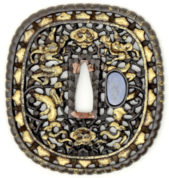

Re the distinct hitsu shape. You see that in some of the Nanban tsuba like this one:
image.png.4a195220c398a6e1d4e57958c2aa4cc2.pngimage.png.5c98150a7603446db020fc8da069dadd.png

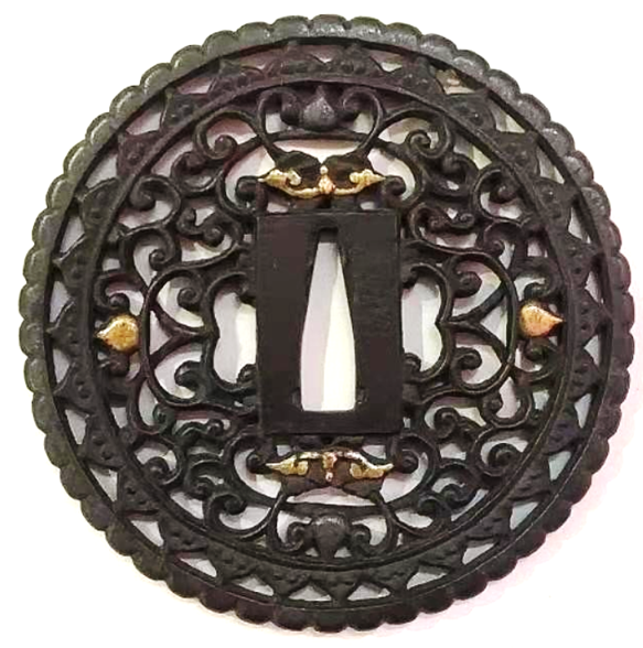

I think the motif is supposed to be a lotus flower petal, which is a common motif found around the inside of the mimi of some of the early Chinese guards (like these two) that inspired much of the Nanban-style:
These two Chinese guard images are from Mandarin Mansion online... a great info resource
