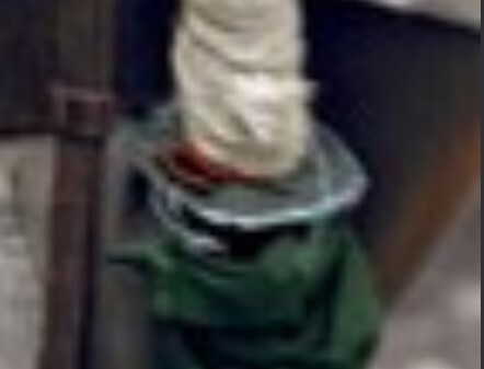

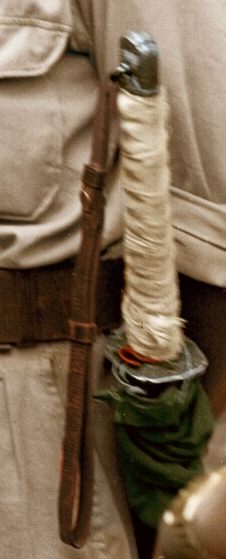

I dont see NCO in first photo.. blackened fittings with the leather strap instead of push button latch. String wrap ito.
But we all know I'm blind. 😐
Hard to say. Could be a Type98 too.
The picture is handcolored. So the colors are what the "artist" think what the color should be.
Boy, if that captured Java sword had showed up here, the first yell would be "FAKE"! Ha!

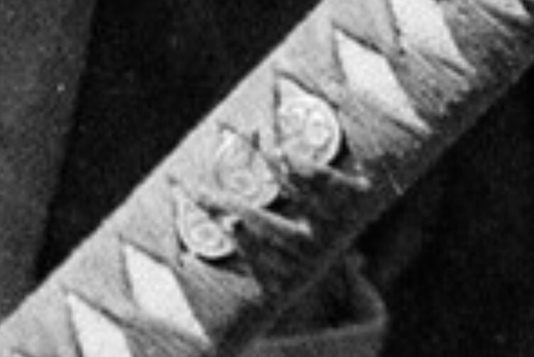

Interesting menugi:

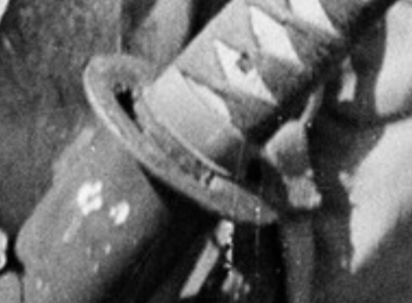

And that tsuba looks like a funnel!
As to the first sword at top, the kabutogane of the 95s are almost identical in shape.  They lack the blossom/leaf pattern on top and sides like the officer one have.  But I looked at mine and the one on top is almost worn flat.  The ones on the side are actually riveted on (a peg on the backside of the leaf pattern that goes through the kabutogane) so, it could be missing from the one in the photo.  On top if it all, the photo detail is too blurry when zoomed to see such detail, so really hard to say.  If you consider the whole thing was likely Java-made, the fine details I'm talking about probably weren't there at all and it's likely their attempt at an officer gunto.

Well, after another look, Stephen, I think you're right.  I can see a faint pattern on the tsuba, and what I thought was the fuchi sunken into a large hole (funnel), is really the center of the tsuba, with the fuchi above it.

If we consider the OP post of the supposed type 95, the tsuba as i said previously doesn't look right for a type 95, but it also doesn't look quite correct even for a type 98, which i would lean to, going by the kabutogane  (which i think is the correct word for the pommel)
The leather tassel is not the standard tassel for a type 95, but i have only seen these before on type 95's and never on type 98's. So the plot thickens and the mystery continues.
The second sword which i posted, and to which Johnny added the clearer originals, i think, is  as PNSSHOGUN (John) added, "appears to be an original Japanese Koshirae repurposed for war", just going by the menuki and overall appearance.(see Bruce's close up)
BTW it is clear in Johnny's photo that the colourised print i initially posted, is incorrect,  as the sarute would not be purplish, and the top part is in fact part of the Ito wrap, also not purplish.
