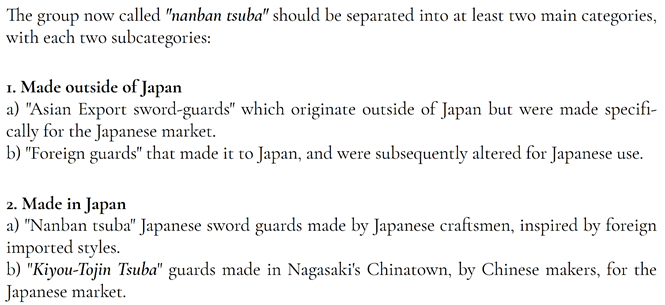

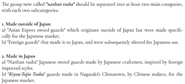

GRC Posted January 28, 2022 Report Posted January 28, 2022 Yves, I did a bit (OK a lot) more digging... Here are some key points from Lissenden's Namban a Reappraisal (I sure have been referencing his work a lot lately lol) http://etheses.dur.ac.uk/4129/1/4129_1648.pdf 1- Flat seppa-dai are more likely to be from earlier Chinese imports. ***note that this differs from my initial statement in my earlier post that was just based off of "memory", so I wrongly placed that in the "points for Japan" section. 2- The relatively simple oval or rectangular seppa-dai is also more likely to be earlier and Chinese (correct, in earlier post) 3- The symmetrical design is more likely to be Chinese (new detail) 4- The beaded mimi was likely a Japanese embellishment that was added onto their copies of the earlier Chinese imports (new detail) 5- Improvements to the undercutting & carving developed in Japan. (correct, in earlier post) 6- Chinese overlay work usually uses two directional cross-hatching, whereas the Japanese use more. (correct, in earlier post) *I found the source: James McElhinney, who wrote a book and the article: Asian Export Sword Guards and has a facebook page with the same title. Then there's this categorization of Nanban guards by "Mandarin Mansion": https://www.mandarinmansion.com/article/nanban-tsuba So in summary, you've got 5 reasons to say it's Chines, and one reason to say it's Japanese... My best guess is that it falls under category "2b": Made for the Japanese market, by a Chinese maker living in Japan. OK, I'm done now... 6 Quote
