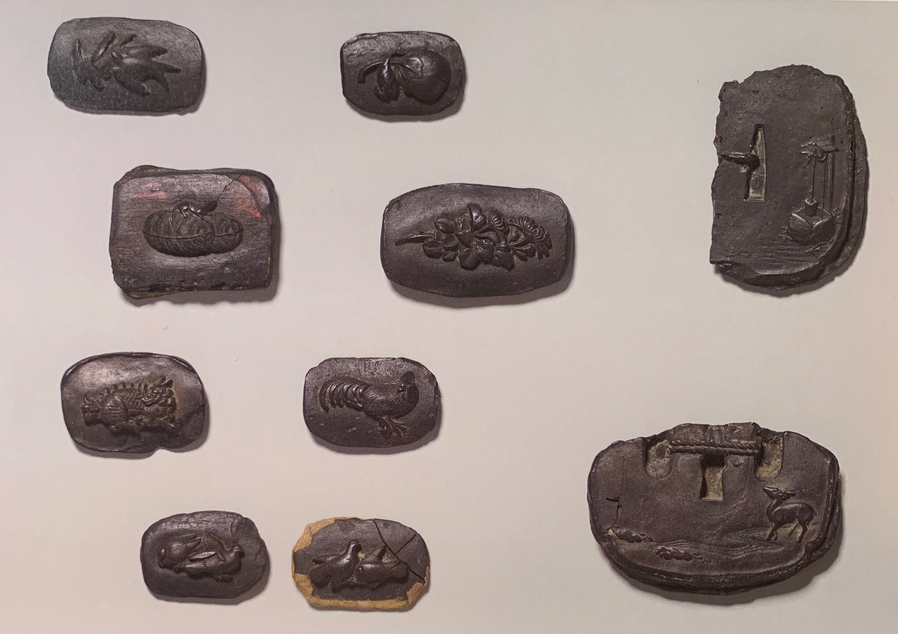

Bugyotsuji Posted November 18, 2022 Report Posted November 18, 2022 Pine resin mold examples from an exhibition at the Kurokawa Institute of Ancient Cultures. (No explanation given that I can see, but dated “late Edo to early Meiji”.) Detail 1 2 Quote

Brian Posted November 18, 2022 Report Posted November 18, 2022 Piers, I think those have been spoken about, and are merely resin casts to preserve what items looked like. They are not molds, and not intended to assist with any manufacture of anything. Basically just a record of what items looked like. 5 1 Quote
Bugyotsuji Posted November 18, 2022 Report Posted November 18, 2022 Thanks for the update, Brian. I just kind of reverse translated the chapter title “脂型” to “resin/rosin mold” without the necessary background understanding, and added ‘pine’ as this expression comes up on the net only as 松脂型. They had over 70 of them on display, of Kozuka, Menuki, Fuchi/Kashira. (Oh, and part Tsuba…) 3 Quote
