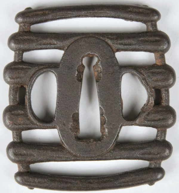

GRC Posted February 6, 2022 Report Posted February 6, 2022 Well that's certainly a very interesting example. Nice bit of digging there Dan Here's a clearly cast iron tsuba, NBTHK attributed to Yagyu, complete with the telltale raised circular "scars" on the seppa-dai, where I suspect the iron was poured into the mould. There's also a lot of "webbing" remnants in the kogai-hitsu-ana and elsewhere. Maybe it was made from a sand casting with two halves? I accidentally came across this example when I was looking for examples of this particular motif, but then noticed it was cast. The translation comes from MauroP in an NMB post where Dale assigned everyone some "Homework". 2 Quote

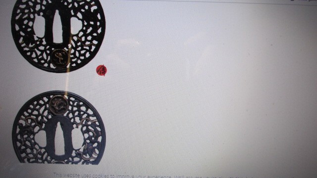

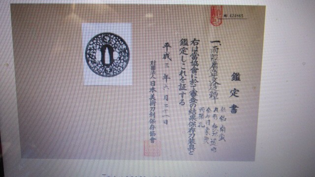

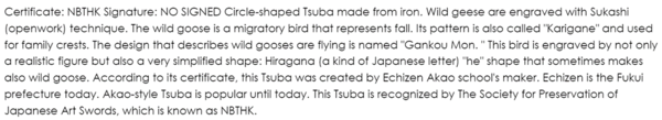

Dan tsuba Posted February 11, 2022 Author Report Posted February 11, 2022 Hello all, So, there I was on the internet thinking about purchasing another Nanban type tsuba. Minding my own business. Then I happened to “bump into” the below listed web link and a papered Nanban type tsuba that may be cast iron just kind of “jumped out” at me!! I needed to post it so that others could check it out and help me discern if it could be cast iron. If you scroll down on the link, it will show the NBTHK papers. I don’t know how to copy the pictures to post them – so I apologize for that). Thanks for the assist! With respect, Dan https://www.samuraimuseum.jp/shop/product/antique-tsuba-for-samurai-sword-with-nbthk-hozon-certificate-t-332/ Quote

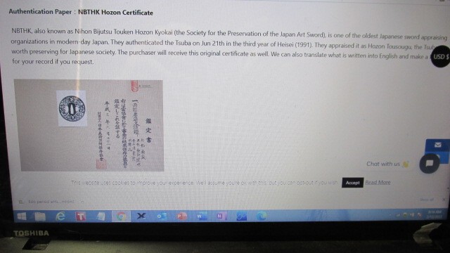

Dan tsuba Posted February 12, 2022 Author Report Posted February 12, 2022 So, I had to take pictures of the website referred to in my above post (in case it ever disappears!) and that's the only way I know of how to post these pictures of a possible cast iron Nanban tsuba (with papers). 1 Quote
GRC Posted February 12, 2022 Report Posted February 12, 2022 Hi Dan, I have a hard time distinguishing cast from hand worked with tsuba that have a little more "weathering" like this one. And as Lissenden points out, some Nanban tsuba make it tougher to see that it was initially cast because there was so much hand-work done to finish it off afterward. 1 Quote
Spartancrest Posted February 12, 2022 Report Posted February 12, 2022 Dan some clearer images for you. If people have a sharp eye they may pick up the date. [Jun 21th - shouldn't that be Jun 21st? (picky, picky) ] Quote

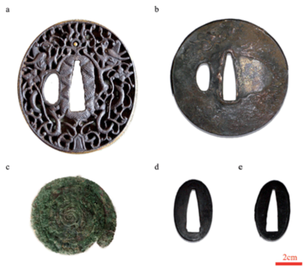

GRC Posted February 17, 2022 Report Posted February 17, 2022 Back to making this thread more "collegial".... Here's a published, peer-reviewed article about some non-invasive techniques for analysing these objects: Neutron computed laminography on ancient metal artefacts https://pubs.rsc.org/en/content/articlehtml/2015/ay/c4ay02014f 3 Quote

Dan tsuba Posted February 17, 2022 Author Report Posted February 17, 2022 Glen (thank you for your latest 2 posts) what a great article! I have included a piece of it below, so others do not have to link up to the website. Well, that is definitely a “plus” for the “forged iron (and not cast iron)” side of this discussion. And that the analysis was done on a Namban type tsuba is also a “plus” for the “forged iron” side of this debate. The research paper referred to was written in 2014 – “First published on 5th November 2014 “(a year before the Nara site tsuba casting molds were found), thanks for searching and finding it!! Although (and I agree with you that this would be the best method of determination) I would still like to see this type of research done on a wider sampling of iron tsuba (as I stated in a previous post of mine– about 20 tsuba that appear to be cast iron). But hey, I don’t have the cash to have that research conducted. I would much rather spend my money on widening my tsuba collection!! And to Jean, Thank you, once again, for your post and your in-depth knowledge and research into this subject. I present a part of the article of “Neutron computed laminography on ancient metal artefacts” below for review: “The white beam laminography revealed a homogeneous body for the iron tsuba, probably filed starting from a single piece of iron (Fig. 4). As a matter of fact, starting from the Muromachi period, the sukashi technique evolved over time. The iron plate prepared as the ground metal was very uniformly forged and relatively soft in order to cut out the fine designs successfully but hard enough to avoid breakage during use. Any void or significant irregularity in the iron body would have made the shaping of continuous decorative lines impossible. Extra effort in the preparation of the plate would have been necessary, as observed in the inner volume of the samples which was free from any cracks, pores and inclusions.23 Evidence of forge-welding was not identified in the design motifs involving plant and animal figures, apart from the gilded ring outlining the profile of the kozuka hitsu. While the inner brighter areas are reconstruction artefacts, the ones detected on the surface were probably due to the application of a patina or to the early formation of products of alteration.24” With respect, Dan Quote

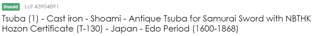

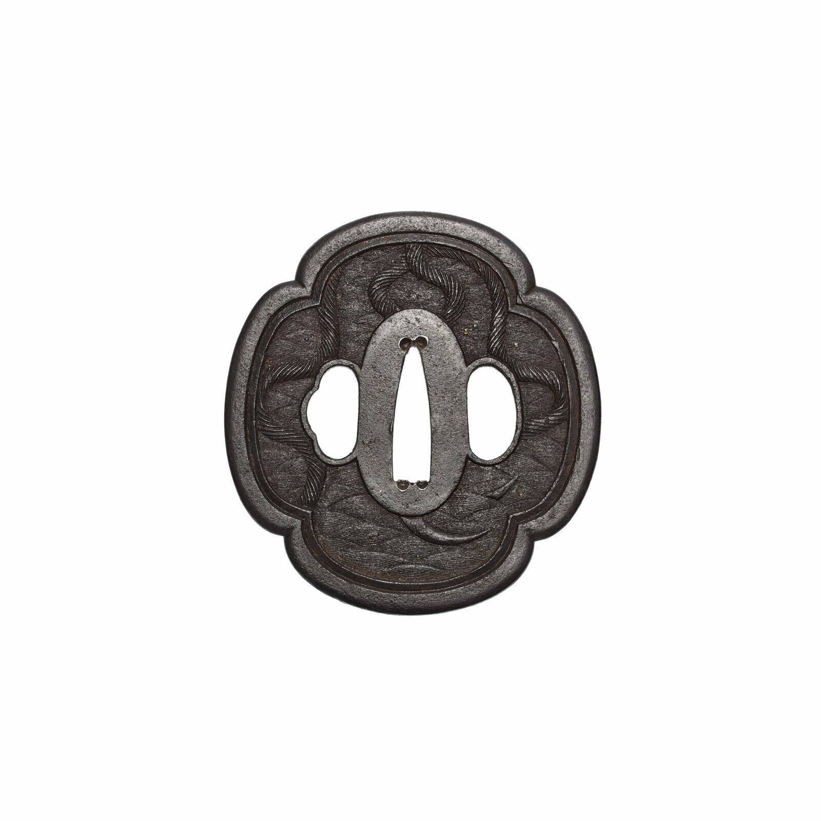

GRC Posted February 18, 2022 Report Posted February 18, 2022 By pure accident, I stumbled across two more NBTHK papered examples with "cast-iron" in the title of some past auction listings on Lot-Art. One Echizen and one Shoami. Here's the screenshots of the titles, the only images available, and the descriptions: The first one has that "soft, rounded look" to it everywhere. It's also got "webbing" remnants near the 5 o'clock position, and a weird circular indent deformity at the 3 o'clock position of the mimi: some sort of bubble of gas that formed during casting maybe? For the second one, I might have initially passed it off as having "surface pitting from corrosion". But given the title, it would suggest that the "bubbly" indentations on the surface are the result of casting (trapped gases in the mold perhaps?). If the seller is calling it "cast-iron", then how can I argue with that? I'm sure many of people will recognize the emblem on the image. And just an added thought: if there's that much pitting on the surface, and it was caused by corrosion, then how are those very thin arcs still intact? They would have likely corroded enough to break clean through at some point. It is interesting to note however, that the accompanying descriptions in the listings just use the word "iron", when "cast-iron" was used in their titles. So I can't say with absolute certainty that these were cast, but if it looks like a duck and it's called a duck... then it just might be a duck? 1 Quote

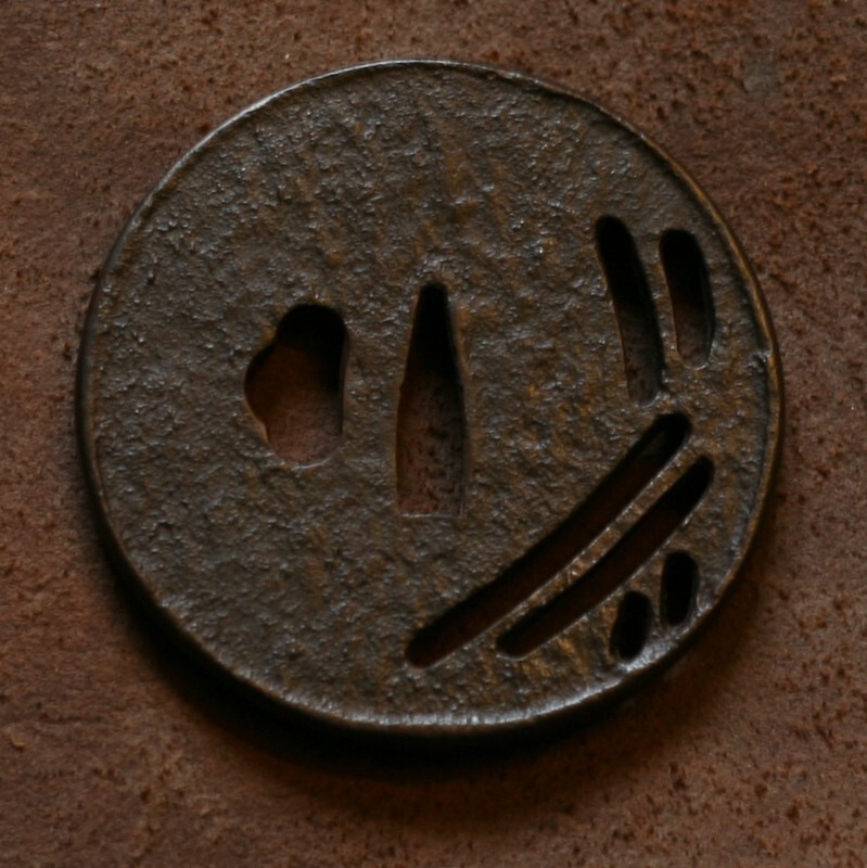

Dan tsuba Posted February 21, 2022 Author Report Posted February 21, 2022 Hello everyone (again) !! So, without purposely looking for a possible "cast iron" tsuba I happened to "bump into" this NBTHK papered one. It may be cast iron. The listng states that it is "Edo" period. Thoughts and opinions would be greatly appreciated. With respect, Dan Quote
GRC Posted February 21, 2022 Report Posted February 21, 2022 Well, On the CAST side of things: -uniform colour everywhere (which is often some version of a uniform "grey" colour, but sometimes a "waxy-looking" black in some types of the more obvious cast tsuba). -the mimi and seppa-dai are definitely dimpled with little sand-grain-like craters. -there are some surface irregularities in the waves on the omote (front) side that has the majority of the anchor on it. And I mean the plate itself, underneath the fine wave lines. On the HAND-WORKED side of things: -the inlayed "water droplets". -there appears to be a few stray chisel marks (or maybe it's just damage?) on the ura (back) side's mimi at the 2 o'clock and 4 o'clock positions. On the "ambiguous" side of things (for me): -there appears to be some streaky "flow patterns" around the mimi on both faces of the tsuba, as well as all along the inner, sunken "step" the runs along the inside of the mimi. *could be indicators of "poured fluid" or indicators of the layers of a "folded plate", but it seems too streaky to be the folded layers. Especially so for the inner, sunken "step" along the mimi. If that was punched down with a punch, it would be a lot smoother than that, and a chisel would leave different looking marks as well. So, overall it looks more like it was poured fluid. Overall, I'm leaning towards initially CAST, then hand finished. I personally don't know if casting can produce such fine ridge lines. And, just throwing out a guess about the overall process here: Maybe the tsuba was cast, then inlayed with the water droplets, then the wave ridges were chiseled in by hand afterward? The timing of when the wave ridges were produced is an unknown for me. An interesting example Dan 1 Quote
