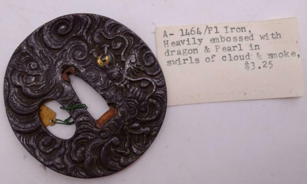

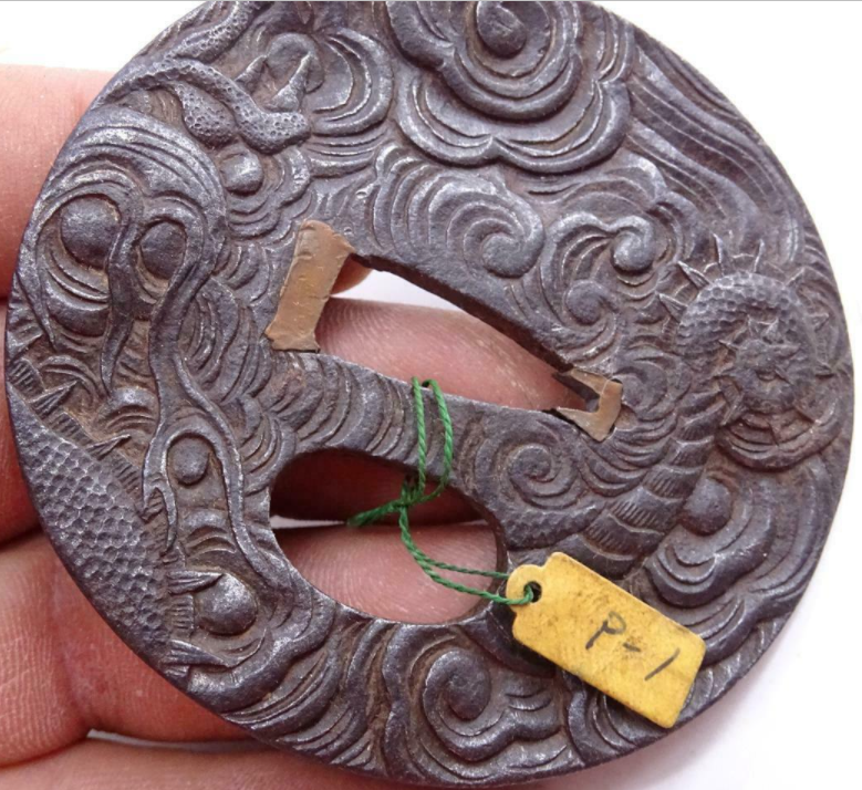

3-In the late 1800s/beginning of the twentieth century, genuine tsuba were being purchased by the barrel in Japan at pennies a piece.
4-There was recently a collection of proper Edo period swords and tsuba (including a Nara Joi that was published) that came up for auction from an American collector's estate who had done all of his purchasing in the 1950s and 60s. Some of the original price tags and correspondence with the Japanese dealer were also present in the auction listings. Some of the tsuba were originally purchased for LESS than $1, and this dragon tsuba for $3.25 !
image.thumb.png.91ccdf7e71bc74293a197e5ef0494f00.pngimage.thumb.png.953327e1b8cac0c7c56229ebc775a2f7.pngimage.thumb.png.27e06495695198353b4701d2b5b26e65.png
So here's the conundrum:
If there were so many genuine tsuba available at such a low cost from the late 1880s to at least the late 1960s, then who was making all these cast tsuba, who were they selling to, and where was the profit to be had?
So it doesn't seem to make sense that cast iron tsuba production would suddenly spring into action in Japan (or anywhere for that matter) when the genuine tsuba themselves were available for just pennies or at most a few dollars.

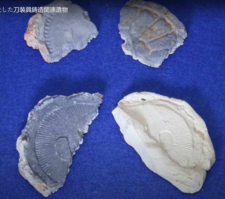

The examples found at the Nara site are definitely molds, some of the discarded molds still have failed castings inside. Casting sword fittings in bronze and later brass is pretty well established, but again this site has nothing to do with the casting of Iron.

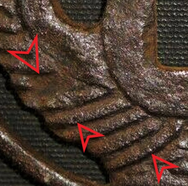

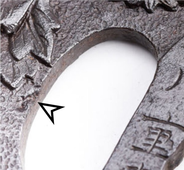

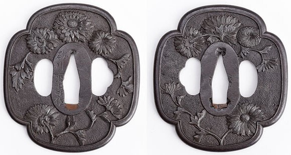

I have some concerns with some of the indicators used to determine whether or not a Tsuba is cast in Dr Lissenden's thesis, I think some of them could be explained by other factors, but without being able to see the examples he examined it would be difficult to refute. Dr Lissenden proposes the following indicators:
1. The presence of surface granularity and porosity, with or without 'sand bubbles'.
2. The presence of investment material — a residue of a red, granular nature was discounted.
3. The presence of 'feathering' in the openwork.
4. A lack of crispness in the incised areas.

Jean, Lissenden describes how many wax impressions could easily be produced from an initial mould... so not a one by one process.
Photo of tsuba molds from the Nara soft metal casting site (white object at bottom right is plaster poured into the mould fragment at the left):
So again, like Lissenden points out, as long as you have a mould, you can easily press wax into them to produce the desired outcome as many times as you want.
From memory the 'super fine clay slurry, called investment is initially in liquid form and poured around the wax shape that is to be cast. This then sets, I forget how long it takes to harden or if some heat is applied- probably not initially, the whole thing then heated for the wax to drain out and the empty mold is then 'ready and willing'for the molten metal invasion. That is for lost wax casting as I recall when unsuccessfully trying to cast a silver belt buckle about 55 years ago.

Thomas, I completely agree that images of each of the specific "evidences for casting" in Lissenden's thesis would have been extremely helpful.
I'm generally not in the habit of storing images of cast tsuba, because there are literally tons of them among the ~10,000 listings on YahooJ every week.

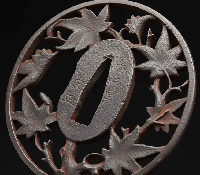

Here's a few examples of some that I did keep as reference:

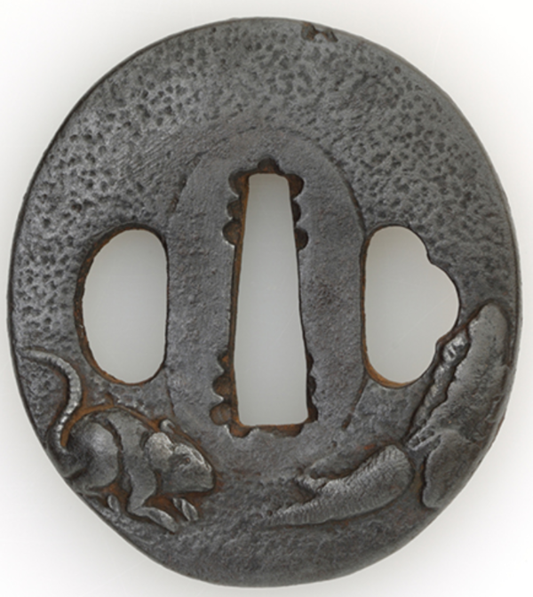

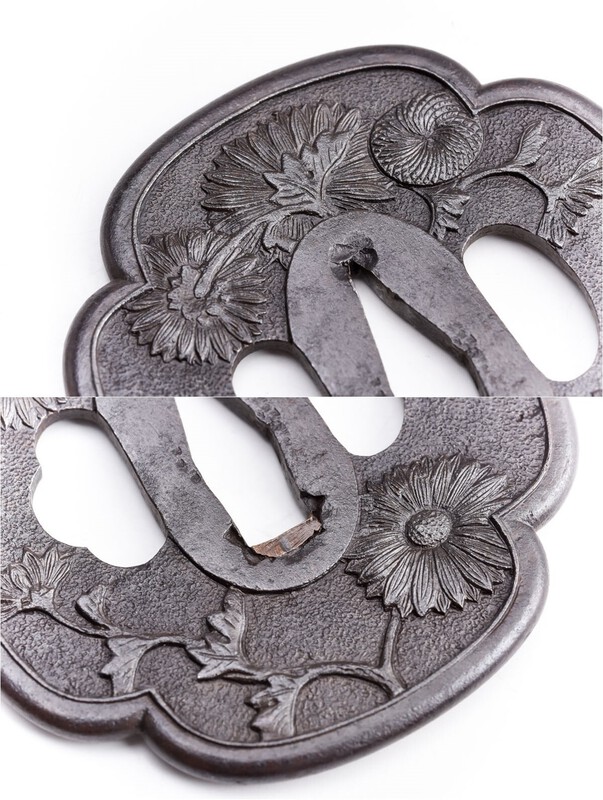

A very convincing cast tsuba, as already discussed in the "Sekibun belly flop" thread... so sorry to bring it back up again Bob, but it really is a great example that you won't see many of at all, suggesting that these were produced long ago:
2010 at Bonham's, described as 19th century                                                            and it's twin discovered in 2022 on YahooJ
image.png.10be1e4d371a0c626cadd5ec723489f7.pngimage.thumb.png.30d2a0210291e416390fce7c881c90f3.png
When you zoom in to the close up images, there's lots of evidence for casting, but you sure wouldn't know unless you started scrutinizing it up close.The eternal question though is
The eternal question is still, WHEN was this made and how do you know with any degree of certainty?

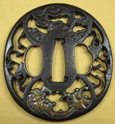

Here's a glaringly obvious cast iron tsuba that someone unfortunately paid way too much money for:
Again though, I have only come across one with this design, so presumably made long ago.

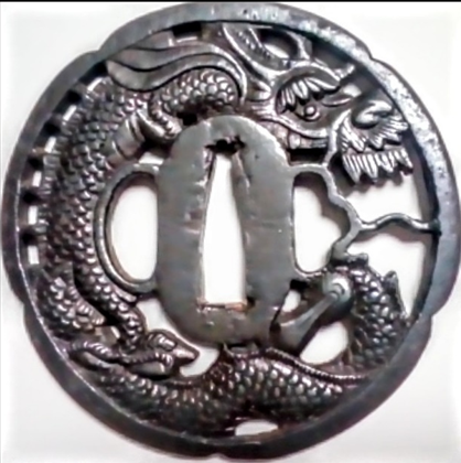

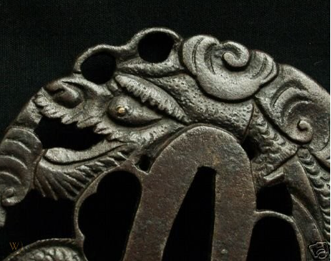

And how about this one that looks convincing at first, until you zoom in (it was made somewhere this morning... but still looks "right" at first glance):
This one cost someone a lot of money:
We know this one being made now because there are multiple examples and multiple surface finishes.

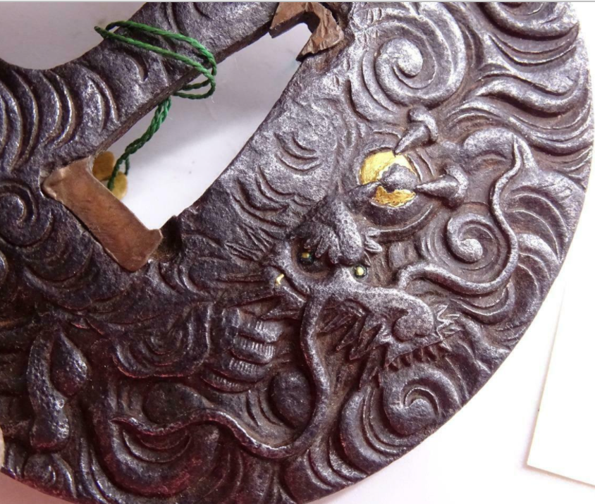

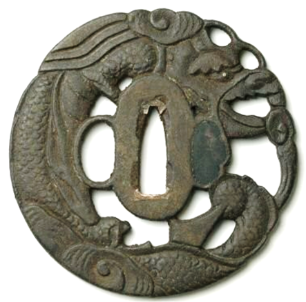

Here's a real Kinai tsuba and then two "shiiremono" castings both of which were mounted on swords at some point:
image.png.803001b9a24290df38dfa6801890f7c7.pngimage.png.a4235faab80ab29fdc6b271cf68fde5f.pngimage.png.a1852fc7d84a02a55026276f5ac10af0.png
In the case of the Nara site, it is unlikely that wax was used in the casting process, the evidence points to the use of a solid master that would be pressed into a fine clay to create a male and female mold halves. It should also be noted that the molds would be destroyed in the casting process and could not be reused, a new mold having to be created for each cast.

Dr Lissenden is talking about the process of using a solid master to create multiple wax masters for use in lost wax casting. This is actually a redundant step if you are pressing the master directly into the molding material, which is likely what was done at the Nara site based on the evidence of the molds themselves. It should also be noted that creating molds is skilled labour, its not just pressing things in clay, there are many considerations that have to be taken into account to get good results. There is even evidence that elements were added to the designs after the impressions were made.

Who exactly is to say WHEN the Sekibun was made? There's really no way to know.
That one certainly fooled the Bonham's experts, all the bidders in 2010, and then again, all the bidders on the one that sold in 2022, and it was located in Japan.
Asking for one with the perfect provenance still doesn't help answer the question of WHEN all these cast tsuba were made.
Anyway, I think I may have one papered example on file that I'll dig up right after this.

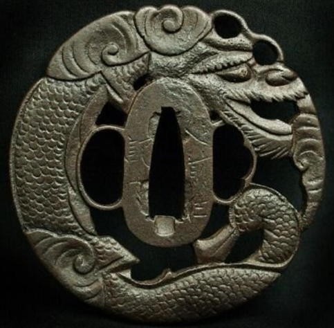

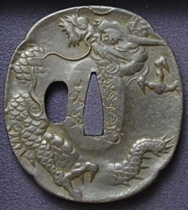

I think the Kinai dragon is probably a good place to keep looking because it was so popular, so there are many examples to dig up.
By the way Thomas, if you're looking for tagane-ato added after casting, I think both examples of the cast kinai tsuba show that. The first example has enough tegane-ato to have even been mounted more than once..
Here's another cast example of the Kinai, complete with inlays in the eye (although one has fallen out):
You can see the little casting artifacts that look like little raised spheres on the close up (red arrows).
Can anyone say with certainty when this one was made?

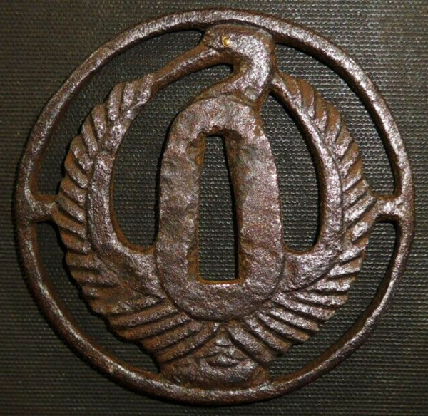

Dan, I think you're right that that tsuba is cast. This crane design was certainly very popular and has been mass produced for a long time. And to top it all off, this one sure has the look of "considerable age".
Here's some of the more suspicious areas that are likely indicators of casting: the missing section in one of the raised feathers (large arrow), the bubble-like divot and the spherical blob that rises above the rest of the iron (small arrows):
1486081641_cranetsubacloseup-Copy.thumb.jpg.54846b3b9c68bf4b3199e335e3c30399.jpg  image.thumb.png.c2417df642ce261ca4cef4a10aa60fd0.png
