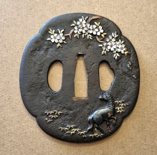

Tensho Posted December 26, 2024 Report Posted December 26, 2024 On 12/25/2024 at 1:00 AM, Brian said: Dan, Do me a favour please. Take a confirmed (modern copy is fine) cast tsuba, take a punch, and punch around the nakago ana heavily to deform the metal like many of these you post. Tell us if the metal deforms nicely and changes shape, or if it crumbles and bits fall off. For educational purpose I went ahead and did this for everyone to see. This was one blow with a pointed punch and framing hammer. For reference this tsuba came out of Japan in a lot with genuine tsuba. I knew it was cast as you can see the sekigane are cast with the tsuba. 4 3 2 Quote
Dan tsuba Posted December 26, 2024 Author Report Posted December 26, 2024 OMG Matt! Super cool! So what do you think the results show? I mean the tsuba looks like it could be hand forged, but evidently it isn't! Are you just a rebel like I am? Do you have any idea what your experimental test will show to others? Remember, you are messing with a multi-million dollar a year world business! So do you agree with my posts on this thread or not? You said the sekagane are cast with the tsuba. Did you mean the tagane-ato punch marks? I don't care! Just the fact that you did the experiment is great! Get ready for the downvotes! Thank you so much for taking the time to verify what I have been trying to tell others for almost 3 years! Onward! With respect, Dan 1 3 Quote
Steves87 Posted December 26, 2024 Report Posted December 26, 2024 Good experiment! You have definitely proved that the (mostly known) theory of tagane ato being added, will crack a cast Tsuba. However, we don't know when this Tsuba was made.... which I believe is the whole point of this thread. Is there a confirmed date for this Tsuba? I know it "looks old" but that doesn't mean it wasn't made in 1911. My father inlaw still has cast farm machinery components (used in orchard grading conveyors) made just after WW1 which look to have basically the same patina. Testing for the age of this Tsuba is the only way to prove anything for this thread... until then, we are basically still were we were on page 1. We know there are cast Tsuba, some will definitely be antiques in their own right now that we are almost in 2025... but were they made prior to the invasion of westerners, or were they made as a way of making money and producing them fast to keep up with western tourist demand? Or did the kettle makers whip a few out here and there... I would have, but different times, different cultures.... 3 2 Quote
Dan tsuba Posted December 26, 2024 Author Report Posted December 26, 2024 No! Tagane-ato could have been added with the cast iron tsuba annealed and re-heated. What Matt has shown is that a tsuba that appears to be hand forged is actually cast iron! And no, we don't know when the tsuba was made. Unless carbon dating is done, the flat-earthers will always be out there! My opinion! 1 2 Quote
Steves87 Posted December 27, 2024 Report Posted December 27, 2024 (edited) No, Dan, we knew the Tsuba was cast because of the cast top sekigane... that is why our bro did the test Edited December 27, 2024 by Steves87 Addwd 1 1 Quote
Tensho Posted December 27, 2024 Report Posted December 27, 2024 30 minutes ago, Steves87 said: Good experiment! You have definitely proved that the (mostly known) theory of tagane ato being added, will crack a cast Tsuba. However, we don't know when this Tsuba was made.... which I believe is the whole point of this thread. I posted this in response to Brian's comment. That yes, taking a punch to a cast iron tsuba will have negative effects. I haven't seen anyone attempt such things only speculation. And no, there's no way to know when this was made. 2 2 Quote
Dan tsuba Posted December 27, 2024 Author Report Posted December 27, 2024 I don't know! I can't see a cast sekigane in the pictures. All I see is tagane-ato. It doesn't matter. Matt has shown that a tsuba that appears to be hand forged is actually cast. What is the problem? We can debate age of the tsuba and no one will ever figure it out! This tsuba stuff is a mulit-million dollar a year world wide business! No one will admit anything for fear of disrupting the status quo! Let the downvotes continue! 3 Quote
Steves87 Posted December 27, 2024 Report Posted December 27, 2024 (edited) Dan, the problem is that we knew the Tsuba was cast, we knew the theory of adverse effects, we tested the adverse affects theory and proved it... but we have no idea when the Tsuba was made... I thought the whole aim is to prove cast Tsuba were made in the Edo period? We have no idea when this Tsuba was made, and it is quite literally stupid to assume it was made in the Edo period. This test does not contribute to that discussion (cast Tsuba made in the Edo) other than reinforcing a call for further testing... which we knew all along at the beginning of the thread. P.s. I can see a cast sekigane, and the owner can in hand too Edited December 27, 2024 by Steves87 Added 2 3 Quote

Brian Posted December 27, 2024 Report Posted December 27, 2024 Dan, you are missing the point entirely. This isn't proving your point...it's proving the opposite. That many of these tsuba you claim are cast, showing dubious "casting flaws" and tagane ato not cast into the tsuba, are NOT cast. And forget that whole "annealed and reheated" nonsense. If someone casts tsuba, it's to make them cheap and fast. Additional processes just add expense and time, and make it pointless. That tsuba was obviously cast. Thank you Matt for doing that, it is a huge help, well done. I suspect tsuba like that one were either made for display, cheap mounting or deliberate deception. They didn't take too much care cleaning up the insides of the sukashi, as that would have taken more time and expense, which goes against the point of cast tsuba. 3 6 1 1 Quote
