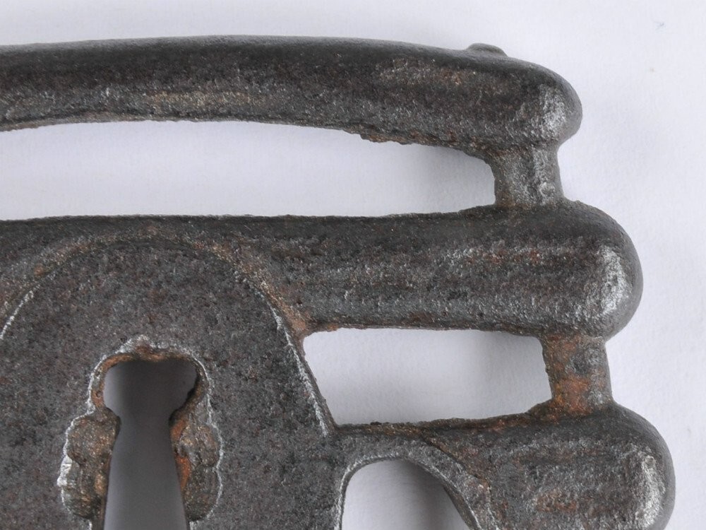

Hello all!
Well, I am back on this thread.  Why?  Because I have come across too much new good information on cast iron tsuba.  If I don’t post it now, I will forget about it!  Heck, I even forget where I sometimes leave my walking cane (that’s what happens when you’re old!).

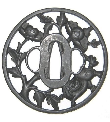

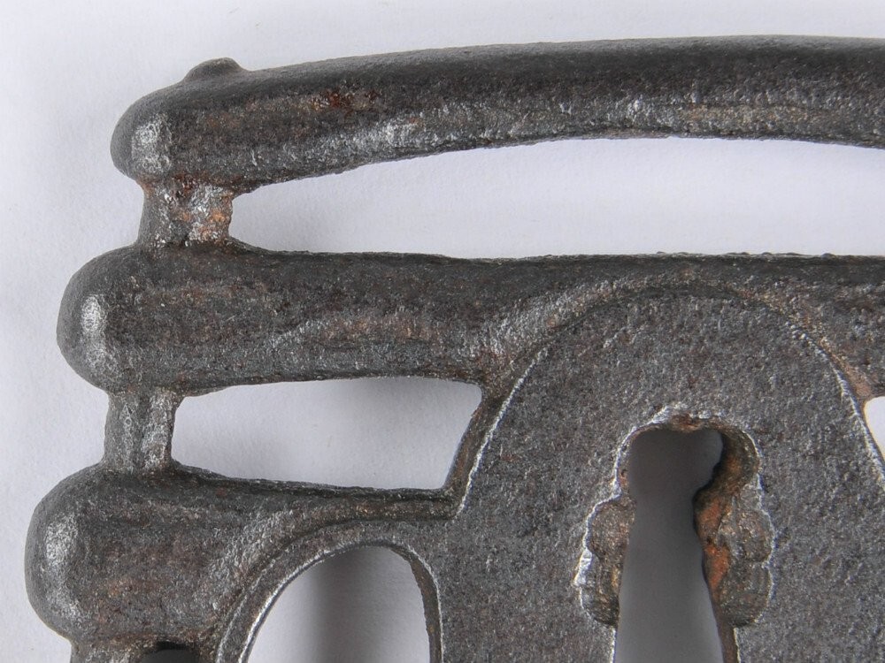

So, included are pictures (picture 1 and 2) that are of newly made cast iron tsuba cast by the lost wax method.
Notice the amazing amount of detail that can be achieved with that method!
As stated by the dealer, which can be found at this link-
https://www.jauce.com/auction/o1149602781
“I am selling an iron Japanese sword tsuba.
This product is from a workshop specializing in Japanese swords for Iaido in Seki City, Gifu Prefecture.
It will be a contemporary work.
The material is iron, and it is made using the lost wax method.
They are produced by casting using wax molds (commonly known as precision casting).”
Also, Dr. Lissenden in his master’s thesis on Namban tsuba describes the lost form (wax) method (found on p. 130) that may have been used in making Namban type tsuba.  His thesis can be found at this link-
https://etheses.dur....4129/1/4129_1648.pdf
So, moving on,

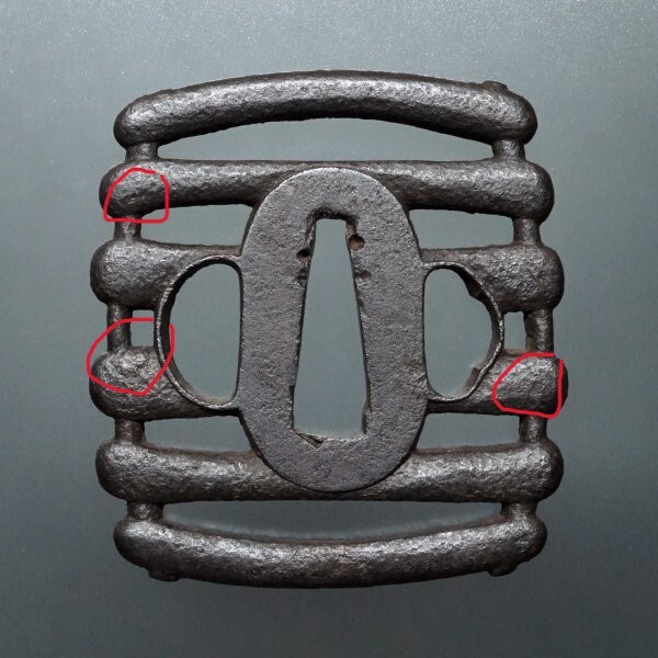

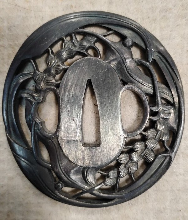

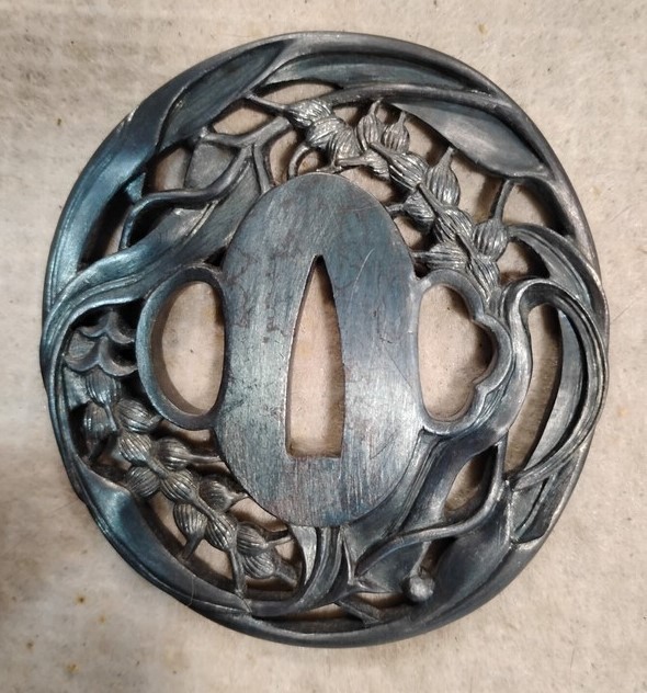

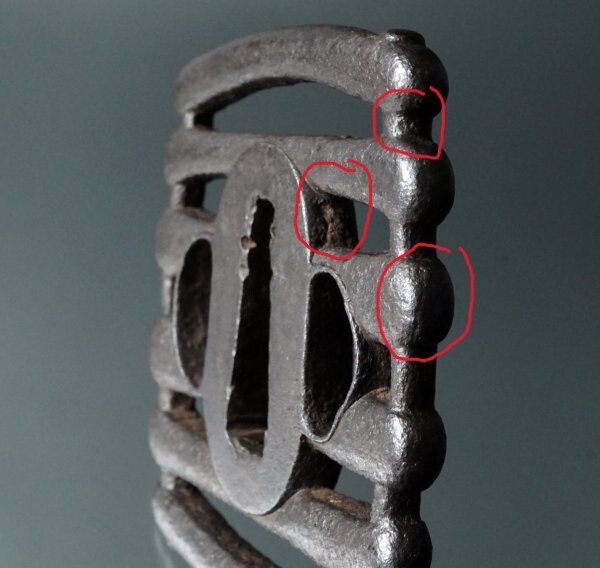

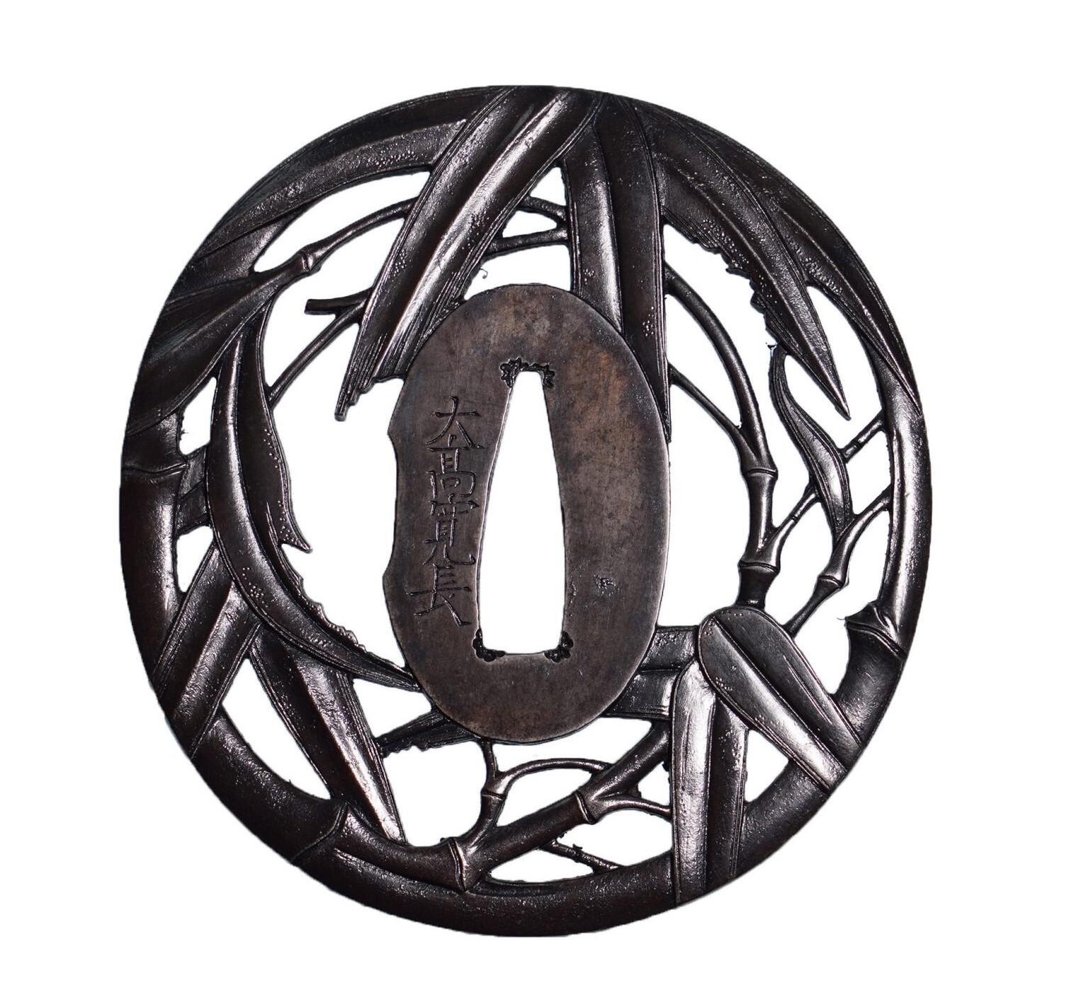

Pictures number 3.4.5, 6 and 7 show an NBTHK papered tsuba that could very possibly have been made from cast iron.
That tsuba was for sale at this link-
https://www.jauce.com/auction/m1160847457
Notice the unfiled casting flanges in some of the openings of the tsuba.
Also notice small casting flaws that can be seen, if you look carefully.
And notice that the nakago-ana is bottle shaped.
A feature that I have found on many cast iron tsuba.

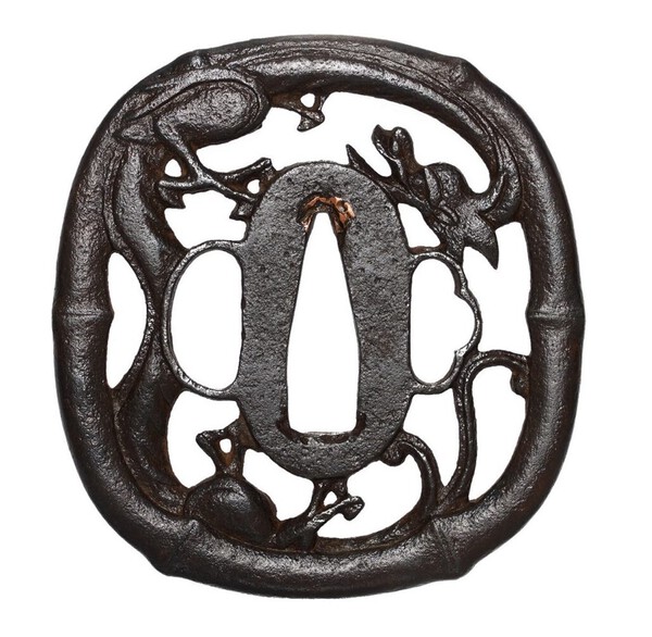

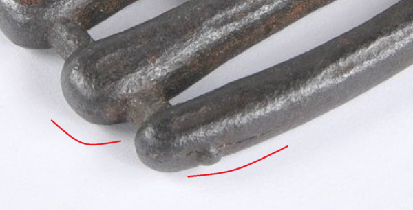

Also shown in pictures 8, 9 and 10 is another similar motif tsuba as the ones shown before.
It can be found at this link-
https://www.jauce.com/auction/r1148317429
It is an NBTHK papered tsuba, which I think is cast iron.
In these pictures I have circled (also in red) several (what I determine to be) casting flaws.
Anyway, just my opinions!
Onward!

Dan:
One important thing to understand is that lost wax mold making materials and methods have changed significantly in the last century or so, making iron casting (versus other metals) using lost wax much more likely currently that it would have been in the 19th century, or earlier.  I do believe that ultimately testing will show that sand casting was being used to produce some edo period tsuba - probably for the lower end of the market.  We know it was being used to produce other iron objects, so I'd be extremely surprised if it wasn't being done for tsuba. Oh for a time machine to go back to a "tsuba store" / sword seller in 1780!
But at the end of the day, I don't find the question as significant as many here.  If the casting and post casting clean-up and finishing has been so well done that you can't tell for sure whether it was cast, that's serious craft in its own right, trust me!  I just enjoy the objects on their merits... but I'm not a collector in the serious sense of the word - I'm just a dilettante who knows what he likes, as I proved with the recent piece I posted here... :-)
Thanks, Robert!
I understand what you stated in your previous post.
However, the question of whether or not an iron tsuba is cast or hand forged is an important aspect of the piece to many collectors (at least I think so!).
That is because it all comes down to the dollar bill in today’s tsuba market (my opinion).
A buyer may want to purchase a rather expensive tsuba that he believes is hand forged.
But what happens if he ever finds out that the expensive tsuba he purchased is actually cast iron (one day when a cheap non-invasive metallurgical test is developed to discern the difference between hand forged and cast iron – kind of a do it yourself at your home test!)
That is why I keep posting on this thread.  To try and show members that some Edo period tsuba may have been cast, and not hand forged.
Maybe looking at a tsuba for specific signs of possible casting (as I and others have shown pictures of possible cast iron Edo period tsuba on this thread) will help tsuba collectors question whether the piece is hand forged or possibly cast.
Onward!

I just can't help posting papered tsuba that appear that they were cast!
Below is a tsuba that is papered.
What do you think?
Cast iron or not?
I have circled the questionable areas in red that appear as casting flaws (maybe you can find other casting flaws?).
Would a hand forged and carved tusba have those flaws?
Onward!
  • Downvote 1
Expand
Hi Dan,
You just don't seem to get it that a real big part of the attraction of a hand forged piece of ironwork IS the flaws - the visual evidence of the artist's sweat and labor. Creativity and artistry born out of iron, fire and anvil.
Why do you think nobody collects wrought iron railings?
I do respect your interest in this field but it honestly feels like you're trying to ram it down everyone else's throats.
Just sayin'
Dee
  • Downvote 1
