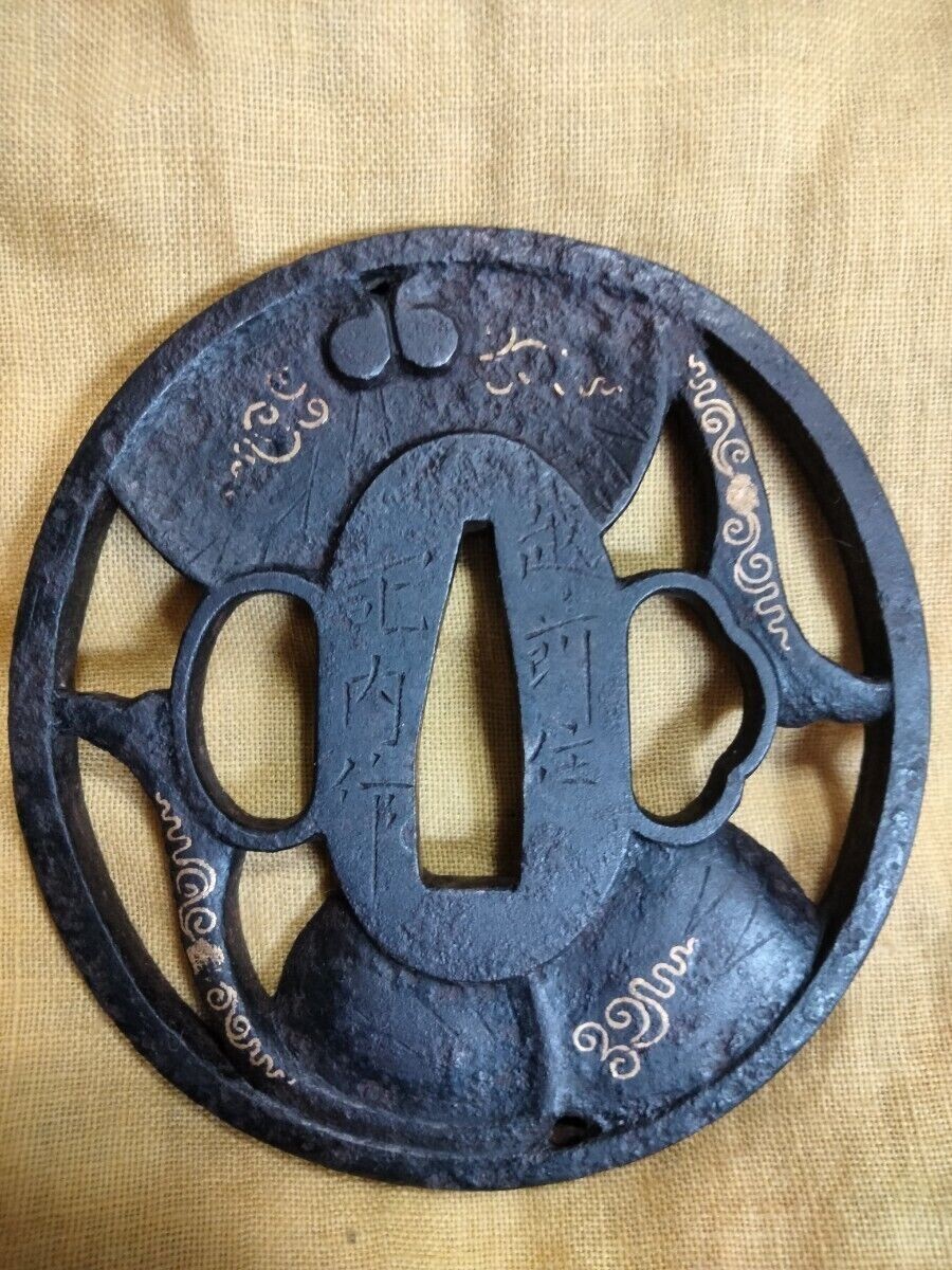

Dan tsuba Posted January 28, 2024 Author Report Posted January 28, 2024 Hello all! So, referring to a water kettle with a tsuba that I posted on October 15, 2023 (some pictures below). Obviously that tsuba is made from cast iron. Whether cast in the Edo period or not is impossible to determine. Probably the only way to deterimie if it was actually cast would be to subject it to non-invasive metallurgical testing. I purchased a similar tsuba that was pictured on that water kettle a couple of weeks ago (pictures also attached). That tsuba has a mei. There are a plethora of these similar motif tsuba being sold on various purchase sites. How is it possible to determine a hand forged from a cast iron one of these? I know that a mei can be “faked”, the tsuba could have been made after the Edo period and a “fake” mei from the Edo period added to that tsuba. Or the tsuba could have been made in the Edo period with no mei, and a “fake” mei added later. Or the tsuba and the mei can reflect the actual maker of the tsuba in the Edo period. Without taking a hammer to the piece and seeing if it is brittle and breaks (cast iron), how does anyone determine such things? I even have discovered that if a tsuba like this is papered by the NBTHK, it still can be very misleading. I have found that the old green papers can be incorrect and themselves could have been forged! Are we all just “floundering” around when it comes to the more inexpensive type of iron tsuba and just must take our chances? Who is right in their determination if a tsuba is hand forged and not cast? Who is wrong? I mean can a description of a tsuba being listed by a reputable seller be wrong? I know, maybe I am just overthinking this thing. But how can tsuba collectors be certain of anything with so many variables that turn up and present themselves? I mean is it possible that knowledgeable people could be incorrect in their determination? I have even heard were the NBTHK could make mistakes! Always with respect, Dan 1 Quote

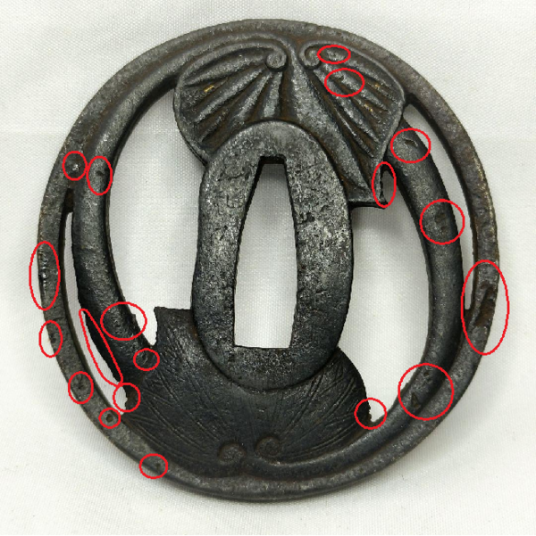

Spartancrest Posted February 2, 2024 Report Posted February 2, 2024 Ebay one has some rather jagged casting spurs in the sukashi and numerous 'holes/ bubbles'. It is pretty likely all three examples are 'bad', the museum image has been enhanced. It may have been mounted. image from museum [why do museums often take such poor images] 1 Quote

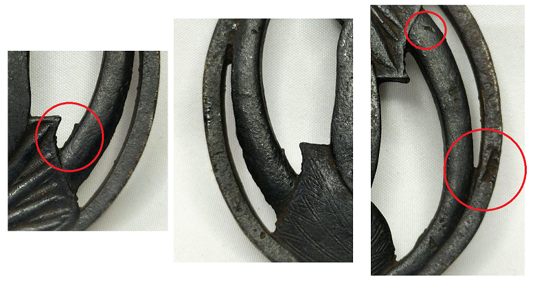

DoTanuki yokai Posted February 4, 2024 Report Posted February 4, 2024 Dale i thought the "jagged casting" parts in the ebay Tsuba could also be the result of delaminations in the iron of the tsuba. I think the picture is not good enough to be sure Quote
ROKUJURO Posted February 4, 2024 Report Posted February 4, 2024 Chris, I have never seen material coming out of delaminations except possibly corrosion. 2 Quote
Spartancrest Posted February 4, 2024 Report Posted February 4, 2024 Far too many faults to have been intentionally carved this way. Have a close look at the site images https://www.ebay.com.au/itm/315125444580 also the seppa-dai has the remains of an obliterated signature. No sign that it was ever mounted and I doubt very much it would stand up to a tagane-ato punch without breaking. Compare to these https://www.Japanese...echizen-kinai-tsuba/ and https://www.ebay.co.uk/itm/315129324245 not perfect by any means but far better than the one pictured. We all realise that the Kinai school churned these out in the hundreds but some were churned out with no real quality control. 2 Quote
DoTanuki yokai Posted February 4, 2024 Report Posted February 4, 2024 On 2/4/2024 at 10:20 AM, ROKUJURO said: Chris, I have never seen material coming out of delaminations except possibly corrosion. Expand At least the big one in the rim looked for me like someone put a screwdriver into a gap I think you guys will be right but I always think they had a lot of time to take damage from various sources. 2 Quote

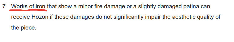

Dan tsuba Posted February 12, 2024 Author Report Posted February 12, 2024 Hello all, So here is something of interest that I was advised by a friend to look at. It is the “Shinsa Standards: (amended by May 19, 2015)" and can be downloaded from the below weblink- https://nbthk-ab2.org/shinsa-standards/ The area under “Tosogu (Fittings) Hozon Tosogu” is of particular interest since it mentions cast fittings! The several numbered areas of that particular area of the article need to be read. Now, I interpret what was stated as cast iron, cast copper, and cast bronze tosogu! The adventure continues! With respect, Dan Quote
Iekatsu Posted February 18, 2024 Report Posted February 18, 2024 Hello Dan, There is no mention of cast iron in the above standards, it is well established that there are cast bronze Tsuba that pre-date the Meiji period and that they pass for papers at all levels. 2 Quote
Spartancrest Posted February 18, 2024 Report Posted February 18, 2024 Perhaps the Shinsa assessment needs a bit of an update and clarification? - It does not specifically say what castings or what they are cast in - ambiguous and a little misleading. [If you are spending big money on an assessment wouldn't you like to know that at least it will be assessed?] It might well be that cast kinko tsuba are "well established" and pre-date the Meiji period - the question still remains can we pre-date cast iron to the Edo period. [Certainly we have ample evidence of them from the Meiji period .] 1 Quote
ROKUJURO Posted February 18, 2024 Report Posted February 18, 2024 As far as I know, different copper alloys, including brass, were used to pre-cast TSUBA blanks for the manufacture of KINKO TSUBA, but bronze is not mentioned. 1 Quote
Dan tsuba Posted February 19, 2024 Author Report Posted February 19, 2024 Hello Tony. So, what exactly are you inferring by underlining “Works of iron” in the Shinsa Standards? Are you equating “works of iron” with only hand forged tsuba? If I am incorrect in what I think you stated I apologize, but I will go on. Some posts in this thread explain how cast iron could be re-heated, softened and hand worked. So, cast iron could be a “work of iron”. Have you read the entire thread? I have spent over 2 years on this thread and I am no longer interested in doing more research. I know that I (and a few other members) have provided enough research, evidence, and proof to show that cast iron tsuba were made in the Edo period. With respect, Dan Quote
Iekatsu Posted February 20, 2024 Report Posted February 20, 2024 Jean, Bronze is used in Kagamishi tsuba. Dan, You have not provided suffcient evidence to convince most people following this thread. The hunt continues. 6 Quote
