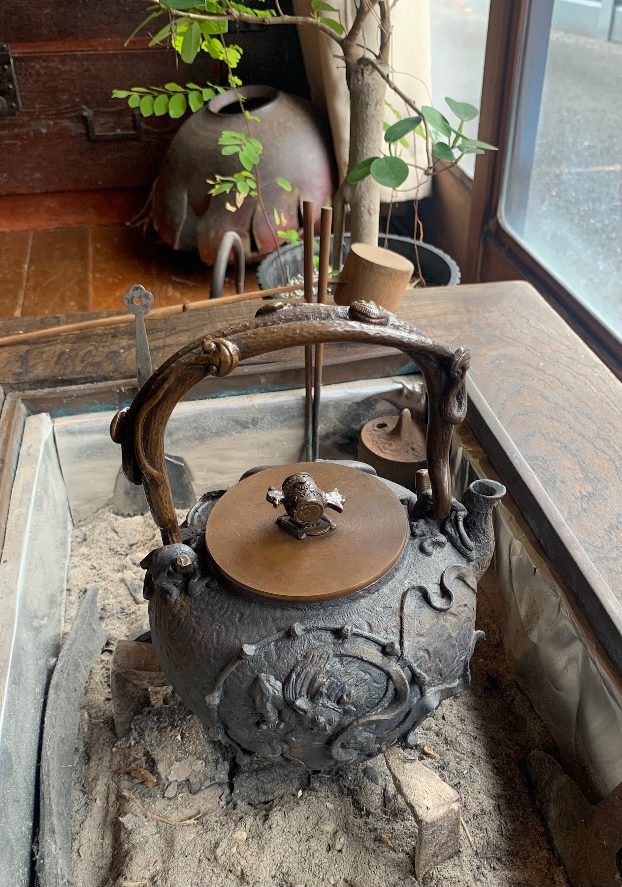

Bugyotsuji Posted December 4, 2022 Report Share Posted December 4, 2022 In conclusion to a wonderfully educational thread, and for decorative effect… cast in iron and copper, 2 3 Quote Link to comment Share on other sites More sharing options...
