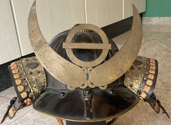

LuckyLuudje Posted January 23, 2022 Report Posted January 23, 2022 Hello all, This is my first post here and I hope it is in the right section, so please be gentle with me. I am collecting WW2 medals and ancient coins for 30 years but the last few years I bought some Japanese antiques, just because I like old Japanese items. I also have a katana, yari, kake, musha ningyo and a wakizashi. I don't want to start a new collection so I only want to collect one of each. My interest is mainly the history behind it not really rare makers or variants. Here I post my Kabuto, The seller said that the family he got it from stated that it has been worn during the fall of Odaware Castle. So if this is true ,that would mean that it must have been made before 1590. I searched online for the "mon" and found nothing and got lost, so I would appreciate your help. My question is about the "mon" and the period of making. Any other comments are also appreciated. Best Regards, Lucky 2 Quote

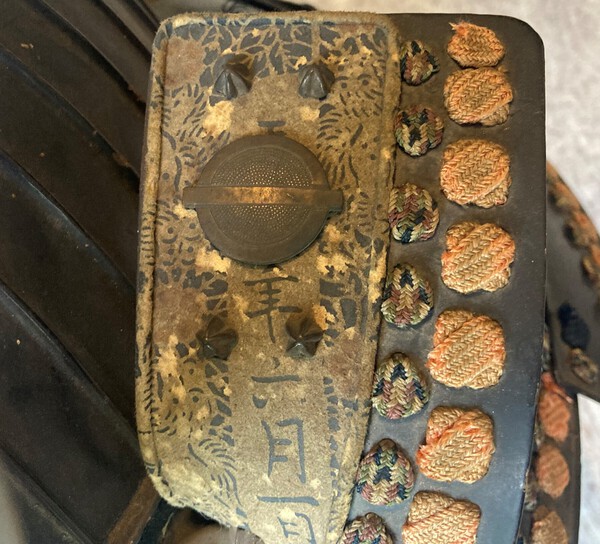

LuckyLuudje Posted January 23, 2022 Author Report Posted January 23, 2022 And here is the last picture Quote
YOJIMBO Posted January 23, 2022 Report Posted January 23, 2022 MON is irrelevant, you can put whatever you want there. But the "story" sells Quote
Shogun8 Posted January 23, 2022 Report Posted January 23, 2022 Hi Lucky, Welcome to the wonderful rabbit hole that we call armour collecting! Nice kabuto! It seems that the ukebari (the cloth liner) is detached near the front of the kabuto. If so, are you able to peel it back and take a picture of the interior construction? That would help with an approximate dating of your kabuto. I will leave it to other members like Uwe or Piers to comment on the mon. John 1 Quote

SteveM Posted January 23, 2022 Report Posted January 23, 2022 The mon is called maru ni de hitotsu hiki (丸に出一つ引き)which, as you can imagine, means "one line protruding from circle". I have no information regarding who may have used this mon. Here is a link for your further research. https://irohakamon.com/kamon/hikiryou/marunidehitotsuhiki.html Regarding the date, the writing in your second picture is a date. It may not be the date of the manufacture of th helmet, but it will be a data point. The first part is the era name, but it is covered by the mon. The part we can read says "June 1st". The era name might be Shōhō 正保 (1645-1648). Could also be Shōchō 正長 (1428-1429) but I think that's unlikely. 2 Quote
uwe Posted January 23, 2022 Report Posted January 23, 2022 Hello and welcome Lucky! I love the first sentence of Johns post...!!! Nice helmet and a nice gusoku over and above that! Yes, the kabuto might have some age, but more on that later. The mon on the fukigaeshi could be described as "Maru ni de hitotsu biki" ("丸に出一つ引き", or literally, protruding bar in a ring ) I guess!? I found only a few references, "鮒子田" (Fushita), "田畑" (Tabata) and "大山" (Oyama). Unfortunately, thats only half of the truth. On the one hand we have no chronological assignment, on the other hand we still have these two choji on the maedate. Furthermore and unfortunately, Simon is not totally wrong.....there is a possibillity, that these are later additions. So a lot of study and work left to do... Note: Some of the names could have several readings! 3 Quote

uwe Posted January 23, 2022 Report Posted January 23, 2022 On 1/23/2022 at 3:32 PM, SteveM said: The mon is called maru ni de hitotsu hiki (丸に出一つ引き)which, as you can imagine, means "one line protruding from circle". I have no information regarding who may have used this mon. Here is a link for your further research. https://irohakamon.com/kamon/hikiryou/marunidehitotsuhiki.html Regarding the date, the writing in your second picture is a date. It may not be the date of the manufacture of th helmet, but it will be a data point. The first part is the era name, but it is covered by the mon. The part we can read says "June 1st". The era name might be Shōhō 正保 (1645-1648). Could also be Shōchō 正長 (1428-1429) but I think that's unlikely. Expand Hi Seve, the leather is called "Shôhei gawa" and the date printed on it, is the date of its first introduction in 1352, if I remember well. Hence no connection to the piece.. 3 2 Quote
uwe Posted January 23, 2022 Report Posted January 23, 2022 Ok, to be exact: "正平六年六月一日" (1351) 1 Quote
